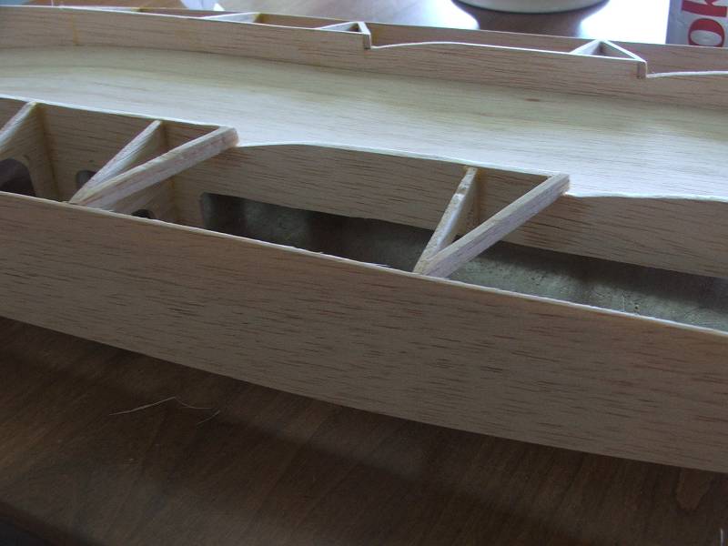

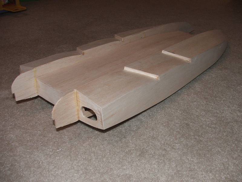

More progress on the balsa barge. First picture shows the sides after sanding down to the supports. I then used a template from the origninal stringers to cut the steps into the outside. A little more sanding and then glued the bottoms in place, more sanding. You get the idea. I'm real happy with it so far. THings will slow down as now I have to do the nose on the tunnel and the rear and I'm not sure how I'm going to do it. So more thinking. Starting to look like a boat now.

Scott, it's looking excellent so far.
Ryan

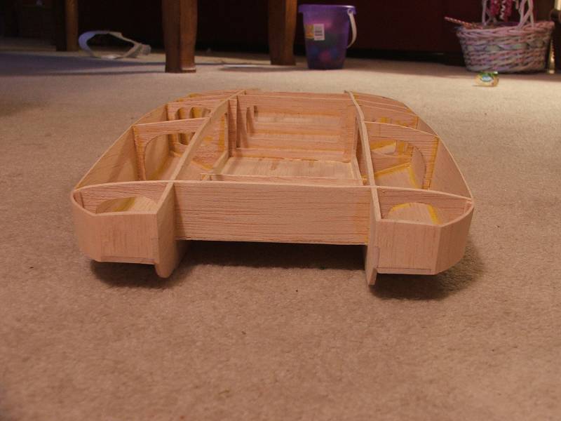

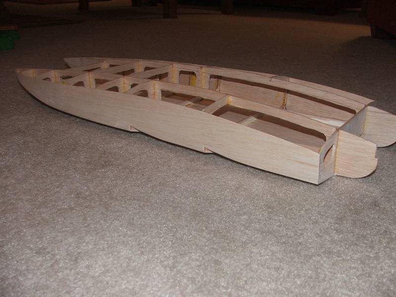

Update: Have finished the transom. I will likley modify the vertical radii that are on the back of the stringers. These are different than either of the similar boats that I have seen including the finished product of the original designer, and I'm not sure of their intended purpose. I pretty much designed these as I went. (made one, liked it and duplicated it). I'm very happy with how it came out. I need to finish the nose on the tunnel and then things will really pick up.

did you soak the rear pieces where it takes the bend?
its balsa so i don't think you really need too. nevermind LOL

Taylor,
No I didn't soak but that's a good question. That's partially why I added the flat area because I didn't think I could make the bend without it. The flat area made for a larger radius and less bend. I did some test bends to try to make the full radius that ended in a "pop". With this design I did it (bending with the grain) with no problem. I may run in to problems later as I plan on "armoring" the whole boat with 1/64 ply. I don't know how that bends but I assume not as good as balsa. So if you soak it, just water? Then you bend and hold and let dry before you instal? I'm learning stuff every day here.
