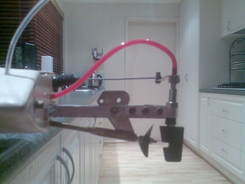

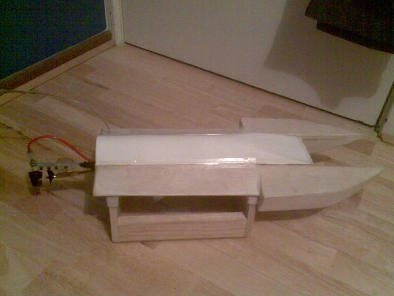

ok so i just finished building this 20inch hydro, 25 including strut and hardware, and anyway... i think its cavitating![:@]
my hardware is inline and its running a sv27 brushless motor on 12 cells, with just a 2 blade prop that a guy down the hobbie store reckomended, it had no tag or information, but honestly i think its a nitro hammer prop!!!
the prop sits about 2 inchs under the water from center shaft to water line when just sitting there, but as soon as i take off even slowly, it starts to catch air or cavitates or something like that, its more like its sucking the air in from above it. and its not a flex shaft so i cant just angle it more.
the prop is 31mm in diameter, plastic, and like i said its a 2 blade.
i dont no how to fix this problem, i think its cavitaion because its not peircing the surface but i know theres more to cavitation than that.
i was thinking maybe a 3 blade prop or a bigger 2blade or something??
ill pop a pic up alittle bit later if you need 2 hav alook at the hardware and where its positioned.
if anyone has any input at all, any questions about the boat that they need to know to help me out, just fire away!

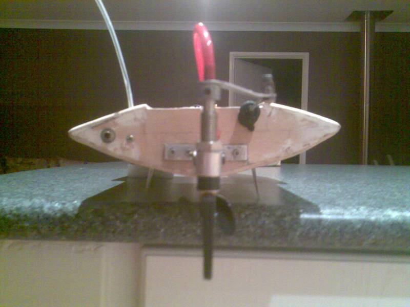

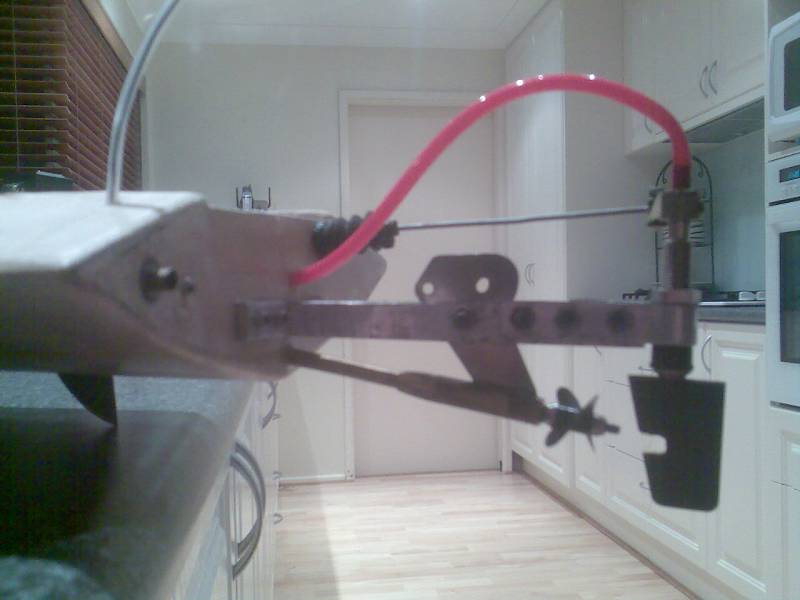

ORIGINAL: SV27dayton
Could you post a picture of the boat directly from behind, level with the bottom, with the prop in question installed?
here is some pics. (i think) sorry 1st time for posting pics
i hope these can give you an idea, there not the best pics as there just from my fone.
the waterline (when sitting still) sits just above the gold water outlet tube you can see on the left of the transom.
oh and yes that is the prop in question that i was talking about.
thanks,
Corey
Your hull is set up wrong. On a hydro hull, the prop shaft must exit under the hull and the prop center line should be below the rear of the hull. Then a lifter type prop is used.
Ryan
Ryan

Well your setup is unusual but I think it can at least be made to work . This is after-all a learning experience.
A 1/8" shaft can be dealt with,even with this much power. I have run several 12 cell and 700 powered hydros using 1/8" shafts adapted up to 3/16". The real problem for you is your scources for props. As you now know not just anything will do. I have a Octura Y534 that will fit right on a 1/8" shaft and may work. Its still plastic but a good performer and very cheap. The shaft can be adapted up for 3/16" props . That will give you a good selection of props to try. If you local shop does not have many props suitable then you may have to send for them. This is something most of us have to do. n.h.schmidt

I think you are seeing hesitation from people telling you how to spend your money b/c they honestly don't know. That's an unusual setup. Nobody can say what will work for shure form experience, certainly myself included.
Joined: May 2007
Posts: 297
From: North Shore City, NEW ZEALAND
That is an interesting build you have there. Not a bad comment as I have two home-brew hydros undergoing development at the moment.
Your thrust angle is a quite aggressive therefore will lift the rear regardless of the type of prop, however a lifting prop will increase the effect.
A 1/8" shaft is fine to work with for a wide variety of props. You can use 3/16"octuras with a sleeve of 7/32" K&S tubing, I do !!
I do not know what rpm you are developing on the bench, but I get close to 25,000 rpm and use a octura 534 on my 20" prototype hydro with a solid shaft similar to yours.
If you have wads of rpm on hand go for a small prop and work steadily upwards. Keep a diary of changes.
I run for 30 - 60 seconds on a prop then swap to monitor changes. Given the cells I use I get 2 or 3 swaps per charge, once they are off the peak then i just run the boat for a nother min or two before breaking out the CAT and bigger mono.
Summary. Small prop to begin with, I suggest a 534 ( plastic ) and go from there.

I can get real specific if you like. I don''t want to get you spending a Bunch of cash to get something to work. You can''t go wrong with the Octura Y534. This was mentioned twice now. It should work and cost little. You can also give a Graupner CF K42 a try . Get the one that uses a 3/16" shaft. All the metal props could cost you $30 USD''s or more each. You are starting from nothing so you need everything. The problem for you is where to order from? n.h.schmidt
