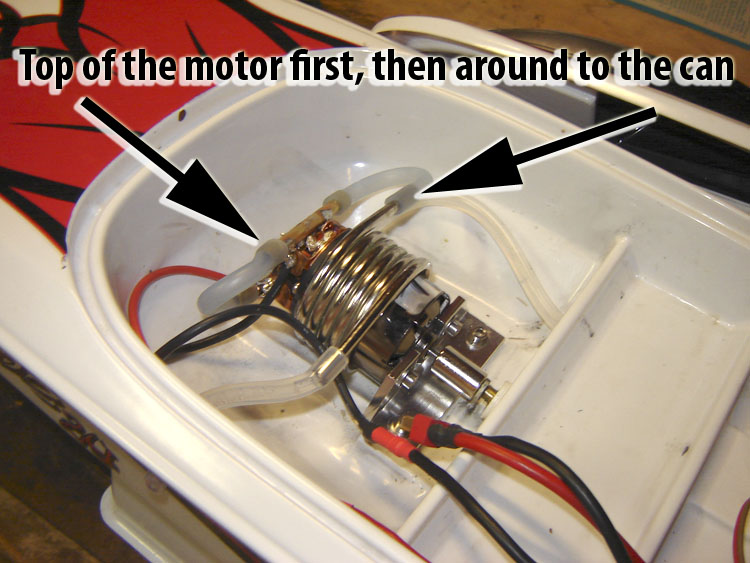

also, you absolutely NEED brush cooling on that motor. 8 cells on a 19t?!?!
Do like this:
http://www.offshoreelectrics.com/inf...cool-motor.php
Motor heat is generated by the brushes, so naturally, that should be the part of the motor that is cooled.

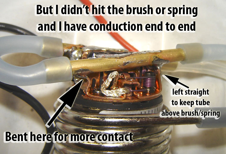

if you use a clothes pin that's trimmed down a little, it will help hole the tube to the brush hood, allowing you to focus on soldering it.
Make sure you don't mess up the spring holders.

when cooling your motor, if you want the ultimate in cooling, i'd run two separate pickups, one for just the brushes, and another for the can and esc.

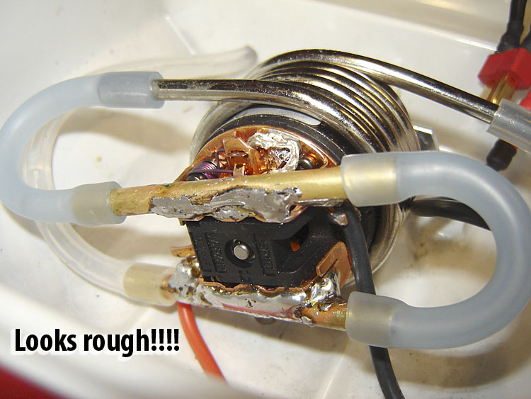

Well, I went ahead and cooled the end of the motor and lubed everything else real nice. It may not be pretty but I think it will work very well. There is alot of extra solder to fill the joints but I figure it conducts heat a lot better than air so slop it on in. I am ashamed to say the drive shaft was definately in need of lube, but at least it wasn't "start the boat on fire" dry. It is considerably quieter now 1983shovelhead, thanks for the lube, you are the man. Thanks to everyone for your suggestions, and I will post a video of the result on Sat (with 1983shovelhead's help).

Hey flyfloater, that boat looks awsome! I would remove the sticker off of the motor so that you have metal to metal to make the cooling coil more effective.
