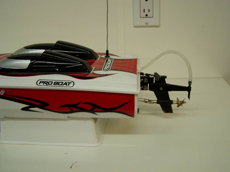

Glad to see this thread take off a bit. I am also working on speedin up an apache 24. So far I put in a Trinity 19 turn motor and built a 8 cell nicad pack for it and switched it to deans connectors. Total cost of upgrades is $35 for the motor, the battery's were a good freinds leftover loose cells. With the 8 cell pack the boat almost flips backwards when you hit the throttle from a stop. Lots of fun for my small pond, I don't think I need to go brushless but I will admit to having the itch. I just really need to know what prop to put in it, it is running way way too hot. Oh, to get the battery in with the two extra cells (twin turbo ;-) just cut the bottom layer of platic out of the hatch below the cockpit areas. See pics. Oh, and the battery is my first attempt but I had a great time doing it. I can't wait to build more.
Joined: Jun 2008
Posts: 67
From: , OH
Just the stock prop in the pic. I think the prop is my missing link, I just can't figure out what to get. I know it isn't a 3/16 drive but I am not sure if it is 1/8 or 3 or 4 mm???? I need to buy a decent caliper. I would like to go with a real polished prop but I don't want to waste the money going to small or large. Right now I am overheating but I don't want to waste $35 on a smaller prop just winging it and end up making foam.
Joined: Jun 2008
Posts: 67
From: , OH
Everything is getting too hot. I am not sure of the temps but it was enough to melt the wires off my motor. Anything more than a 60 second run just gets me way too hot.
