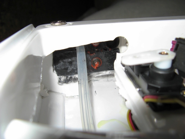

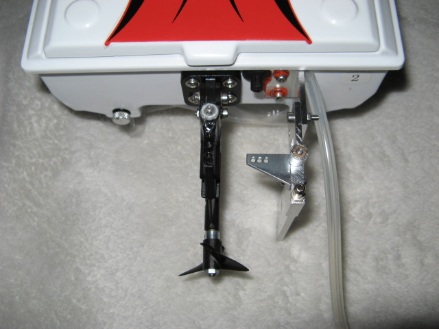

shenlonco's Avatar
Joined: May 2004
Posts: 4,722
Received 14 Likes on 14 Posts
From: prospect park, NJ
Default RE: PROBOAT APACHE 24
Her's mine!
Flex cable routed through stock rudder that's fixed in place and then added a pro boat turn rudder put a extra section of plastic behind the back of the hull wall to make the rear stronger... One thing now i am wondering if i should cut off the fin as show in the photo?...Or will this fin make it more stable in the turns?
