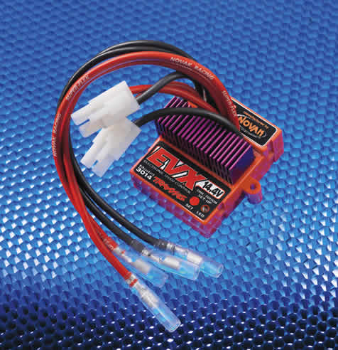

the traxxas e-maxx setup

The EVX you're looking at comes in a waterproof version too - it's pretty much the villian setup if I'm not mistaken.
I really don't think you're going to push this size hull with these motors.

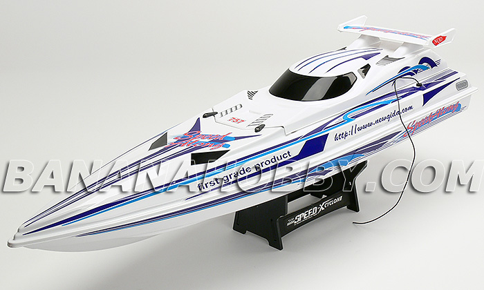

could I run the e-maxx setup in this hull it 36'' but stock it only has 380 type motors and its kinda fast so two 550 motors would make a lot faster.

A 36" mono would be an E3 setup. This means 6 cell LiPo. A motor that would be used for example is a NEU 1521 or 1527
2 380 motors is not close to fast in this hull. It will be a dog! 550 motors would not do much better.
What kind of performance are you looking for? What is your goal here?
