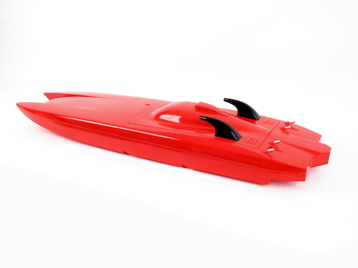

Hi Gentlemen
Although I’m in gas models long time I go, I would like to try electric boat after a saw some clips in www.e.powerboat.de but my experience about electric boats is zero and I don’t know what could be better mono or cat hull, which motor. ESC are good ect… . I’m looking for 110cm length with fast motor ( really fast) . my budget is 2000 $. During searching I found the attached hull ( 110 cm ) which made by RCMK.... I think this could be a good boat if right hardware, motor ect… installed . I’m living in France and I can order from Europe or USA.
Please any advice will highly appreciated.

A 43" hull is quite the jump in to FE boating when one does not have any experience. If you still wish to go ahead with it here are a few of the big dollar items to push such a large hull.
4 of these wired for 8s2p http://www3.towerhobbies.com/cgi-bin...?&I=LXRWB0&P=7
1 of these http://www3.towerhobbies.com/cgi-bin...?&I=LXTJH7&P=7
1 of the 1.5Y motor http://www.offshoreelectrics.com/pro...?prod=neu-2215
That should get you around 60mph.

Thanks Ryan for your advise and for the liks your sent me specially www.offshoreelectrics.com .
I believe my budget could fit for hull, hardware, motor and ESC but the most expressive item will be batteries do you think the http://www.offshoreelectrics.com/pro...rod=df-delta41 and http://www.offshoreelectrics.com/pro...?prod=TP-Jolly will need same motor and batteries ?
