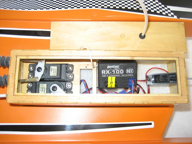

heres my set up i had a quick run today (very windy) and the new head and carby runs well. it uses twice as much fuel as the k&b black carby but i was quite surprised.[X(][X(]

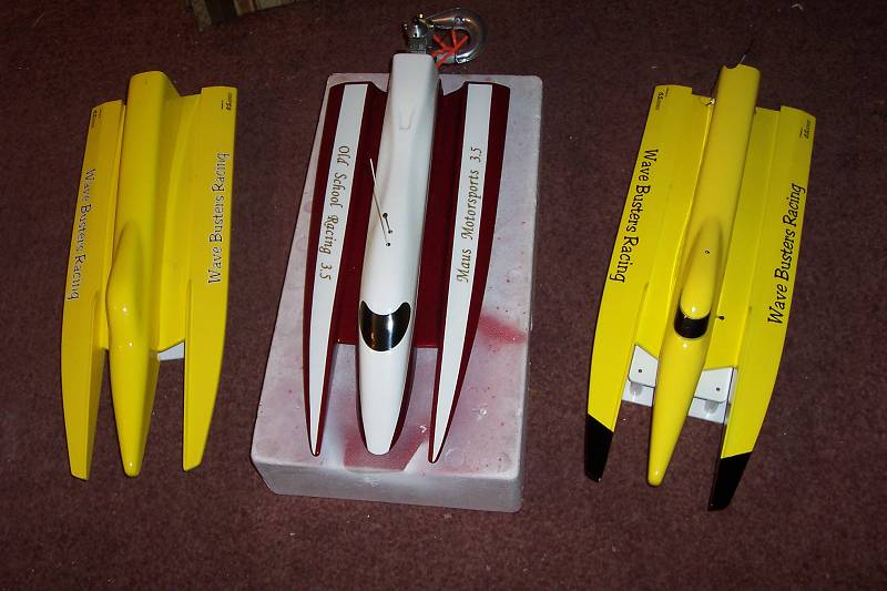

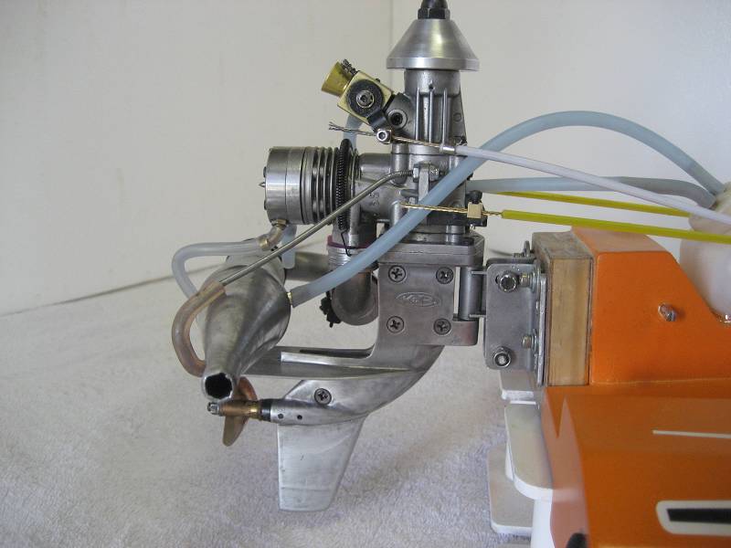

Hey all I just wanted to share my lasted addition to my fleet. I came across a TS2 for sale comeplete and should get it sometime next week. K&B 3.5 with tuned pipe and a gold carb. from the pictures it appears to have had a set-back plate added but I have not seen the bottom to see if it has any stumble pads. any condensed list of tweeks would be helpful. I ran some tunnels in the late 70s early 80s so I am excited about tuning in a tunnel boat again. seems like they have come a long way over the years. I have attatched some photos.
Kelly

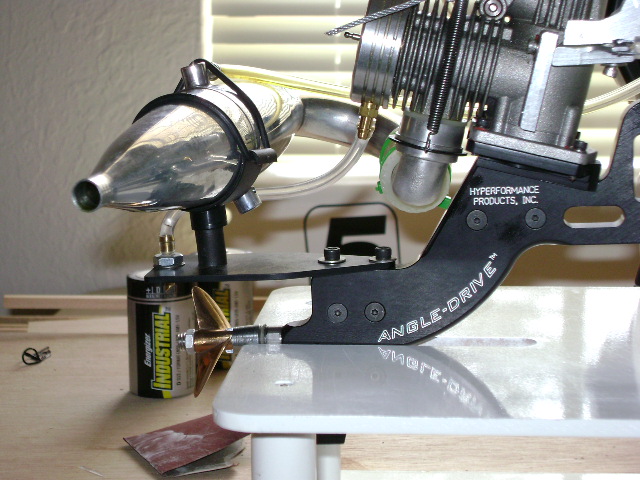

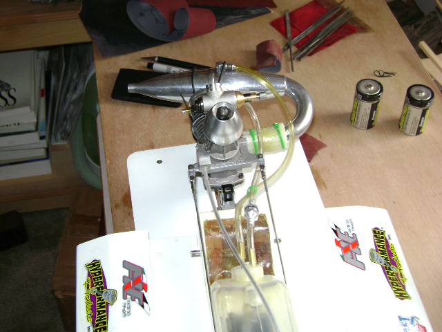

Need a little advice here. I finally got to test my TS2 this weekend. Got it started and the first thing I did was walk to the waters edge and as gracefully as I could I tossed it in upside down, the prop never got wet. I just stood there….Then it started snowing….Once we retrieved it to my surprise the radio box was dry no damage here.
Ok, the problem I noticed was the boat, when upright, list to the right not much but it does have a list. I used two d cell batteries and checked the balance left to right. The boat would balance if you turned the engine a little to the left. However, when on center the boat listed to the right. The engine is centered on the transom and the boat is balanced at about the 93/4†mark. I used steel fishing weights mixed with epoxy poured into the nose of the cowling. I never really ran the boat other than just past planning speeds as I’m still trying to break it in: however, it ran very well and when on plan it ran straight and true. I have a bit of negative trim and the prop shaft sits just above center line on the set up board. All in all everyone was quite impressed with it by the days end. My question is will this boat list a little in the direction of the tuned pipe or is something off? Thanks Chad.

Prop torque can cause the running condition you have described. Also, once the engine gets more time on it and you can lean it down, it's possible the "right lean" may go away. What prop are you running?

Jerry when the boat runs it goes exactly where you point it and shows no adverse effects of the list. I have a bit of negative trim on it while breaking it in so it does ride wet and even plowed the nose a bit turning in both directions. However, if you saw it run or were to drive it you would never know the list was there. It’s only noticeable when the boat is dead in the water. The prop is a thinned, sharpened, and balanced x440 two blade. I’m working on a three as we speak. No modifications on the blade shape as of yet. Chad.
