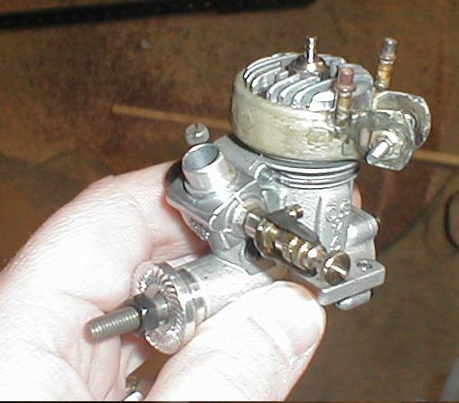

There used to be something available called a cool clamp...but I think it was spelled wrong...Kool Klamp?? Kool clamp??...something like that.
Anyhow, it was a small jacket that wrapped around the head of an aircraft engine that allowed cooling water to cool the engine. I used one on my small rigger for awhile...using an OS .10 FSR aircraft engine in it.
I don't see why the coils would not work, but I don't think they will have the contact area of the kool clamp (see pic).

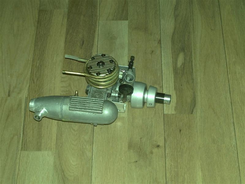

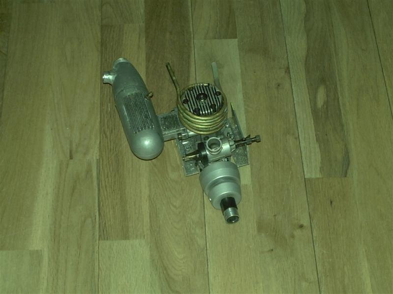

rob i used a.60 sc aero engine on my boat 3 ft long and it did 30 pluss submerged drive i got the flywheel to match and water cooled it using coils.pm me if your interested as its doing nothing right now!!.this engine will give you good speed for your boat as is if you went surface drive id say 40 pluss easy.it starts easy using a plane starter and v belt.just needs the plug loosening to start it as it has high compression then tighten back up when its running and off she goes.

john i was talking about my sc.60 engine not his 20 pluss engine!!
