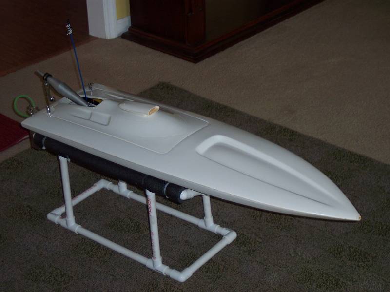

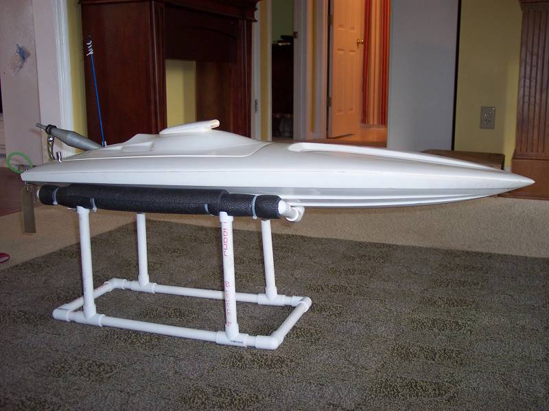

thanks for the info guys, here are some pics of this hull with all the tc 31 stuff. the hull came with body pins for the hatch, so i changed them out for some valve stems and som piston looking valve stem caps, you can also get the ones at autozone that flash[X(]

The hatch on that boat came with the scoop?
if so..
think you could measure the hatch, width and Length please
i've got a Delta Force 33 hull, and would like to add a scoop or buy a different hatch
if so..
