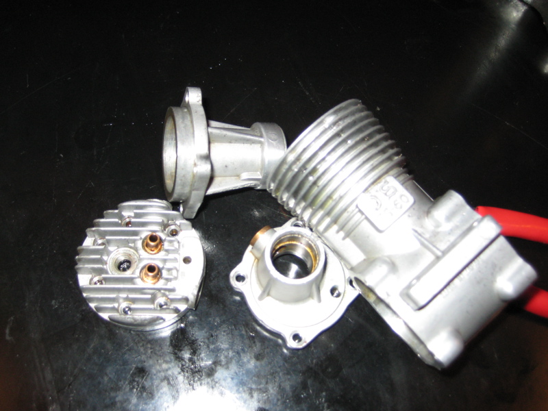

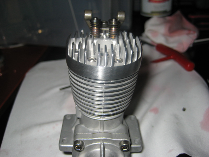

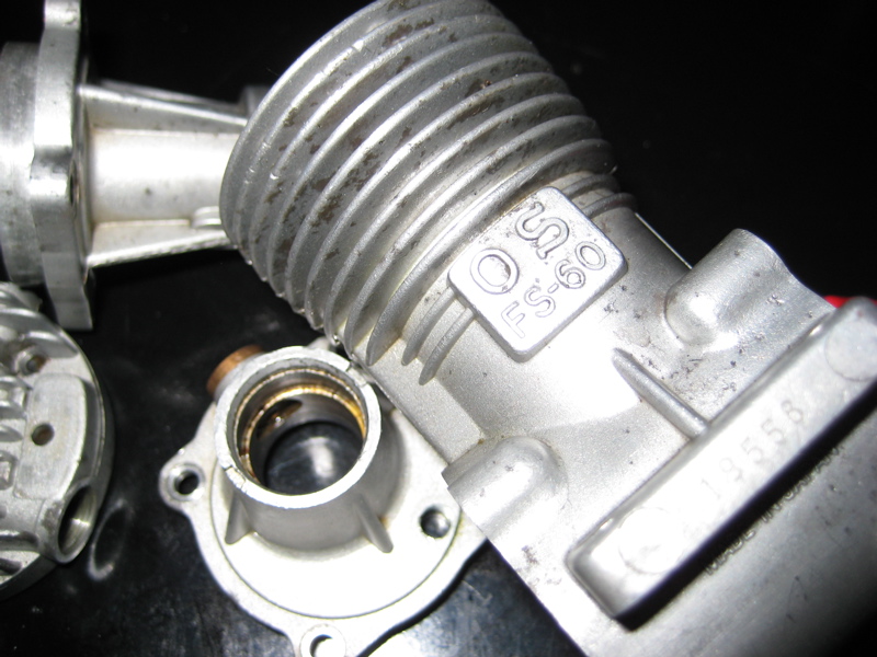

well, the boredom bug set in, i got the wild hair to build a wood boat, powered by an oldschool os fs-60 open rocker engine. i love four strokes, what better way to enjoy one than building a boat for one! so, i have never built a wooden kit before, so there may be some questions coming your way from this newb. on recommendation from members here, i am choosing the sk daddle, .40 size, for the hull on this project......
since i haven't bought the boat kit yet, i though i might as well pull out the old fs, and see if we couldn't clean her up, and get her ready for her new life as a boat motor. it has only been on a stand up until now. (it has run, but is/was in pieces, so this is a detailing/assembly type of thread.....)
here is the basis for this build, and old open rocker os, the bearings/ring is in good shape, but cosmetically, it has seen better days........

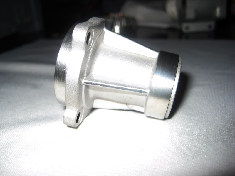

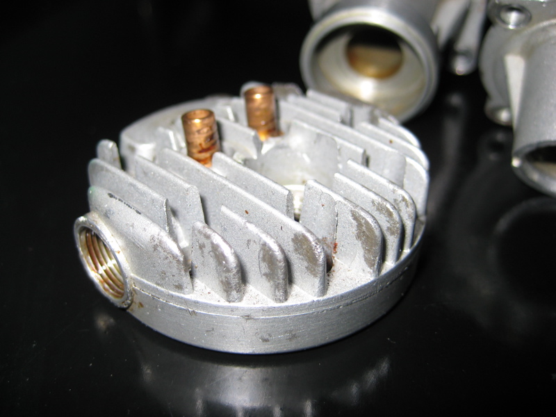

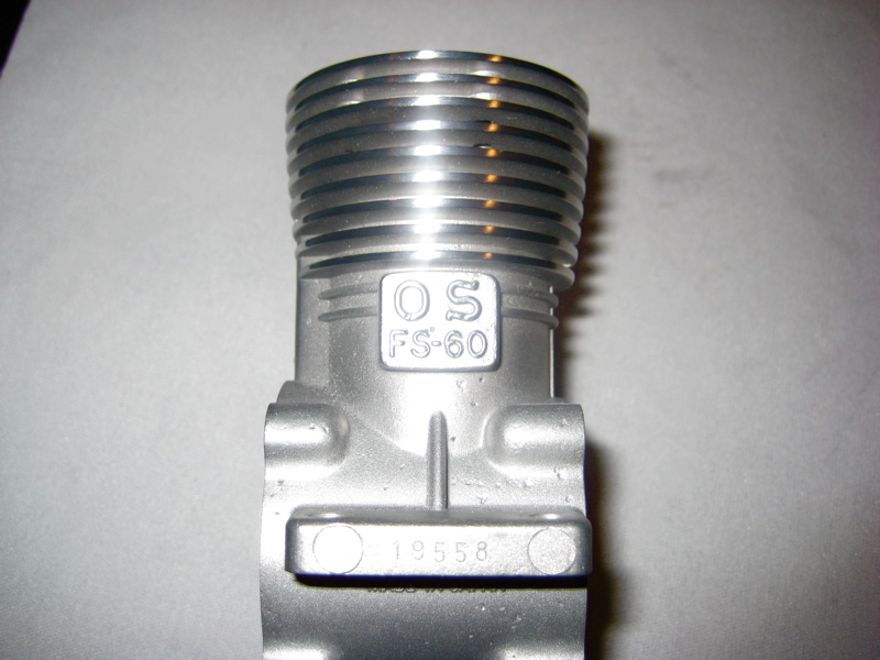

after sandblasting all the motor/head/casing parts, i started to clean them up. with a scotchbrite wheel on a buffer, i cleaned up the block fins, then washed/blew out the block.......

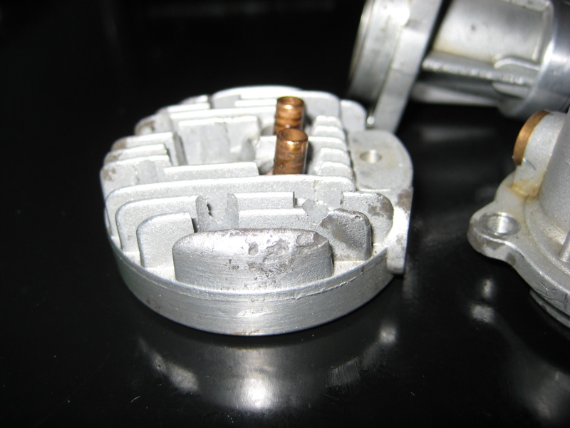

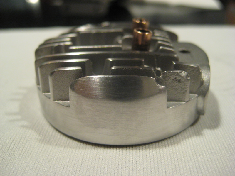

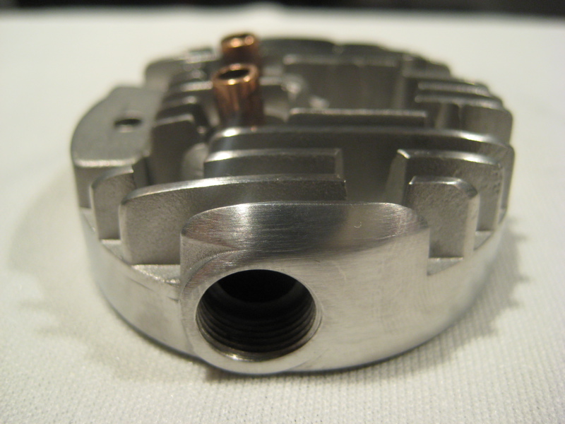

i then tackled the tattered head. it has seen pavement in it's lifetime, but i ground it down the best i could, reshaped the outer profile a bit, to hide the road rash. i think it came out pretty well, considering what i started with! all of this was done on the buffer, with the scotchbrite wheel..........

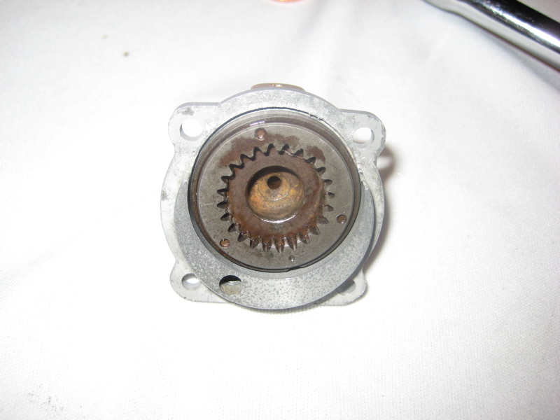

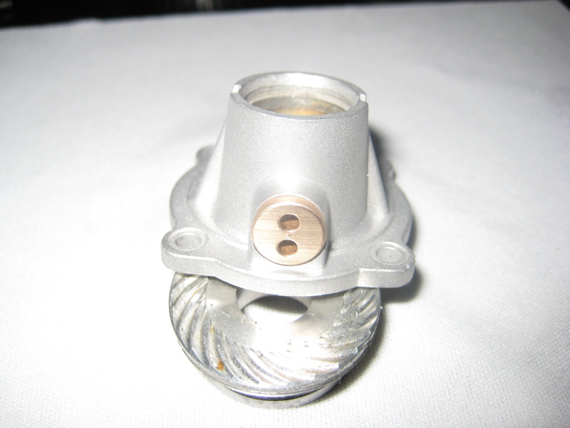

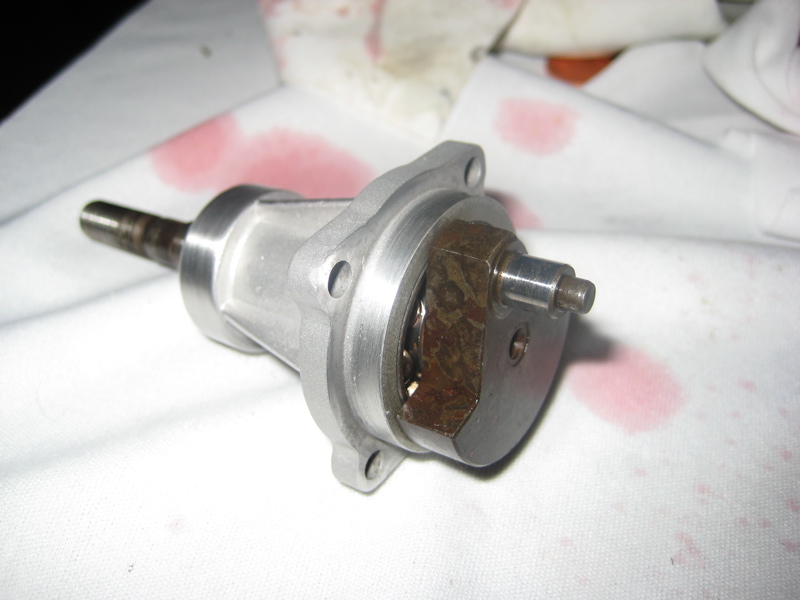

i then cleaned up the cam housing, loaded it it up with the cam.......

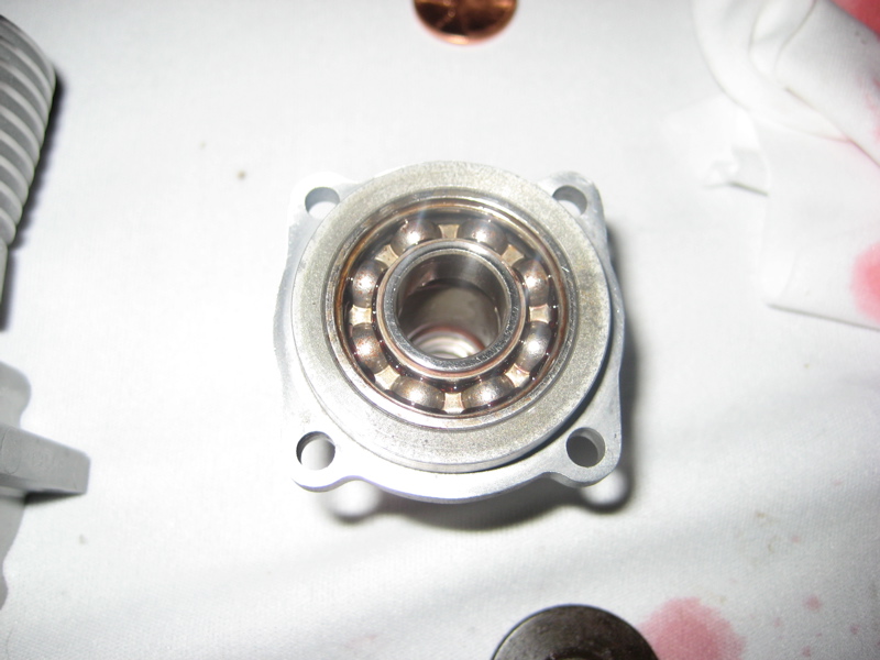

i polished the crank housing a bit too, and loaded him with bearings and a cleaned/checked crank.............

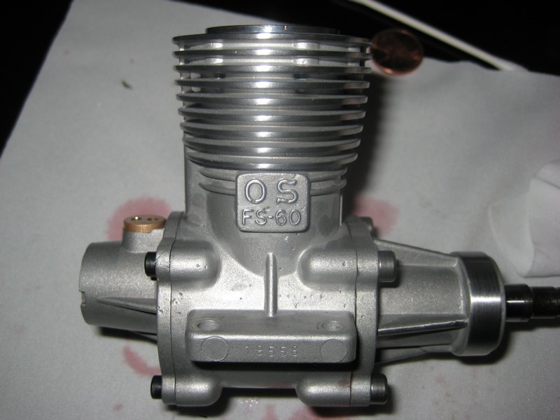

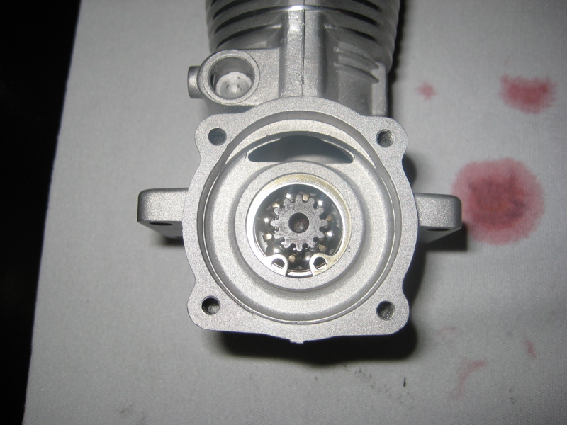

i then started to reassemble the block, in went bearings, cam drive gear, the cam/housing, and the piston/sleeve, and finally the crank/housing. i timed the cam bearing using the 'dot' to get top dead center. i found this info in the 'engines' section of this website................... oh, and a shot i missed of the heads valve seat/bowl area cleaned up and ready for assembly...

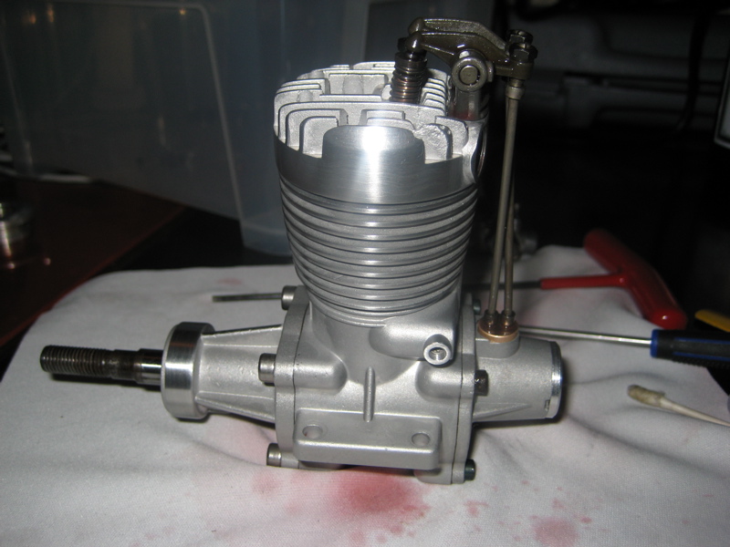

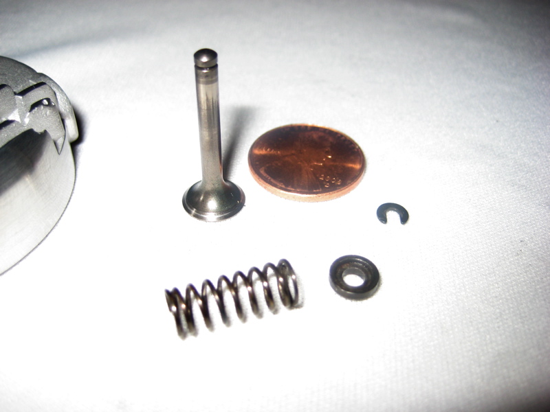

then came the head assembly, i put it on with new head screws, stainless ones......
lifters and pushrods next...............
oh, shot of the valve, spring, retainer and clip, next to a penny for size reference. these things are really small!! (i am used to car engines mind you......... here is a shot of the engine i built for my gto.......... maybe i'll post some youtube vids in here if it's ok with the mods......)

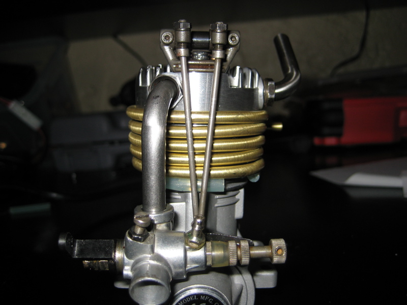

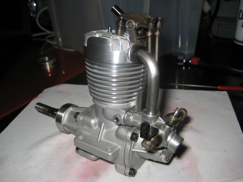

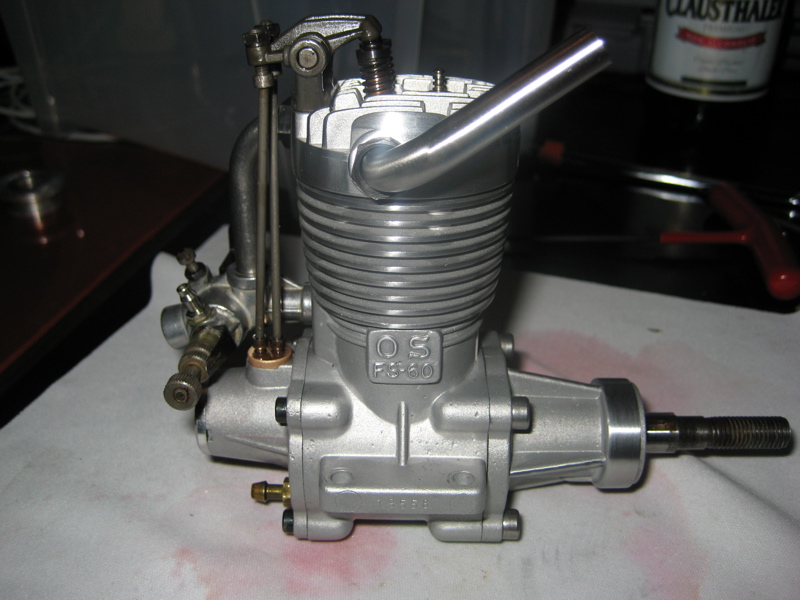

and, here we are with the carb/intake attached, and with exhaust....... (not sure how i'm running that yet, we'll see when it's in the boat......)
oops, forgot the bucket 'o parts we started with...............
all in all, i think it came out ok, at least good enough for what i am experimenting with..........

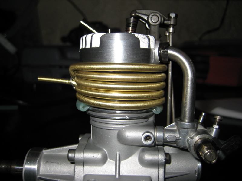

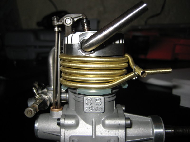

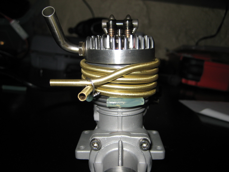

then, i didn't know if 'air cooling' would do it, and i had another wild hair to try and water cool it.....
man, was it a major pain in the you know what trying to get the cooling lines to 'hug' the block good. it has a good taper, so it just wanted to fall down off of it. then you have pushrods in your way, and have to clear them. i fought it a bunch, but started to make headway. it was my first time trying this, i did heat up the tubing red hot, let it cool, filled it with salt, then formed it around the block. i then saw i needed to 'hold' it up on there, so i took a piece of small stainless wire, put a few small sections of fuel line on it, and tightened it around/between the lower block fins. this essentially 'holds' the cooling line up nicely to the block. i then fastened the two ends of the line to one another, to keep it 'tied' onto the motor. i know, it's kinda ghetto, but it's the best i could come up with for now.........
so, there is no head cooling, but, like the standard marine version of this engine, this is 'sleeve' cooled. it's how os did it, so i figure it should work, that with it being in an open cockpit style boat catching a breeze most of the time, i think it should be ok. what do you think???????
well, that's my engine build for the fourstroke boat winter project, let me know what you folks think.....
