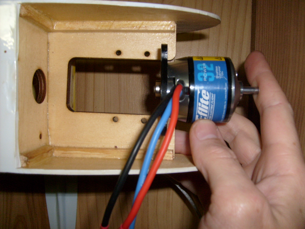

Ok. Technique for installing this power 32 outrunner? Some onetold meI could use 4 long bolts, with long spacer in between two washers?

Old 02-10-2012 | 06:18 AM
Flyin Beagle's Avatar
Joined: Dec 2008
Posts: 365
From: Lexington, KY
Default RE: TiteBond
Bolts with spacers may work, but the most common thing I have seen is to build a balsa wood box on the existing motor mounts to carry the engine. Do a search for glow to electric conversions motor mount and see what you come up with.

Old 02-10-2012 | 08:10 AM
Lnewqban's Avatar
Joined: Apr 2007
Posts: 4,057
From: South Florida
ORIGINAL: TotalWreck
Technique for installing this power 32 outrunner? Some one told me I could use 4 long bolts, with long spacer in between two washers?[/b]
No, not long bolts there.
Just a plywood firewall between both cheeks, and having the existing engine mount as a central reinforcement.

Old 02-10-2012 | 10:27 AM
Joined: Oct 2009
Posts: 66
From: Mount Airy, NC
ORIGINAL: Lnewqban
Thanks Lnewqban That is the perfect mount. Thanks I was looking for something just that simple. And I already have the same size ply wood that I had ordred. Awesome. Now to get me a prop adapter and prop can anyone recomend the correct size prop? For a power 32? I'll be useing a 60A esc latter when I can afford one. I already know that I need a 5mm prop adapter.

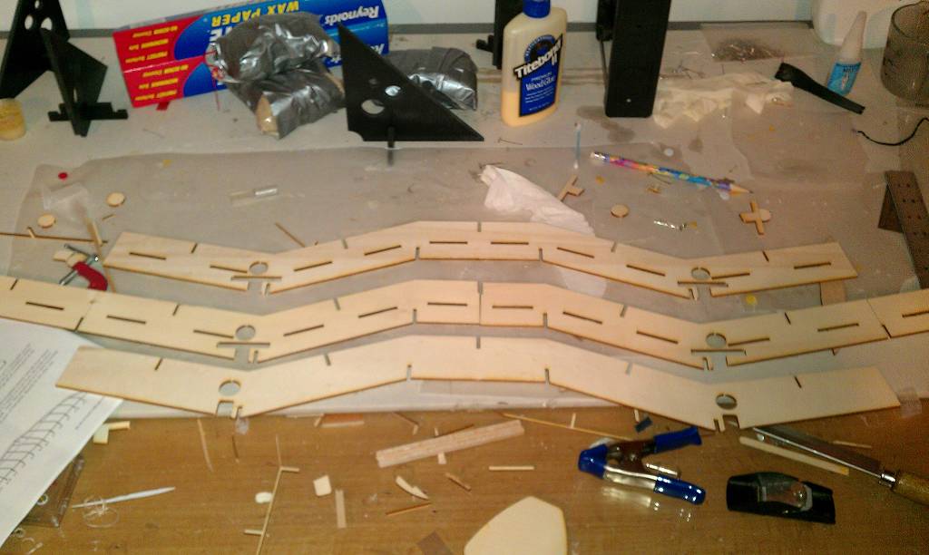

Old 03-13-2012 | 06:56 PM
Joined: Apr 2007
Posts: 226
From: Chapel Hill, NC
Here a question regarding Titebond II and epoxy. I am building the wing of a F4U Corsair, a 1/8 Pica Kit. The main spars are made of 1/8 ply, and the two halves are sandwiched in the middle (back and front, see pic) between two 1/8'' ply braces that extend about 14'' from the middle. The spar/braces are 2'' from top to bottom. My first instinct would be to use Titebond. The surfaces are flat, they can be securely clamped, and I can easily clean up the many slots before the glue sets. Strengthwise, long grain against long grain is perfect for Titebond. The wood would fail long before the glue. However,
I also know the mantra "thou shall not laminate with Titebond". So what would you guys do? I do not want to end up with a warped spar, or worse. Time is not a big issue, I can let it sit for a few days...

Old 03-14-2012 | 06:29 AM
Banned
Posts: 2,670
From: San Diego, CA
"thou shall not laminate with Titebond". "
Where did that come from. I see no rational.
Les
Old 03-14-2012 | 08:22 AM
Joined: Apr 2007
Posts: 226
Well, it was mentioned in an earlier post with regard to fuse doublers. I think the idea is that water based glues applied over large surfaces of balsa sheet will cause it to warp because of water seeping into the grain. Here though I am talking about plywood and in a narrow and long joint. I think I will take a salomonic approach: epoxy on the back and titebond on the front...
