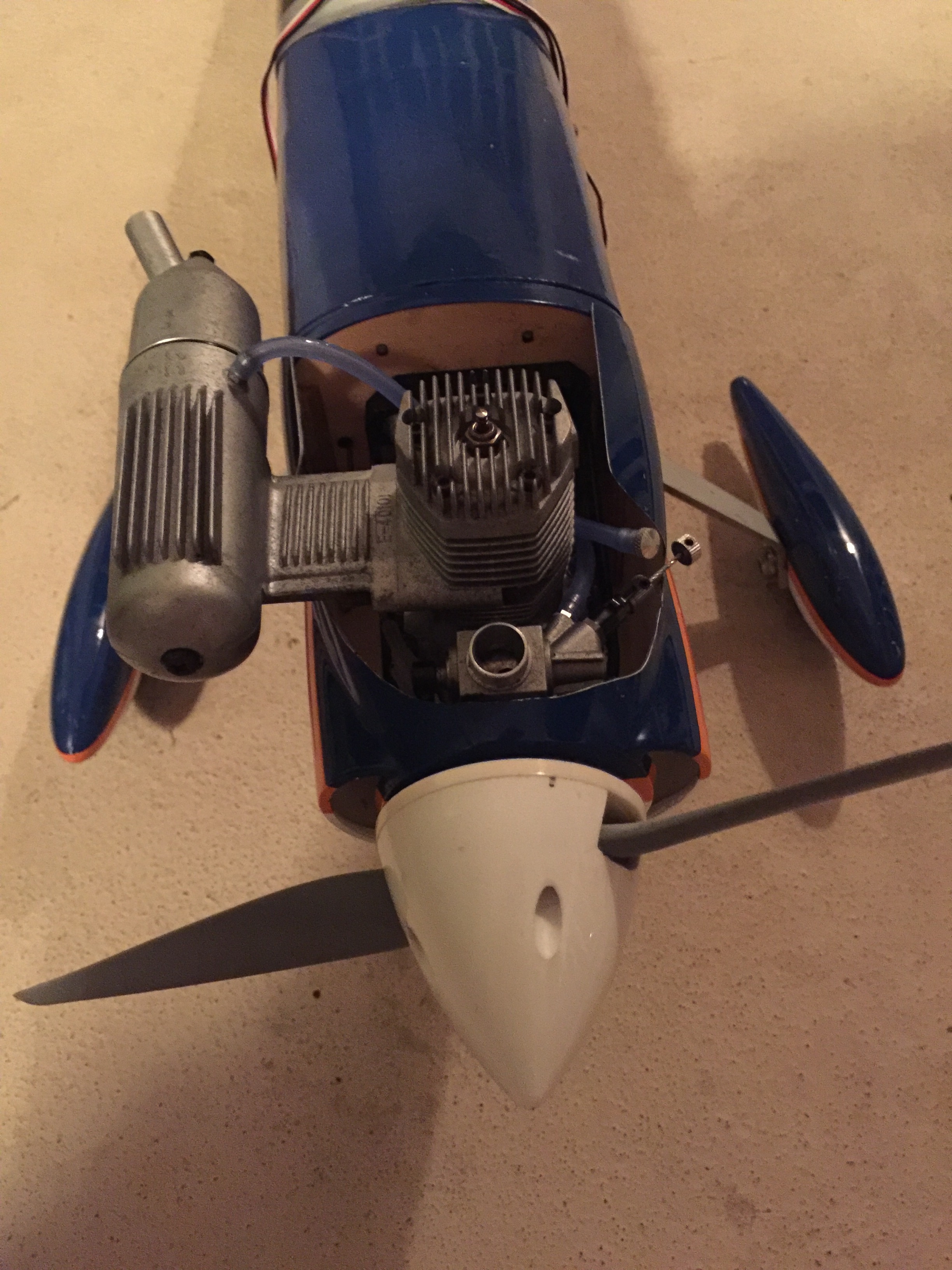

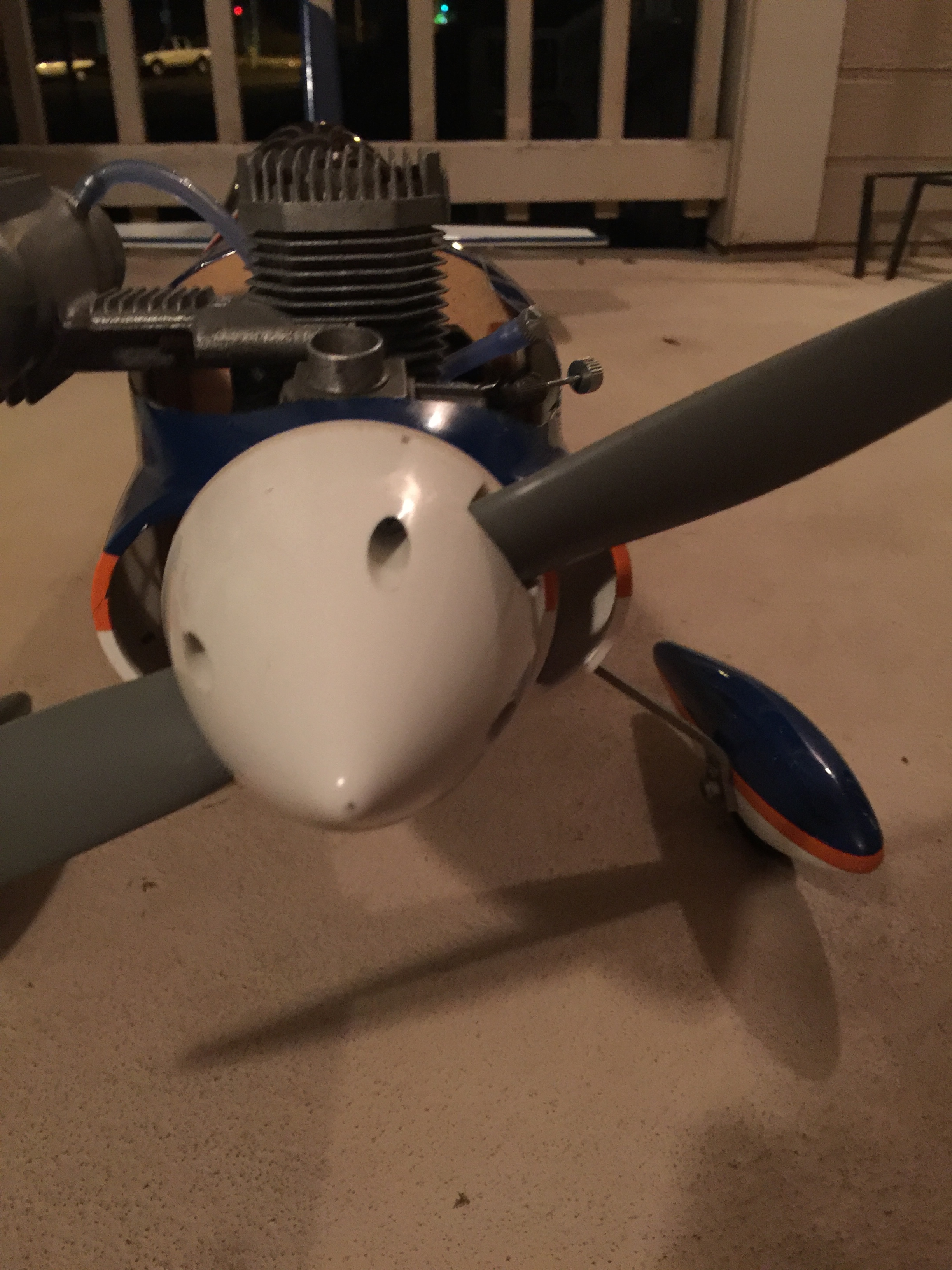

Aloha RCU Flyers,
I have a persistent overheating problem with an OS 65 on my 61 size Escapade. It runs fine for a few minutes and sometimes even a few flights then the engine really loses power. After landing I noticed the engine was very hot to the touch and I got a reading of 230 degrees F on the temp gun (after throttling back and idling for half a minute or so). I have tried running the mixture as rich as I possibly can and still fly the aircraft but I have the same problem. I do have a cowl on it but I cut off the top to fit the motor and let it breathe. I have attached some pictures of the cowl to get some feedback. I run Cool Power 15 % Nitro fuel. I am out of ideas at this point and need help.

Faulty carb ?
Air leak somewhere ?

Is there a fuel filter installed? I don't see one.

Nope speed, I'm not running an inline an inline fuel filter on this model.

More is needed about your tuning. Are you a pinch test tuner? Are you a tach tuner? Do you tune by ear?
When you say as rich as possible what is the data (reasons).
How old is your fuel tubing? How do you store your fuel? What Prop are you using? What glow plug? Besides Aloha, where are you (weather conditions, yes one might guess)?
The simplest reason for leaning at a while into a flight can be a hole in the tubing, brass or line, inside the tank that becomes exposed as the fuel is depleted.
Try tuning with 1/2 tank, then fill it.
These are a few quick thoughts.

1.) I use a 13X6 prop for this engine (recommended)
2.) I usually tune by ear. I listen for peak RPM then back it off a little. After the engine kept overheating I really richened it up. I have tried several setting between just below peak RPM to just inside the threshold of two cycle operation (right after the transition of four cycle operation into two cycle).
3.) The fuel tubing I use is about three months old.
4.) I use a # 8 glow plug.
5.) Yes I am in Hawaii. Temps average in the high 70's to low 80's with approx 70% humidity this time of the year.

It sounds a lot like an air leak in the fuel supply. I'd start with the simplest first, replacing the fuel lines, both the pick up line in the tank and the supply line to the carb.
Then move the search to the carb: disassemble the needle and check the O-rings for fidelity. Replace any that are not perfect. Also check the O-ring that seals the carb body to the case
Then take a look at the backplate seal. You may also have a bearing air leak but that's a stretch...
I forgot to mention that if you have an air leak that happens after some fuel burn, then the pick line in the tank is suspect. You might be able to see the air bubble in the delivery line to the carb

I have two or three thoughts on this problem.
1. bad fuel......try fresh fuel.
2. small particle(s) in the carb.....spin needle out of the carb and flush with fuel.
3. leaky or loose plug.......replace with a new one
I would try #2 first and then #1, followed by #3.
If these three fix attempts are unsuccessful, then I would search for an air leak. First in the fuel tank and lines, then the carb to case junction and then the rear case.

All it takes is a pin hole in the fuel tubing. Look real close where the tubing might be touching the engine, you might just see a "flat" spot. If you do that's it. In the past I spent hours trying to figure out why everything was ok and then not.

Also look close at the fill line. Looking at the picture it looks like it might be rubbing on the engine. If I were you, I would just go ahead and change all of the tubing. It's a cheap and easy fix for something that can make you crazy.

There isn't any play where the fuel tank is installed. It is a very snug fit on the Escapade changing the level where it it sits would require some modding.
