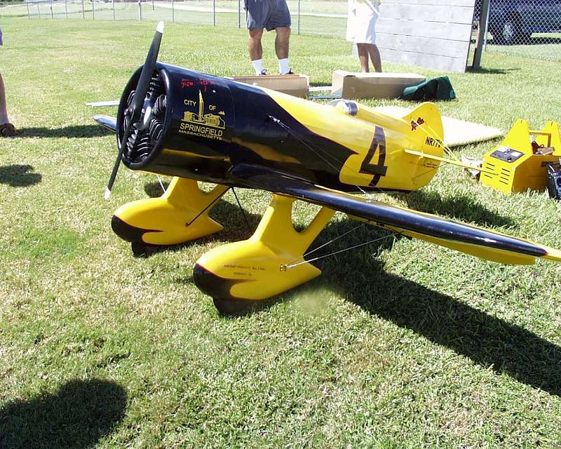

I covered the wood part of the wing fillet with Solartex. I used epoxy and micro balloons to transition between the covered and front plastic wing fillets. I then primed and painted the front plastic wing fillet parts black as I painted the Solartex.
I used some silver elastic cord that I found at Hobby Lobby for the flying wires. They are just for looks.

I think I'll use the same method to paint my fillets, but I believe I'll use a catalyzed primer to fill the seam. I tried using spray cans but the build up is insufficient and it takes too long to dry.
I've balked at the elastic flying wires but after trying a few various methods, wire and kevlar, I think I'll go with elastic.
