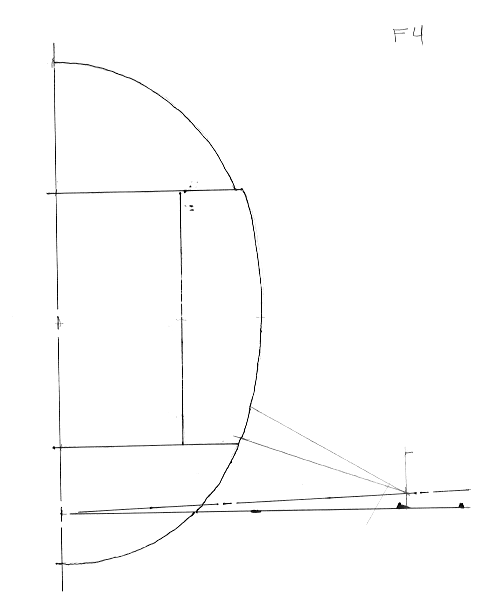

Greetings Jacs;
Hang in there - I fiddled with these things for a month before I
finally re-drew them.
I think I ran into the same problem that you're seeing - on my plans,
the three forward WF formers are roughly a trianle; the flat bottom
is easy enough to figure out - it goes against the fillet base, but
then, neither of the curved sides appears to fit the curvature of
the fuselage. Then there's the strange one that's three straight sides;
what on earth do you do with that??!
So, on a piece of drawing paper, I traced the wing rib, and some
pertinant details from the fuselage, viewed from the side, and on top
of this I free-handed what I wanted the new fillet to look like. That
gives you the height of each former.
Then I made three tracings of F2, F3 and F4, but also with the wing's
surface on each one, and just plotted on each one a straight line from
the height of the fillet, out to the width of the base (which goes, I
think, almost to the wing's third rib out, or something like that).
To get the sharp curvature at the very front of the fillet, I made the
whole front former out of 1/4" balsa, and rounded it over, but you
at least have the plastic parts. You're way ahead of the game in
that respect.
Once the fillet shapes were determined, it was easy to make the actual
sheeting. Since I took the concave curvature out of the former tops, I
could use one long piece of balsa sheeting to go over the whole thing,
and I determined the shape it needed to be from my new drawings.
I still have them. Let me see if I can get them scanned and post them
for you tonight or tomorrow.
Dan.

Hi Jacs; Here are the drawings I came up with to work out the fillets:
The first image is the wing rib top with the vertical lines showing where I want the wing fillet formers to be (the first one is a little bit behind the corresponding fuse former). I freehanded a somewhat smooth line for the new fillet outline.
The images after that are just tracings of fuse formers F2, 3 and 4, with the wing's actual surface drawn on, and then a line is drawn between the intersection of the fuse and fillet, and the wing and fillet. I tried to keep each angle about the same to avoid much twisting in the fillet sheet - that made the actual fillet shape easier to determine.
If you'd like more pictures, just holler - I have the actual fillet on the plane (I left off the base - didn't really see a need for it while the wing is on) and the template I used to shape it.
Dan.

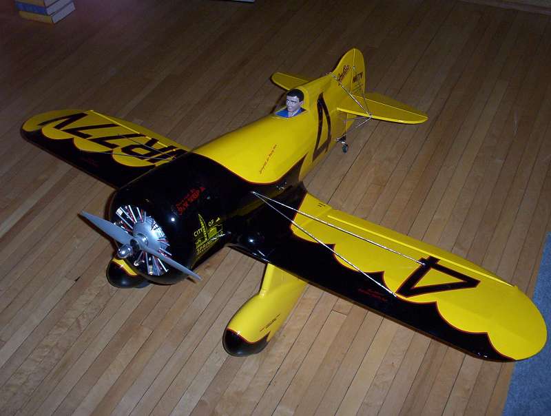

It's been a long road but I'm finished, almost. I still have to complete the radio installation and break the new engine in, but it's ready for next weekends Mall Show. I'll let you all know this spring how it flys. Thanks again for all who helped me with thier advice, and thanks to ZPAT for starting this great thread. I'd also like to thank Adrian Page for such a nice kit to build. I'm very happy with the way it turned out.
Jonas, don't give up on yours. I want to see pictures of the finished plane someday.
Mike
Mike

Very nice pictures Mike
Now Gee Bee Z and Pitts S1 hangs up to the ceiling because I borrowed a mini lathe from a friend so that I can manufacture a prop hub and an engine mount for my converted chainsaw.
Hope that you make it to next weekend and nobody by accident destroy it.

To answer your question the top fairings on the pants do need to be notched to clear the wire. Each of my pants is 2 pieces. 1 is the gear fairing and the other is the wheel fairing. The gear fairing is attached in the front only. The rest of it is open so I can slide it on and off the gear wire. It is all attached with 4-40 bolts.
Mine looks the same as it did when I posted the last picture. After seeing gbzflyers results with solartex I got frustrated with the coverite and my fuselage could use a bit more sanding to take out the imperfections.

WI
Jonas,
The top of the "legs" of the wheel pants, where they contact the wing, need to be notched to allow the wire landing gear to fit. The "U" shaped inner seam of the legs need to be left unglued to allow the wire landing gear to pass through when attaching the wheel pants.
Let me know if you need me to take any pictures of mine to show you what I mean.
Mike
Mike
