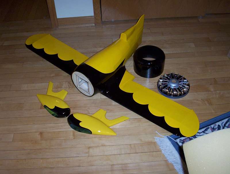

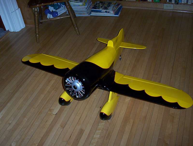

Default RE: Scale Gee Bee Z question.
Here's a few updated pictures. Getting the wire landing gear and tires lined up with the wheel pants has been the most work so far.
I got the decals with the kit for all the small lettering, but what are you guys using for the "4" on the fuse and the numbers and letters on the wing? Maybe a sign shop?
I'll be working on mounting the engine and cowl next.
Mike

I guess you could seal everything with a clear coat.
By the way, what does your Gee Bee weigh?

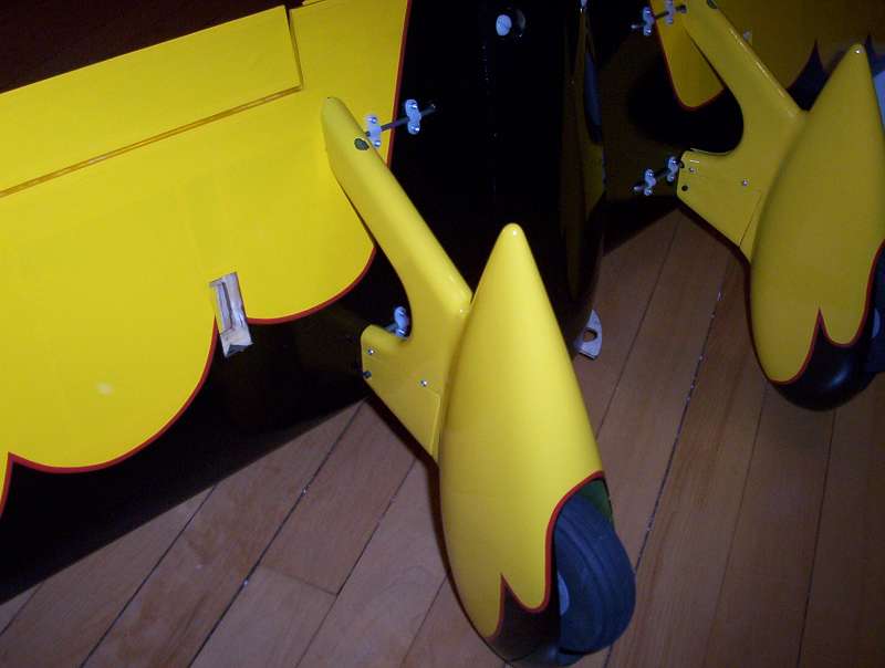

Old 01-26-2004 | 06:12 PM
  #144
Joined: Nov 2003
Posts: 88
From: Green Bay, WI
Default RE: RE: Scale Gee Bee Z question.
Zpat,
The plane and engine weigh 5 lbs. 3 oz. That's without radio gear or tank. I hope it comes in under 6 lbs. I'm going to run a Sito .72 4 stroke in it, so it should get off the ground.
Adrian,
Thanks for the info on the large number and letters.
Jacs,
It was fun instant messaging with you on Sunday. I hope to do it again soon. I've attached a couple of pictures that you requested. Let me know if you need any more.
Mike
ID:	94568   Click image for larger version

Mike,
It was very fun but I think we are limited to the weekends. I saw just now and the clock is 06.00AM here that someone was on line but I don't know if it's you or your boys.
Like always there are difference between your kit and my plane. You have two music wires going to the fuse and I shall only have one according to plans. And I just saw that you have a big hole in your wing. Or maybe you are going to mount a wing servo there. Otherwise it's very nice pictures of your plane hope that I can get 20% of that result.

Jacs,
The cutout in the bottom of the wing is for the aileron servo. Do you think one wire for the landing will be strong enough?

Mike,
I don't know if one 4 mm music wire could handle the forces when you flex the gear in to fuse and out to wing. One thing is that I can't flex it with out an hammer and a big vise. There are going to be an music wire attached between wheel and fuse so I don't think that it should be any problem. I'm not going to land sideways anyway.
