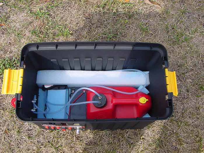

I got a green one like Billy's from sams club. I abandoned that box and used it for tools, because it didnt come with a tray like the black and decker one does, I had trouble finding space for some of my tools, otherwise it was the exact same box, just green and labelled as a tackle box.
I now have the black and yellow walmart box. For fuel I used a one gallon red plastic gasoline container also from walmart at about $2. I have the fuel container, and battery in the lower half of the box, without having to modify the box for them to fit.
My starter is in a separate carry tray. A smaller version of one of the carry trays that is in the top of each section of the larger box. I used a 5Ah 12V battery from a local electrical warehouse in the small carry tray to power the starter. One side of the carry tray is sectioned off, so it has a place for my glow igniter and a couple of small carby tuning screwdrivers. My wife picked up the small carry tray at Roses for $1
So, I now have a toolbox/fueling station to use in the pits, and a separate easily portable starting box to carry out to where we start our planes.
I will get some pictures to post here later.

Fuel tank detail
I use 2 dubro quick fuelling valves for the fueling system to exit the box. One valve is the fill/empty line, and one is for vent. The two valves are connected with together with a short piece of tube, to provide a loopback system so that the entire fuel system is always closed loop.

Brett,
Good shots of the field box!
I assume the battery is to the left of the fuel tank under the blue (foam?) cover and the fuel pump is under the foam bar at the rear?
Let me know.
Regards,
Al
Old 06-26-2002 | 04:10 PM
  #40
Posts: 228
From: Hickory, NC,
Default THE FIELD BOX FROM HELL! aka The Ultimate Field box!
Al,
If you look closely at the picture (click it to get the large version) you can see the battery to the left of the fuel tank it is not concealed in any way. You can also see a little bit of the pump where it protrudes out of the long bar of blue foam to the top left of the picture. Look even closer, and you can see how the plumbing is connected to the 2 dubro fueling valves.
