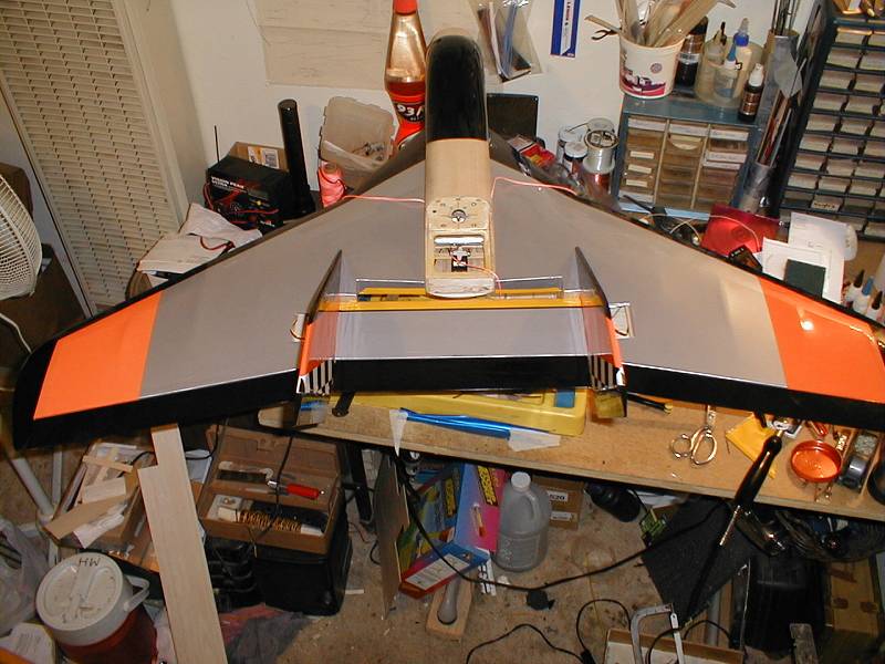

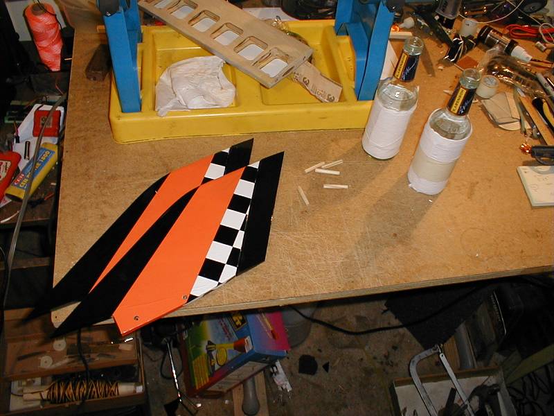

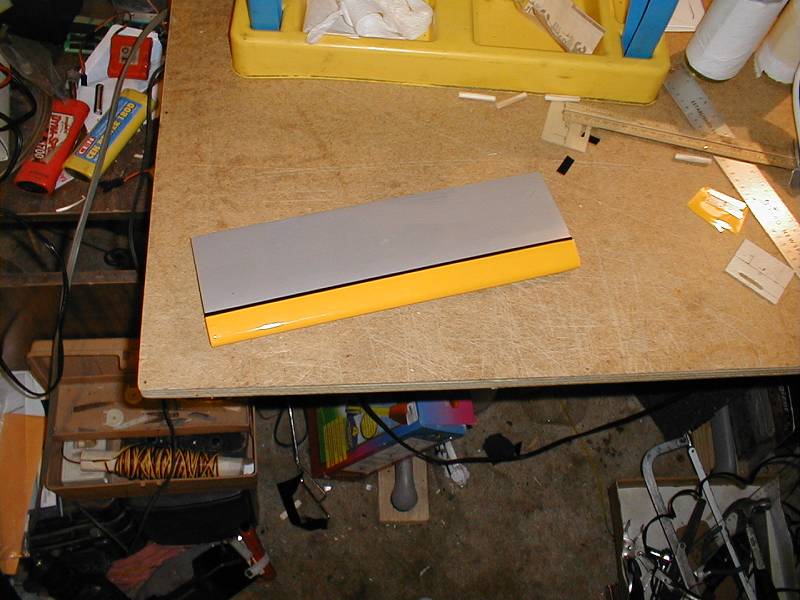

OK... More progress.
Rudders are shaped, smoothed, covered, hinged and installed
(that was fun to say)
Elevator is covered and hinged. (Wish Id found the metallic blue monokote that I used on the wing stripes before I put the black one on, but it looks nice anyway)
(that was fun to say)Elevator is covered and hinged. (Wish Id found the metallic blue monokote that I used on the wing stripes before I put the black one on, but it looks nice anyway)

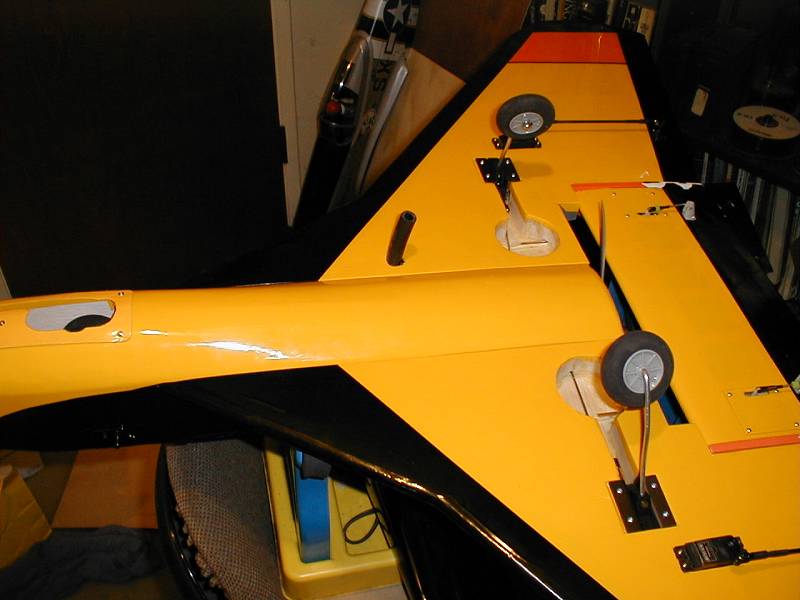

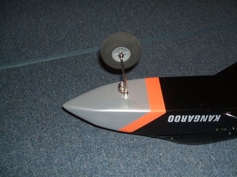

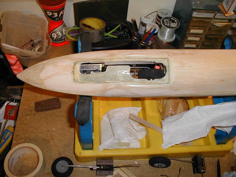

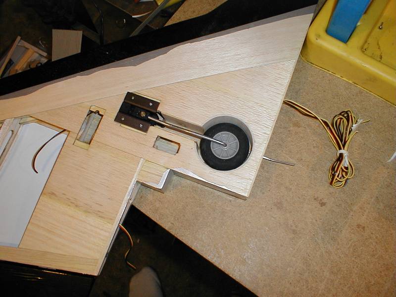

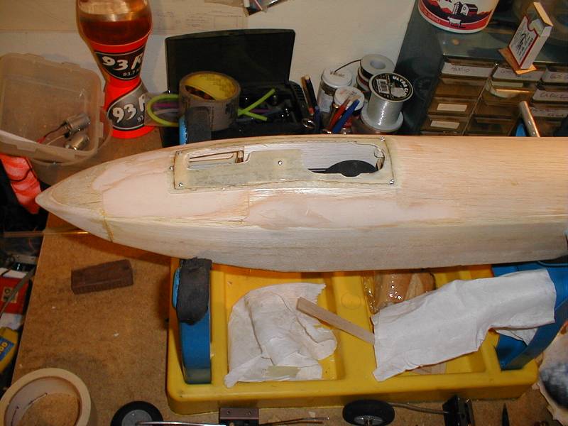

funny how things can end up working out. Earlier I came up with about 5 options for the nose gear door/opening. I ended up going with option 6
I just attached my piece of "fiberstuff" to the bottom of the fuse over the opening with screws, and cut it out just enough for the wheel to come out. It was simple, and Ive seen similar on other fast planes, so I reckon it wont cause too much drag. I plan to paint it to match as close as I can to the bottom after I finish the monokote. (the pattern may cross the cover somewhere, havent crossed that bridge yet :P )
I also sheeted in the Main retract wells with balsa, as I wasnt able to get the plastic ones to fit, and they didnt match the yellow anyway

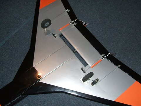

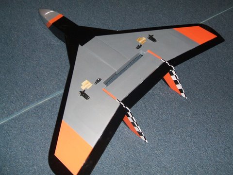

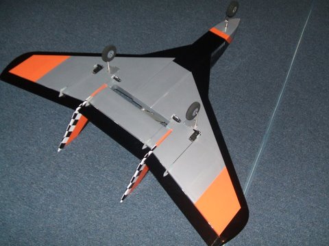

Ok, got the monokote on the bottoms of the wings. I think it will contrast nicely from the top now.
This thing is starting to get really close. I still have a lot of work to do as far as installing the radio gear and engine, but I am starting to see the light at the end of the tunnel. I am even having fantasies of having it ready this weekend. Now if only the weather will cooperate.

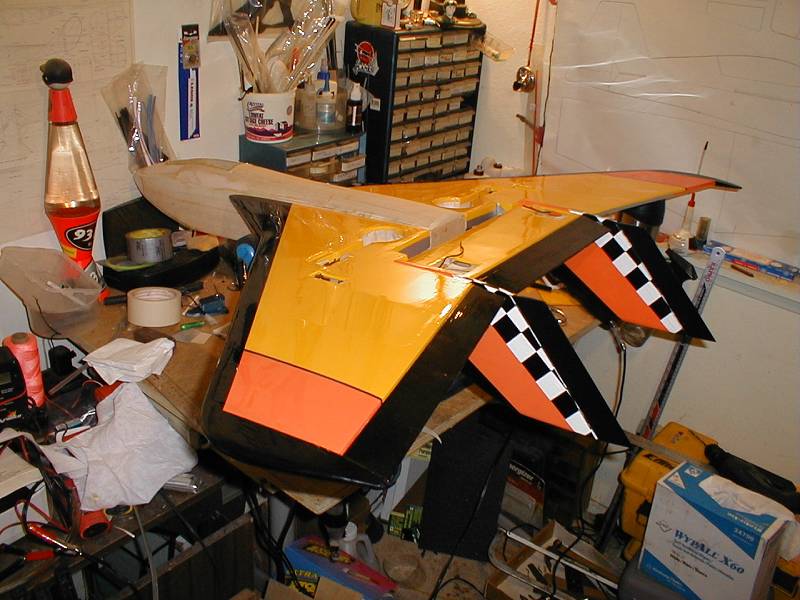

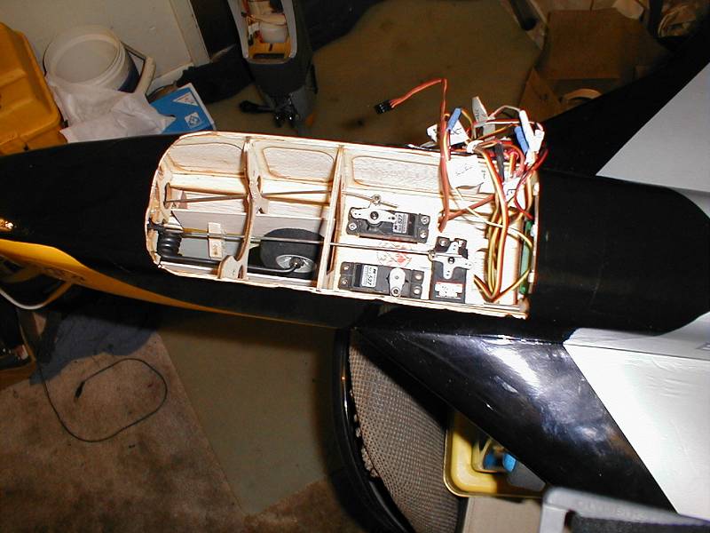

All servos, the Retracts, and the engine are fully installed now. Im almost done with the wiring, only have to wire the retract servos together and Im all done. I counted it up, and there are 45 solder joints in the wiring for this plane. My Dad gave me a neat battery powered soldering iron for christmas, which made the job go smoothly
I Used a 9 Channel reciever, and set up the channels as follows:
1: Right Aileron (Elevon #1)
2: Left Aileron (Elevon #2)
3: Throttle + Battery#1
4: Right Rudder + Left Rudder
5: Nosewheel Steering
6: Elevator #1
7: Elevator #2
8: Main Retracts + Nose Retract
9: Battery #2
Im going to start with a pair of brand new 4.8v Nicads (600 & 700 mah). The weight of those combined is only about 1/2 oz heavier than the single 1650 mah NiMh that I have in most of my other planes. I wanted to go with the 2 batteries with this plane both for redundancy, (because it will be fast) and to spread out the current draw over the reciever because there are so many servos.
Ive been debating during this whole process what to do about the Muffler. backwards, the stock one points the output tube into the wind. Not only that, but now there are servo openings behind the engine that I would prefer to keep oil out of
I went with a length of gas tubing for a car that I had laying around. it fits right over the end of the muffler, passes through the wing, and sticks out about 2" from the bottom of the wing. I only had to go through sheeting to do it, so it it doesnt work out, Ill just monokote back over the holes
I am hoping that the oil will mostly just shoot straight down when the plane is upright, and not get onto the rear too much, but even if it does, now its more in the center away from the servos. Sorry I dont have a pic of the bottom, my camera is sort of dying, and it wouldnt take any more pics

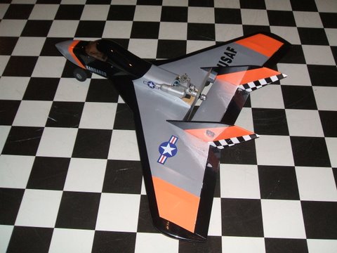

Our club had its annual "Freeze fly" yesterday, and I got to take up the new plane for a few rounds. Actually, the weather was quite nice. 50-60* and hardly any wind.
After some tuning (and some exciting aborted takeoffs) we finally got the engine running well. Seems at some point I adjusted the idle mixture way too lean. Its an Evolution 46NT running an 11x7 APC Pusher. The engine seemed to produce plenty of power in the air, and flew the plane much faster, and with a better climb rate, than the OS 46FX on my H9 Raptor. The takeoff runout was almost as long as the Raptor's however... I think an 11x6 would give me better thrust. I also want to try the 10x7 3 Blade MAS I have on the raptor, if I can find a pusher version.
I wish I could say it took 2 clicks of left and 1 click of up and it was perfectly trimmed, but I seem to have not reached that point in my flying career yet
This is, I believe, my 10th plane, and my experience has been more along the lines of 8 clicks right, 7 clicks up, and some rudder for good measure
Not sure yet if it's my balancing, or just that after a while you can anticipate which way the trims will need to lean... but someday I'll get there
Once I had the plane trimmed out, it was Awesome! The ailerons are very sensitive, and I had to dial them down a bit after the first flight, which was a little scary [8D] Im really glad I went with the elevons + the elevator in the middle, instead if just the elevator. Using almost all the throw I had made the elevator feel just about perfect. I will try moving the balance back just a bit and see how that does, but the balance in the manual seems to work out very well. Actually, the balance point is all I used the manual for, after reading it through the first time, and seeing how bad it was. (the plane is great though)
The rudders were a great add on. The plane tracked really straight, and the rudders hardly cause any rolling action. (finally got the rudder/aileron mix dialed on the raptor, takes 24% opposite aileron to make up for the rudders on that plane, can almost do a barrel roll with them....) On landings, they helped make up for the slight crosswind that seems to always be present.
This thing is FAST! I mean, looking at it, no one would mistake it for a slow flyer... but I was amazed at how fast it ate up airspace. I know its not even as fast as a jet, but its definitly the fastest thing Ive ever flown, and it gets the adrenaline going
It also flys slow fairly well too, though I cant give an accurate account of the stall behavior yet. By the time I finally got around to trying a stall test, I had flown the airplane a few times, and little did I know, parts were starting to come loose. I went up high, dropped to idle, and started feeding in up elevator as the plane slowed down. I got to where I was holding full up, the plane was kind of wallowing along, wandering a bit left and right, then all of a sudden the plane dropped off to one side and fell like a rock. Fortunatly I was high enough, picked up some speed and pulled up, no problem. Flew around for a few more minutes and came in for a landing. As I was taxiing in, I noticed that the left aileron pushrod was trailing along behind the plane, having come disconnected at the servo end. (the screw holding the ball link came loose) The funny thing is, I never noticed a loss of aileron control, even as I was slowing down for my landing approach!
Landings are much easier than I was expecting. the first time, I gave myself lots of room, figuring it would come in hot. I ended up setting down almost 200' earlier than I was expecting, and rolled right up to the pits, rather than driving back from way down the runway, like I do with the Raptor.
All in all I am really happy with this thing
At some point I would like to put a different canopy on it, but for now I have so many other plane projects waiting I will just fly it as is. Time to decorate it up all the way and put a name on it though.

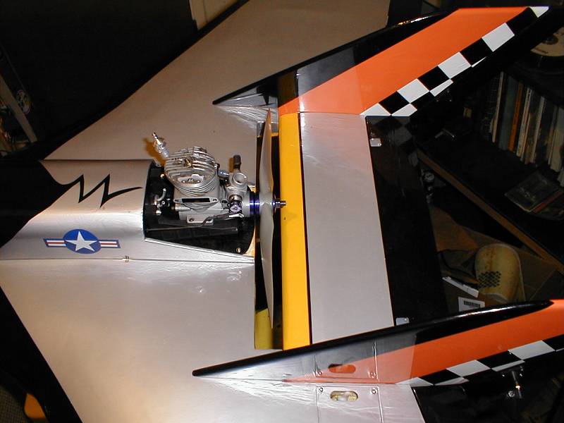

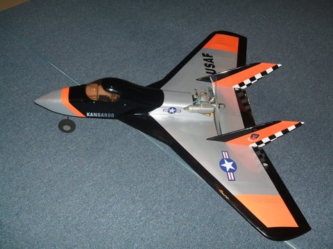

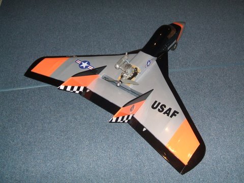

Well, I have 10 flights on the plane now, so I thought I'd post on how its been going.
I started out with an Evolution .46nt and a 11x7 APC. That combo really had ample power, and I probably would have stuck with it, except I decided I wanted that engine for another plane. I put in the OS .60 SR (ringed) that I had laying around, and was going to use if the evo wasn't enough. I had to shave a bit of the mount to get it in there, but it fit rather nicely in the end. I also enlarged the prop slot in the body a bit, to accomodate a 12" prop. With the gear I'm using, theres plenty of clearance already.
The new (actually old, but came to me NIB) engine runs really well, considering it has the needle valve assembly from an Evolution .46 on it... (the stock one having snapped off in the demise of my rambler...) Amazingly, considering the 20 year difference in production, and the different manufacturers, it screwed right in and worked fine. I also modified the muffler, so that the output tube is at the "back" now, blowing right through the prop, and the stock hole is closed up. I would post pics, but my camera is toast, and I have yet to get a new one. The increase in power isn't huge, but very noticable. Takeoff run is cut in half at least, and theres lots more climbing power. Almost unlimited vertical on 12x6 prop, not the best speed; the 11x8 was better for speed, and a bit less on vertical, but still very respectable.
Im finally getting the hang of landing it. I thought I needed to bring the H9 raptor in fast... I need to be moving pretty good in this plane or I can't keep the nose up. It feels nose heavy there, but seems fairly well balanced in flight, so I not sure what to do yet. I can't practically get any more of the gear moved back for balance, so I will have to add weight to move it back any more. (already have a heavy hub on the engine) But as long as I keep a few clicks of throttle on, it seems to be ok. I wish I could put the Oleo struts from my stang on there though
but theyre too long by almost an inch. I tend to hit pretty hard sometimes, and the wire gear are bending. I have to check them every flight to make sure they wont bind when I retract them.
If I had it to do over again, I would have completely recovered the plane in yellow, with some good markings. All the black and silver makes it sillouete really easily, and as its fast, it gets out there pretty far. Unfortunatly with all the funny joints around the prop and elevator, it would be a lot harder to cover now that its all stuck together, so Im going to go with it for now.
All in all its a fun plane
Certainly gets my blood racing....
By the way, if any mods read this, and think it would belong better in another thread, please feel free to move it. I put it here originally looking for tips on the mod to the body, but it's maybe not the best place for the thread...

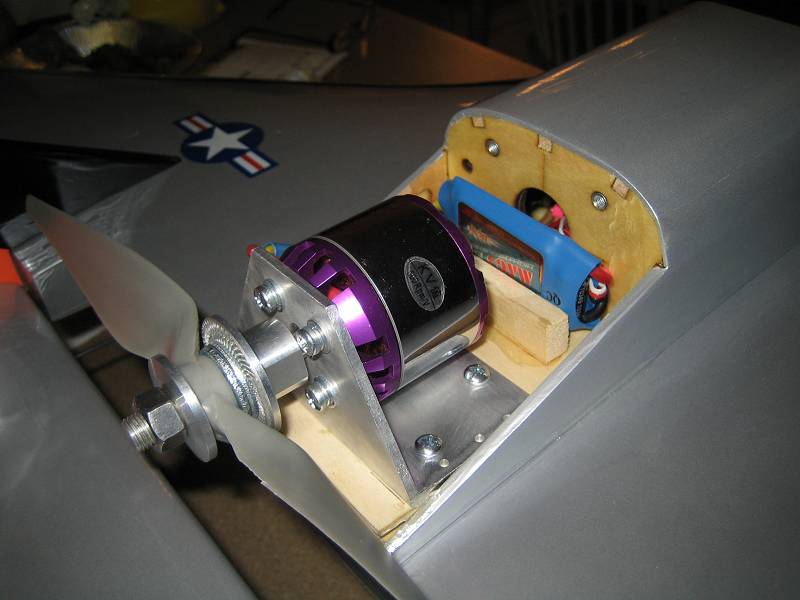

Nice mods, I have reasonetly built a Kangaroo 46 nitro to electric conversion... I am all electric. Can't wait to fly it at the field. 6s 2250mah, 50/55 500kv, 11x10 prop. I am trying to attach pics but when I try to upload they finish but when I preview they are not there? well I will post this and see what happends. Matto

Looks good! Much more sleek without the engine sticking up over the body. Actually kind of looks turbine like, that outrunner is so big
I bet it will scream with that prop, cant wait to hear how it goes
