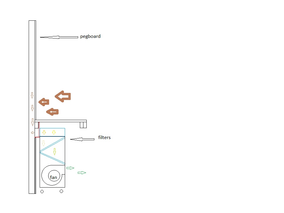

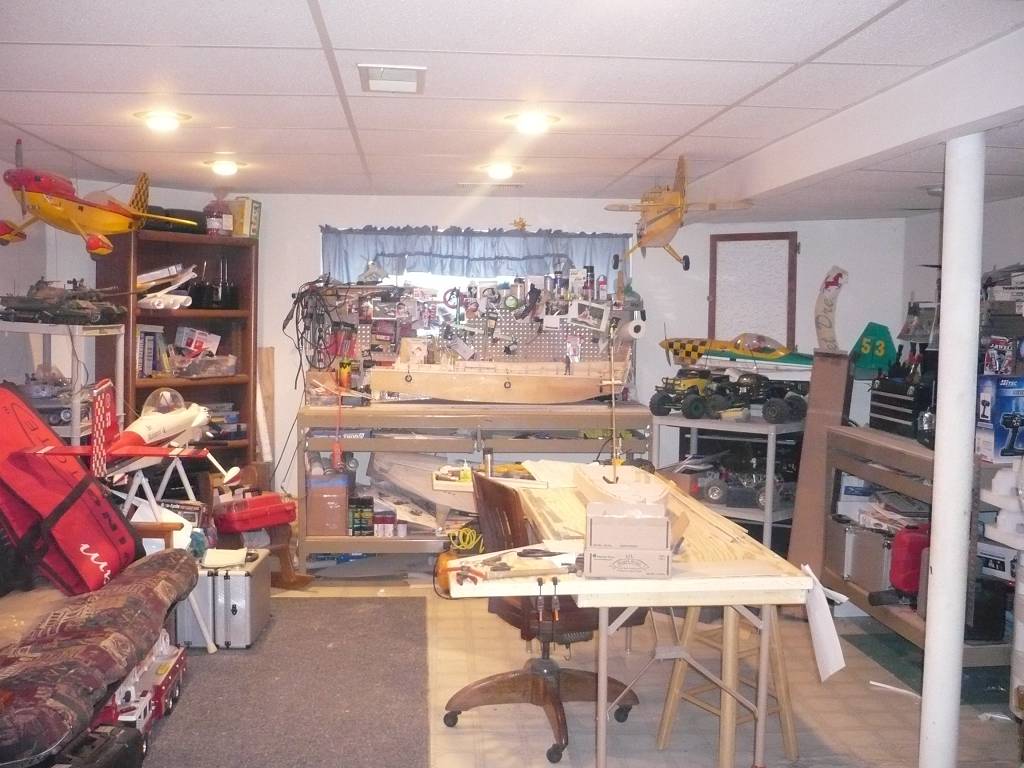

I hope this drawing shows up. My shop is in the house so I tried to limit dust as much as possible. This set up also pulls ca fumes into the wall. The fan cabinet is on wheels so that I can roll it out and use it as a down draft dust catcher. The only change I would make is I would try to find a heater core to place at the air outlet and kill two birds with one stone.
I also plumbed in shop a vac under the part of the work bench which holds my band saw, sander, drill press, and other power tools. I used 1 1/2" pvc pipe under the bench with 5-
1 1/2" holes near the back of the bench. I plug used holes to increase suction at the hole for the tool used. The added benifit is that when cleaning the bench I unplug all the holes and just sweep the dust toward the holes.
I painted the work surface with floor paint. It takes a couple of weeks to dry but the stuff is bullet proof. Also because of limited space I got rid of my multi-drawer parts cabinets and opted for Westward and Plano organizers. They have lids and multiple/variable compartments, their stackable and take up a lot less space. I lucked out when I was building my shop Home Depot had the Westward 24 and 15 compartment organizers on sale for a buck apiece. The last ones I bought were Plano from Cabellas.

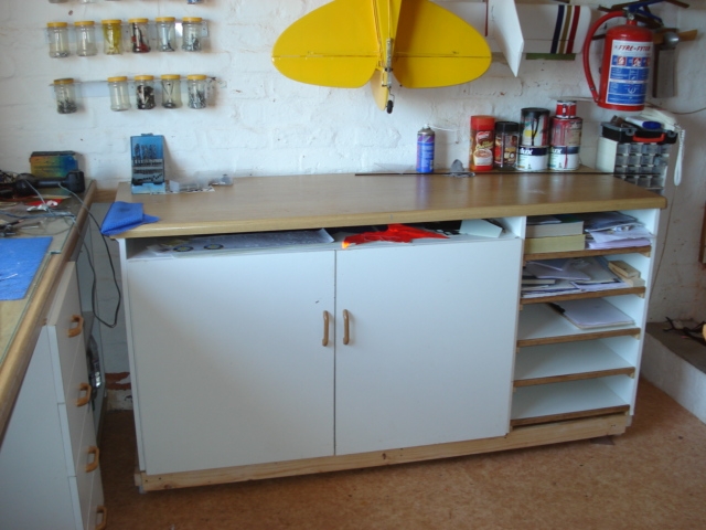

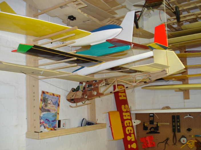

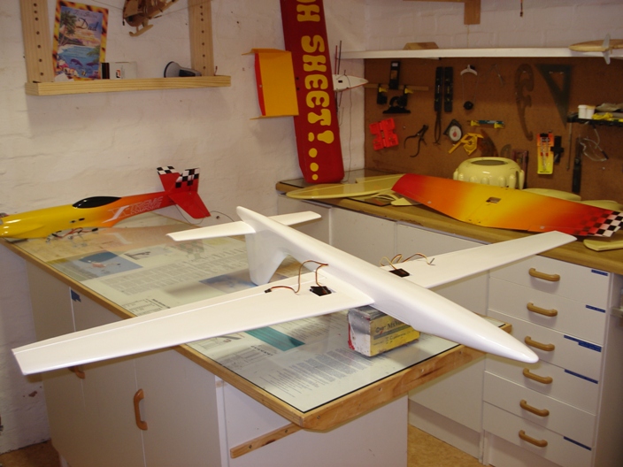

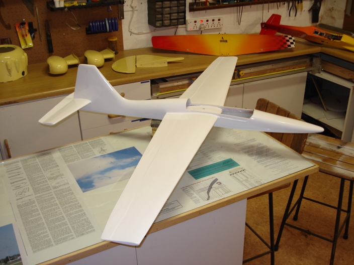

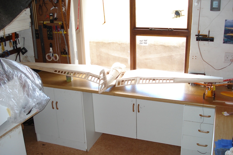

I doubt whether one will ever have an ideal workshop. When I started mine, I was still flying small planes, they have grown in size but the workshop stayed the same. It measures 3.5m by 4m. I'm using kitchen cabinet units which can be bought separately, re-inforce the bottom chasis and fit lockable castors so I can move it all around depending what I'm working on. I've fitted glass tops so I can put info , pics etc underneath whilst I can cut covering material and balsa on the glass - also build on it, just scrape the glass with a box knife blade to clean superglue, epoxy and paint off it.
I use upright wooden supports, drill holes in it, fit dowels in it and use it to store my wings.
My feather foam cutter is mounted on a pull out tray underneath the benchtop with the yellow/orange/red wing on it.

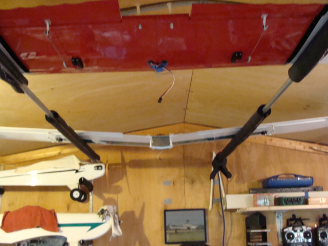

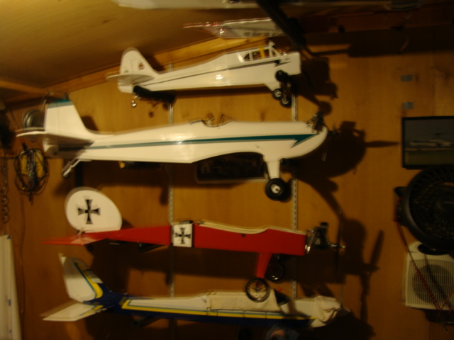

My hanger is a 12 X 8 shed with 2 benches with4 model aeroplanes a glider and my mountain bike alng with my flight box ,tv ,etc : it does 4 me .

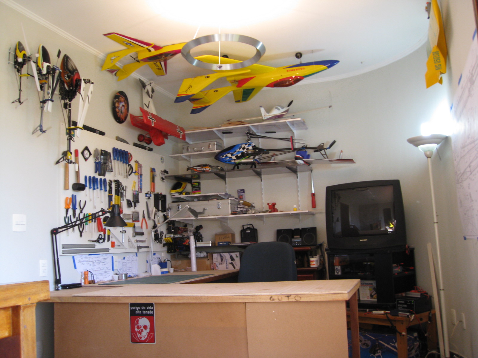

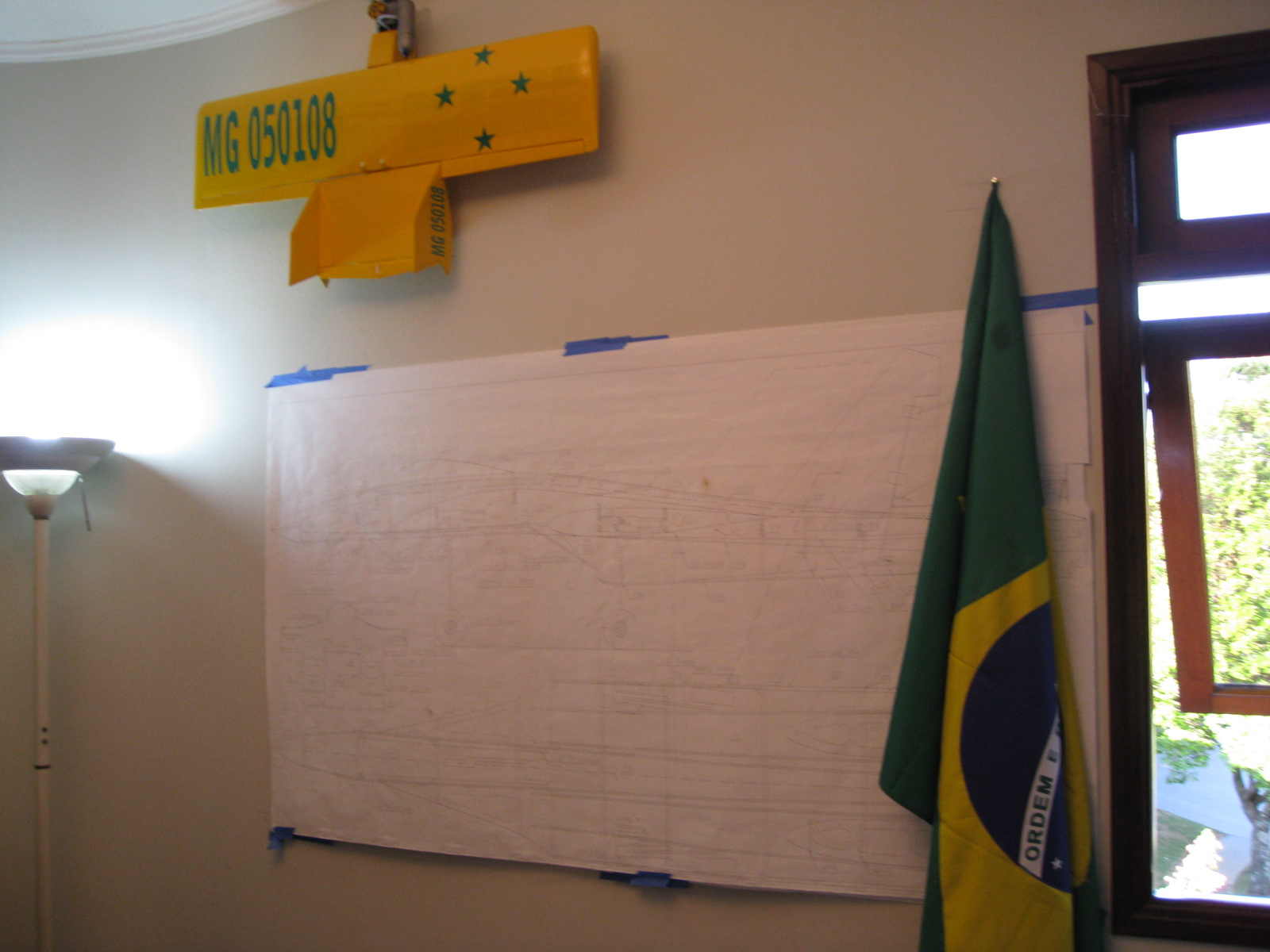

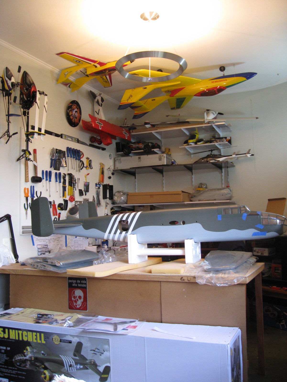

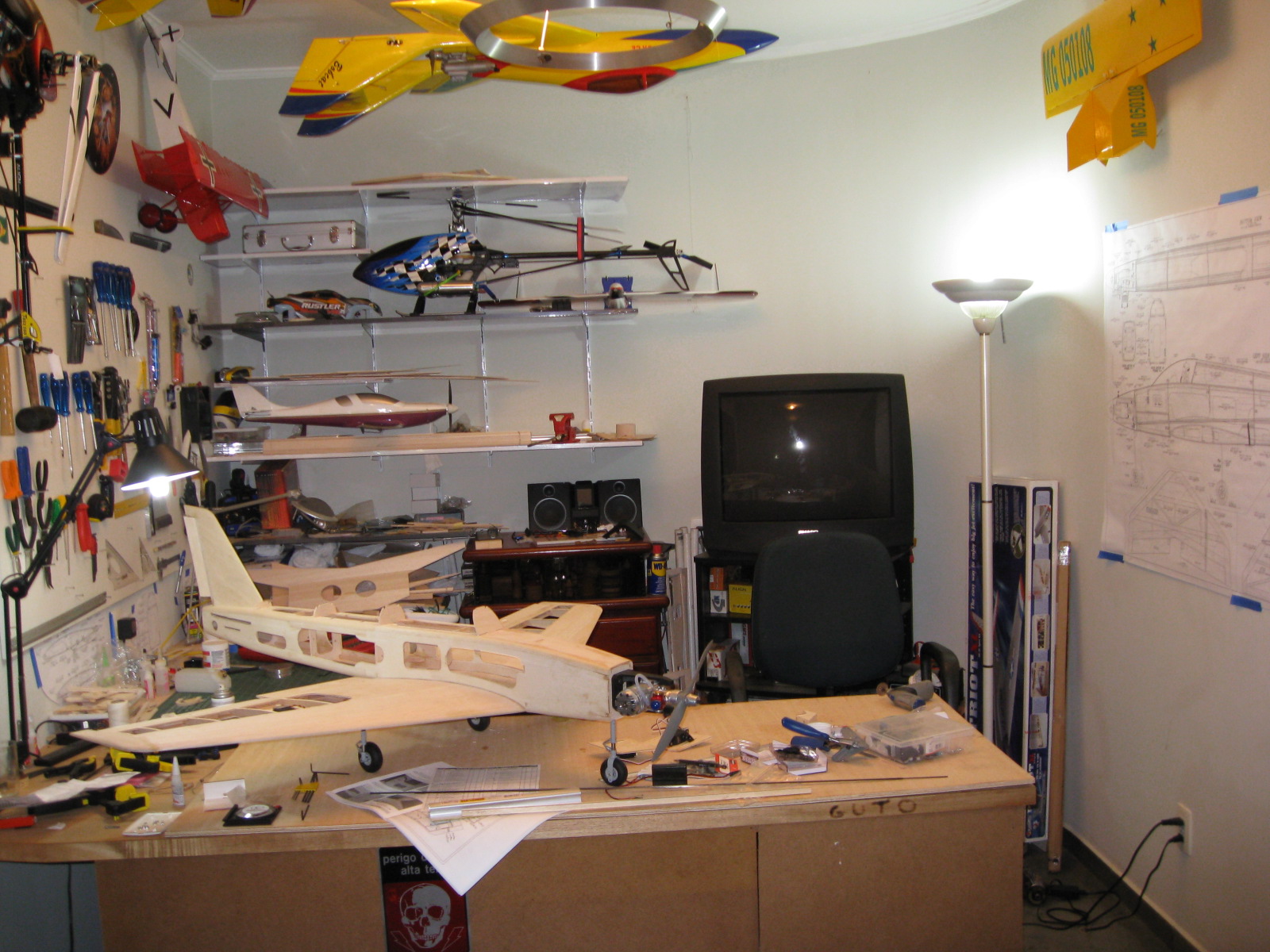

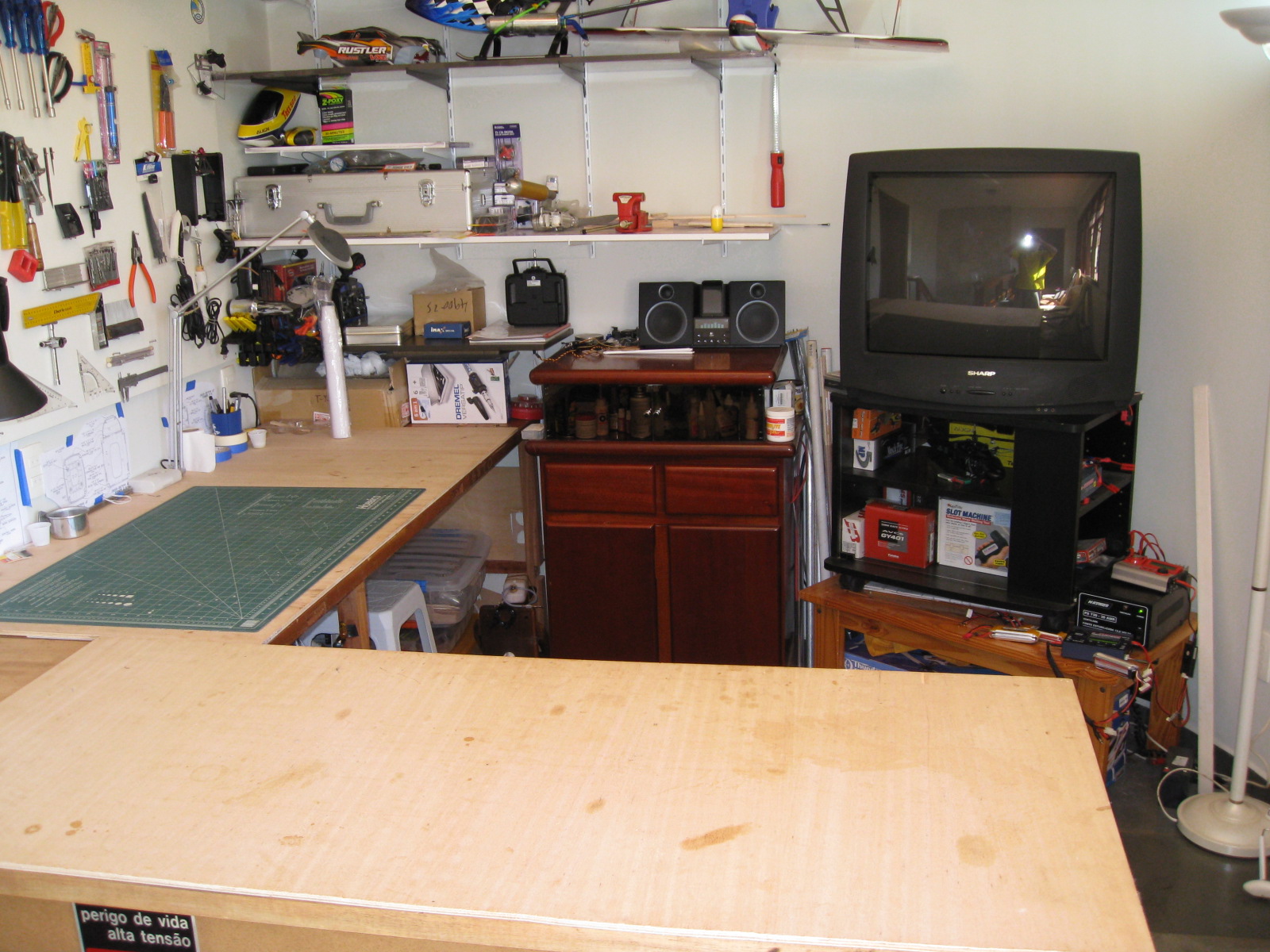

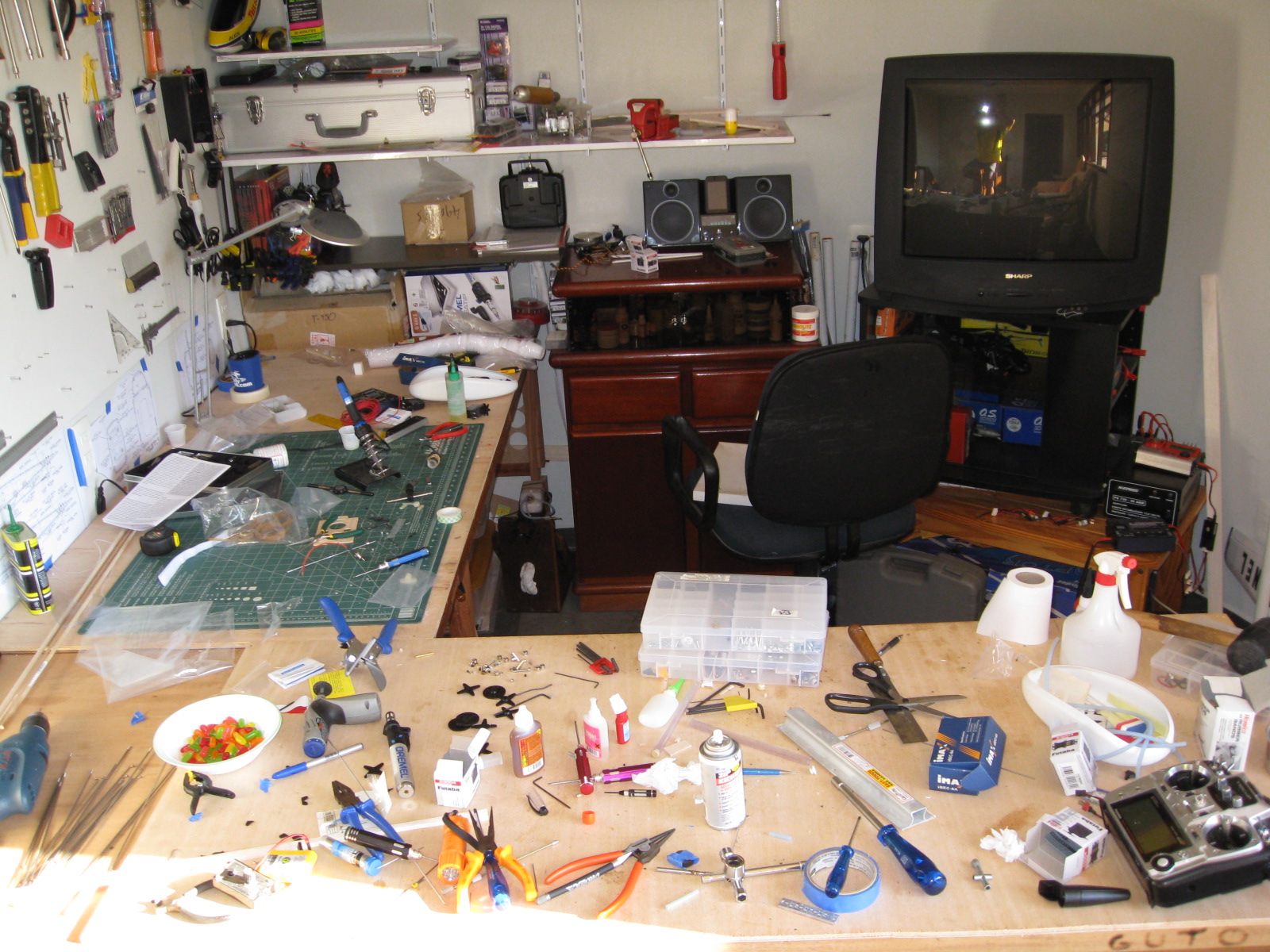

Here is mine!
Not the bigest, but I have a Hargar room to keep the big birds at, and this way I only work on one model a time.

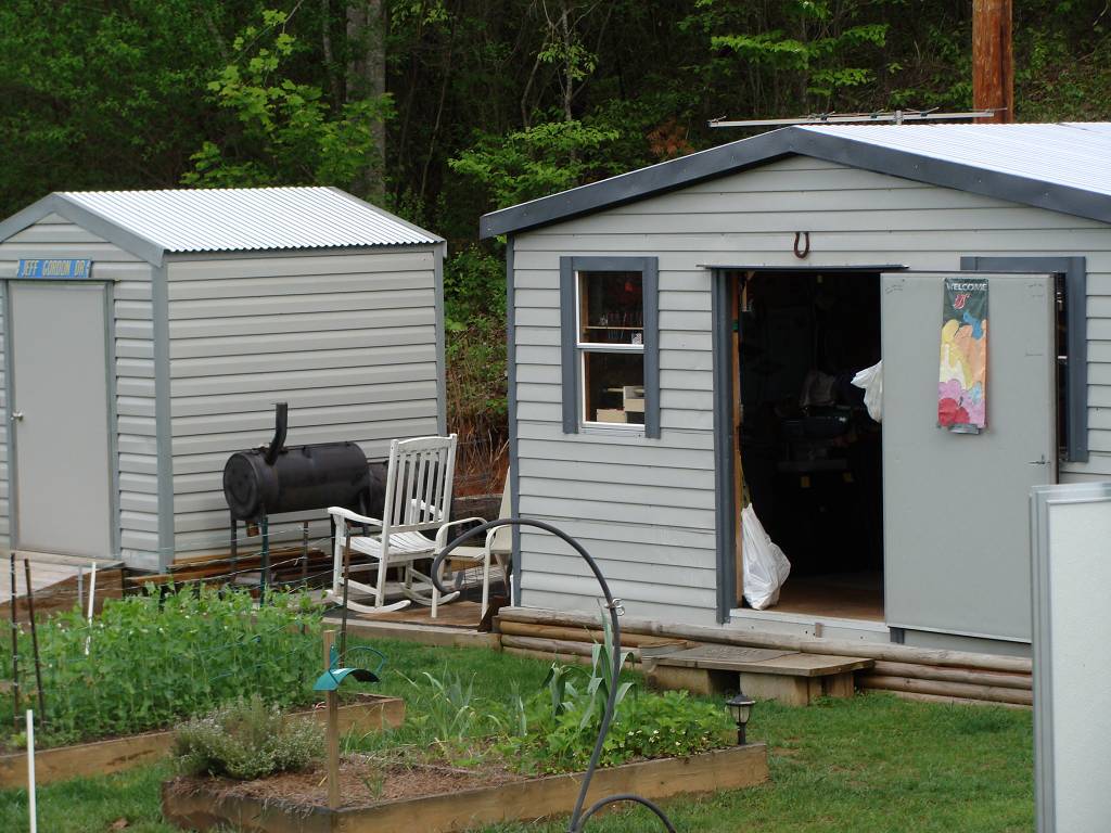

I'm going to play without pictures as I suck at drawing and you didn't want this to become a show me your shop thread.
1: Workbench without legs. Makes it easy to sweep up and cleanup. Benches are mounted to the wall. I do have a building table in the middle of my shop but all other benches are mounted to the walls. The one exception is the single bench where my mill and lathe are. I have extra legs to help support the weight and keep things level.
2: Dust filteration system. Don't have it yet but I will have one very soon.
3: Electrical outlets on the front edge of your bench. Keeps the power cords out of the way and if you space them every four feet on your bench, you will always be within easy reach of power.
4: Small Fridge. Keeps the CA fresh but more importantly it keeps my Shiner Bock nice and frosty.
5: Sanding Table. I use to have a table with a peg board top and would hookup my shop vac while sanding. It was a great way to keep the dust down in my shop.
6: Shelves and sealed storage bins for all your bits and pieces. Keeps things organized and all the balsa dust out.
7: A dedicated hangar space for all completed planes that doesn't intrude on your building area. Having to shuffle things around constantly while building is a real PITA.
8: A spare folding table to lay all your kit parts and pieces on while building. Makes for more pleasant building and the table can be folded up and stored out of the way when not in use.
Oh Heck, heres some pics to give you an idea I'm talking about. Also found the origianl layout for the shop.
Bench with legs for machine tools.
Workbench with outlets on front edge and you can see these are built and supported soley by the angle brackets which makes it easy to sweep up without a bunch of vertical bench legs in the way.

Ted,
Thanks for your post. Yes, I didn't want this thread to be a place for guys to brag about their workshops but a thread where workshop ideas could be shared. As I mentioned at the beginning, I am in the process of designing my next house and I wanted to include a nice R/C workshop right from the beginning, instead of building the house first and then trying to make a spare bedroom or garage half work. Thanks for the drawing and the great discussion about what you did and why!
Your point about the legless workbenches to make cleanup easier is well worth considering. About two years ago, R/C Report magazine (RIP) carried a story by cabinet builder Tom Clark who adamently opposed open shelving in a workshop becuse of its propensity to collect dust and the difficulty of keeping open shelving clean. While Tom likes to enclose the undersides of his workbenches with cabinets (to provide storage space that won't attract dust and dirt) your legless workbench idea is a good compromise that makes cleanup easier but doesn't require building cabinets. By the way, Tom puts out an EXCELLENT book on workshop ideas that I highly recommend. While his book doesn't contain workshop floorplans (which is what I wanted this thread to be) it does contain a lot of neat ideas!
I also noted in your pictures that you had installed an airconditioner in your shop. While it would be impossible for us to work in an unairconditioned shop in the summertime around here (I did note your League City location), an airconditioner is more than just a comfort item. A shop airconditioner separate from the main house air conditioner also serves to keep balsa dust and dope fumes out of the house, which goes a long way towards keeping the peace in the family!

Great ideas, Tx_RcFlyer; I like the legless and outlets ones!
For a window AC unit like that, the vent should be kept open, so the fumes don't accumulate in the closed conditioned shop.
For a half blind guy like me, tons of light over the working stations is very important also.
