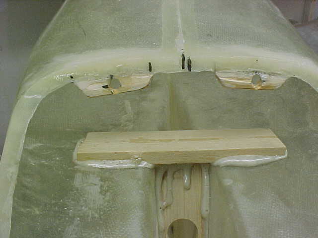

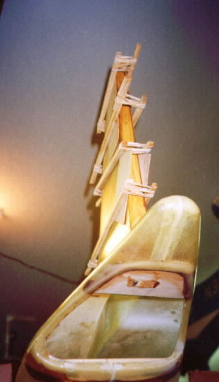

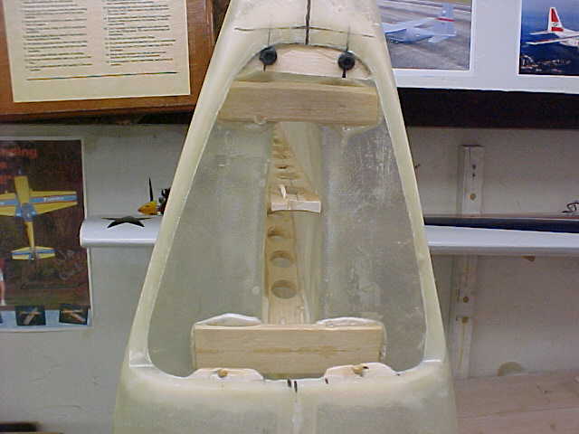

Ok guys, my class and work might be letting up enough to get back to work on the C 130. Randy, could you post a picture or of the wing and hor. stab. attachments (the guts). I finally put my nose gear in a few weeks ago.
BIG question..... what did you use for attaching the wing sheeting? I ordered another wing from Bob Sealy because I had so many problems with the Dave Brown product. I could use wood glue.. ir thinned down epoxy, but I need to keep it light.... suggestions anybody... just no dave brown junk.
Randy and Jim.... I was trying to get my vert. stab ready to put the stick up in it. any suggestions? My vert stab seems to be very wavy looking and wanted to know how you shped or filled it with wood? Do you have to put anything else up in it to keep the airfoil shape?

I check my pics on the stab and wing and send you something useful shortly. You're right on the stab, it's a little flimsy the way it is. Mine was sort of concaved in on one side. A couple stiffners will do the trick.

................I was trying to get my vert. stab ready to put the stick up in it. any suggestions? My vert stab seems to be very wavy looking and wanted to know how you shped or filled it with wood? Do you have to put anything else up in it to keep the airfoil shape?..............
Bill,
In addition to the trailing edge piece I installed in the vert. stab to put the hinges into, I made two additional pieces to hold the fin out and to also make it more rigid. If you study the two pics closely, you can see the two pieces runningup into the fin. The first piece goes straight up to the top of the fin. the other piece follows the slant of the leading edge of the stab, and intersects the other vertical piece. This is something that just takes time to fit. I used about 1/2 x 1" balsa sticks for this. After cutting the length of the stick to slightly more than the height of the fin, I drew a centerline on it and just started tapering the thing and fitting it to get it where I had a snug fit. I also used calipers to measure the outside of the fin and sanded the stick accordingly. They should fit snugly into the fin. I then used Probond to install them. That's the stuff in the pic that looks like foam, because that's pretty much what pro bond is. After those set up the fin still had some wobble to it from side to side. I put a plate across the opening where the fin meets the fuselage, and also probonded those in. that made the fin much more rigid than it had been.
You can also use the guide on the plans that was shown for the trailing edge piece to get started with.

I cut a spruce 1 " thick to the shape of the rudder post. Then I hollowed it out on my mill except for + / - 1/2" either side of the hinges. I made it about 6" longer than the tip of the rudder to the bottom of the fuse. I epoxied a plate in the lower lip of the fuse with a slot for the rudder post. This was a very tight fit and used a jacking screw to get it straight. I had to put the wing on first to get the rudder correct. I did notice there was more curvature on the left side of the rudder than the right. I do have pics and will try to attach them. The importance on the rudder was the jacking screw to precisely move it left or right. Hope the photos help. If you want details email me for specifics. [email protected] Jim

I did notice there was more curvature on the left side of the rudder than the right..................
Mine was the same way, Jim. After studying it, I didn't see any way that could have hardly been avoided the way it was laid up. I was however sure glad that the vertical stab was built into the fuse. Saved a lot of work fairing it in. I always have trouble with those areas.
