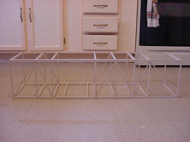

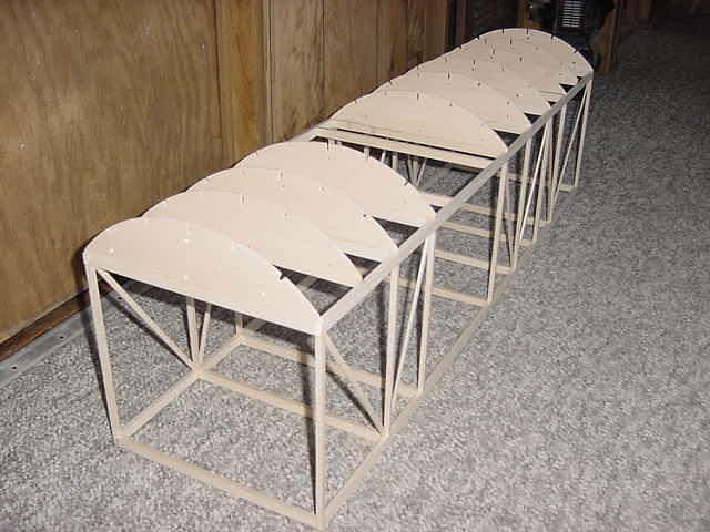

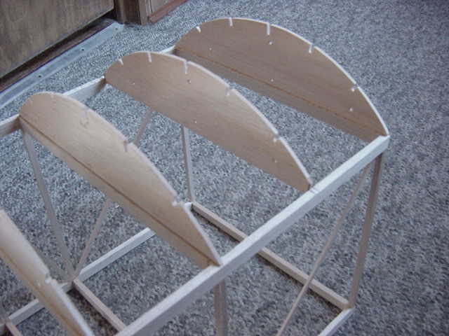

Here is a little of what you will have to do.

Mark.
Which is the error that has the plans?
Old 04-16-2004 | 07:12 PM
  #414
Joined: Jan 2004
Posts: 73
From: Licking,, MO
Default RE: Pics of C-130 gallery
So far, I have found, the nose has a piece of plywood butted against a piece of balsa to connect together. I did not make my nose the way plans call for, and have not finished it, so may have even more changes compared to plans. Can you email me at [email protected]?
Mark

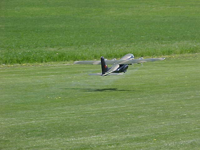

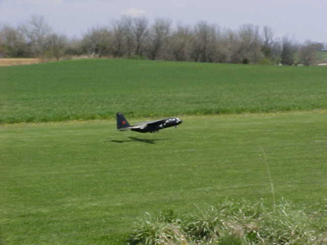

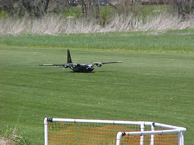

Finally, a decent flying day. Despite a few occasional gusts, pretty good flying. Got a flight in on the AC-47, and two flights in on the Herk. Pictures attached. Landing pic a little blurry. Everyone impressed with the scale looking take offs and landings. I found that landing with a little more power on really helps. It will settle in nice at about 1/8 throttle. Had to clean grass out of fuselage. You'll have to get used to that unless you close in your wheel wells, which may prove to be dfficult and still work on the gear.
Randy

Randy:
Nice.
You didn't raise the gear on these flights? Or just missed pictures with wheels retracted?
Bill.
Old 04-18-2004 | 09:54 PM
  #417
rryman's Avatar
Posts: 986
From: Loris, SC
Default RE: Engine tests/Range test complete
I didn't put in retracts--yet. I have plenty of room to install them if I figure out a way to build my own main retracts. The Palmer plans show some, but I haven't really studied them that close yet. I think I could probably come up with something on my own sooner or later.
