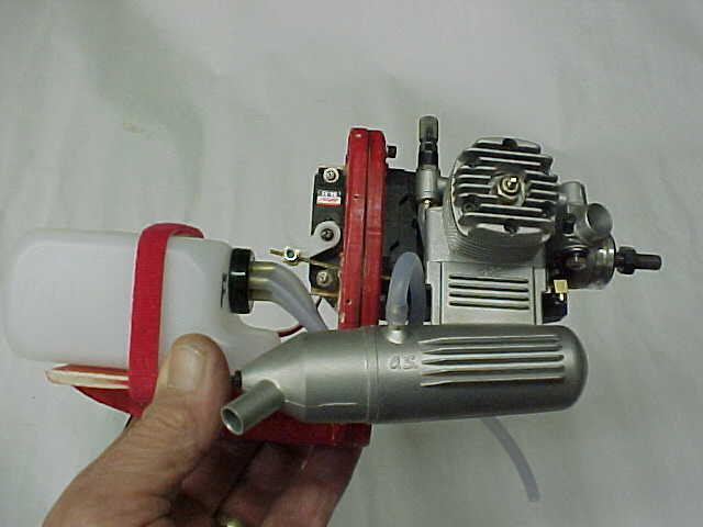

I noticed rryman that you just bolt the fire wall right on to the front of the rear nacelle half. Any problems with the screws tearing out or is the fiberglass in that area strong enough??..................................
Hawkpilot,
I have had no trouble so far with the arrangement I made. I did have two screws loosen up on one nacelle some time back, but I believe that was due to an out of balance prop. I guess I just "assumed" that they were in balance when I put them on, because I don't believe they just got out of balance from flying. Anyway, here's a pic of how I did it so you won't have to rummage back through all the threads. I basically made two 1/4" firewalls. the rear one is bolted to the nacelle with DuBro #2 button head screws. (a lot of them!) The engine mount is bolted to the front firewall, which is in turn bolted to the rear firewall. the cowling is bolted to the front firewall also. I did this so that if I had to change the thrust on any engine, I could shim between the firewalls to make any corrections, and the spinner would stay centered on the cowling, since the cowling would follow the adjustments. (I hope that made some sense!) Anyway, as it turned out, I didn't have to change a thing, the bird flew off the ground perfectly and I haven't changed anything since. So, if I take out the screws in the back firewall, the entire engine pod, fuel tank, servo and all slides right out of the nacelle, without taking off the spinner, prop, cowling, etc. Like you said, everyone has their own way of doing it, and they all probably work equally well. I'm just a nut about having to get to things I guess. Some of Murphys Laws:
1. Access holes are always 1/2" too small
2. If they are the right size, they are in the wrong place.
3. The least accessible part will be the first one to fail.
I have lots more pics if you need a shot of anything. This B-24 I'm building now makes the Herk seem like an ARF, but I'm enjoying the build. It's a well thought out kit.

Check a previous post and you will see the pics of my engine mount. The rails have not loosened and the vibration in minimal. The engines are very smooth when all 4 are running. The advantage of the rail is that it moves the stress point away from the engine and the rails provide a dampening effect to the sides of the nacell's which also helps to reduce vibration. I also used the black plastic type mount,, kraft I think. Only once have I found 2 screws loose on the rails. Consider there are 28 total screws for all 4 engines and only 2 were found loose. I did use blind (T nuts to some) on the back side. They are 4x40 socket head screws with a flat and a lock washer. I painted over the screws which makes it easy to tell when one is loose. The paint also acts as a lock tite. Jim

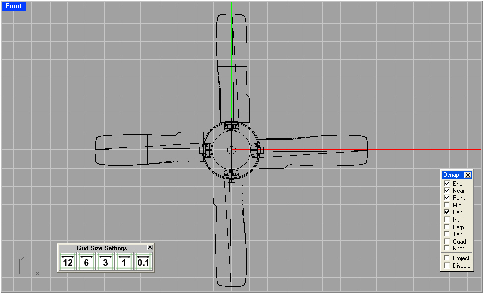

I'm having these made up for mine Palmer plans C-130 132"ws. Testing should begin in March. I'm using the RCV 90's
http://www.propellers.us/prop.jpg
http://www.propellers.us/prop1.jpg
http://www.propellers.us/prop1a.jpg

I think you are right about the multi blade props. If you look at the airfoil on the props in your pic and compare to MAS or APC you can see how you lose efficiency. This means more power to get the same thrust. Sorry I don't have the airfoil curves to show you. However if you get the air foil to match the better prop you can improve your multi blade results but won't match the same amount of thrust / power input, at least in the model category. The real herk used them due to high power turbines and limited space for a 2 blade prop due to engine spacing. (engine spacing,, sound familiar in relation to prop size).
You must consider on a model the time for blade 2 to enter the same airspace that blade 1 just left is very small due to the diameter and circular speeds. On the full size herk ( at least the E model as I remember ) THe 4 blade prop turns 1021 rpm,, much slower than a model engine and when blade 1 of the full size space is occupied by blade 2 a far greater time has elapsed and the blade has moved through the air stream much furthere. This allows for cleaner air and improves efficiency.
Hope this helps you with your work. Merry Christmas.. Jim
