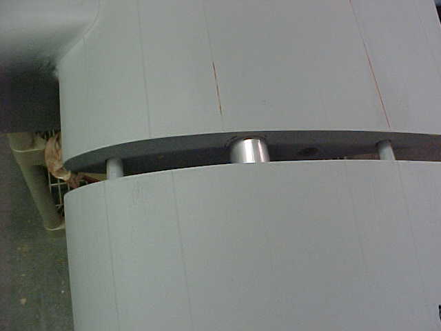

Well, after finding out that I won't be able to fit a one piece wing in my "real" airplane I am going to have to make it a 3 piece. The model field I fly at is located on an airport so most of the time I just fly there.
What did you guys use for wing joiner tubes? This is one thing I have never had to build or deal with. How do you secure them together so they don't slide apart? I already have the center section sheeted and done so I don't know if its too late or not.
Hey Jim, what parts did you use there for your flap linkages?
=========I got mine from Gator RC. $23.00 for the tube and phenolic insert that goes in the wings. It's really nothing to it.
========There's a couple ways to do it. I just used a nylon strap, sort of like a landing gear strap, and strapped it across the split. I mounted ply blocks in each side and tapped them into it. since you don't see the underside of the wing, it doesn't really show. Only time I've ever had it apart was during an inspection. Here's a couple pic of the tube and joiner. The wooden dowels are obviously to keep the wing tip from twisting. I also inserted hollow tubes in the wing tips for the dowels to slide into, so vibration, etc. wouldn't wear out the holes. Probably just the ply facing on each root would have been enough, but to each his own I guess

One other point.. I also bought the tubes from Gator R/c. I bought the 36" tubes and cut them in half.
I inserted a 2"x2" block of wood at the inside of the joining edge rib. THis was epoxied in place. I drilled/tap 1/4x20 hole and used a nylon wing hold down bolt and a 3" metal strap. If you have the wings sheeted you might have to cut into the bottom of the sheeting to insert the wood block. Not a big problem. Once you glass over the sheeting and paint it no one will ever know.
THis system is really easy to use. Bill watched me set up and it only takes minutes at the field. I put the fuse with wing center section in the pick up bed, then the wing ends in the cab. Set up is about 10 minutes total at the field.
WARNING.. I do tape the servo plugs from the wing so they won't pull apart in flight. Would not be a good thing to have no engine or aileron control..

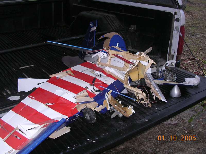

Just info on batteries. I have dual batteries in my Herk. Yesterday I was flying my Extra 300 and it went straight as an arrow into the ground. Postmortom found the battery buss strap welds were not full penetrating welds. The welds broke and the battery went to zero output. All flight controls of course remained in the last position of a cuban 8. Pic attached tells the results.
You might want to consider dual batteries. Also for those who might ask.. my Extra battery was very well foam insulated from vibration and the engine was on a Dubro Iso mount. Jim

The OS 1.2 had about $100 damage. The carb and air line has to be replaced. The true turn spinner and the dubro iso mount (both trashed) took most of the damage protecting the OS 1.2.
For dual batteries, I would make up a Y harness and plug both into the Y then the 1 into the bat. on the rec. I know someone might say you could short a cell and should use a diode. This is correct, but I have never had a cell short in flight but I have lost 2 planes due to the buss bar failing. The buss bar is what dual bat's would protect. If you use 2 , 700 ma nimh packs you would have 1400 ma available and if the buss bar failed you would still have 700 ma which would allow you to continue flying. You can dected the buss bar when you cycle the packs. Cycling would show one pack at zero volts if the back were to open up.
Just thoughts,, currently as per photos,, I haven't used dual packs,, at least not yet. Jim
