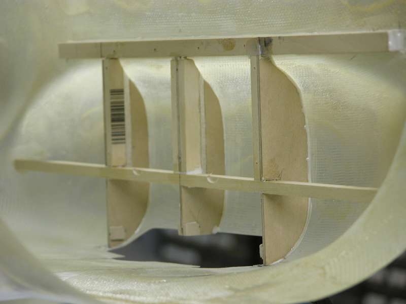

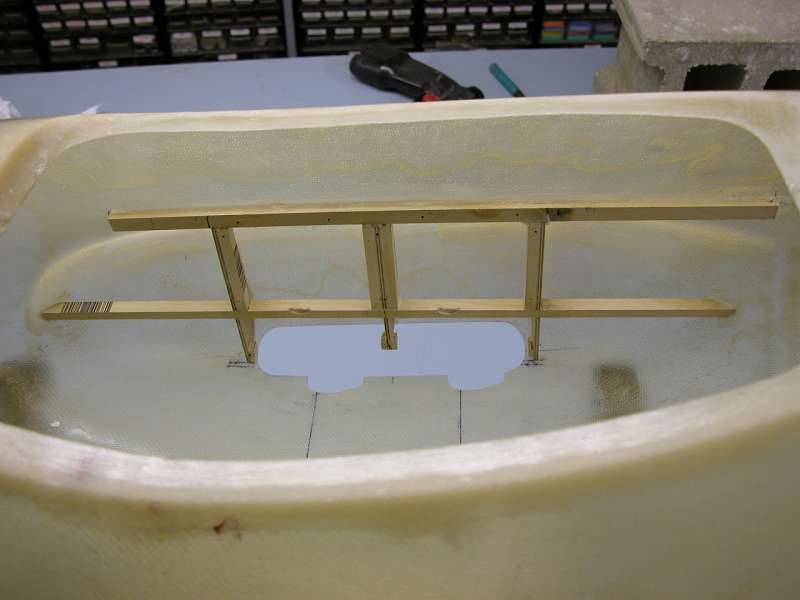

You right Jim. I'm Just getting started. A step by step sequence shots for those who might want to do something similar.
The sketch shown is what I'm planning to do. The red is 2 formers (one at the LE and the second at the TE) The green shows two cross members.
Gunny

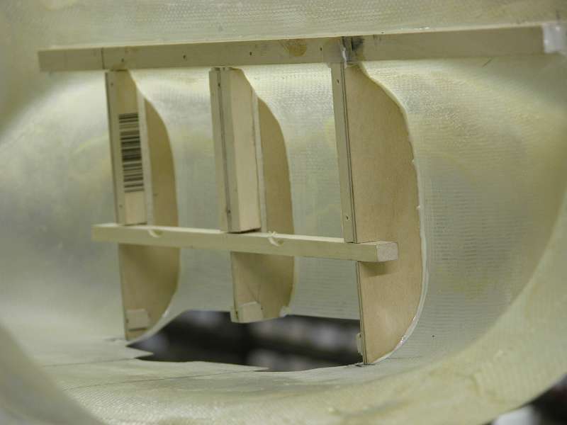

Progress:
Pic. - 1 When glue has cured, remove plate.
Pic. - 2 Remove temporary guide rail.
Pic. 3 & 4 Cut, fit and glue in actual lower rail. (1/4" x 3/8" hardwood)
More to come.
Gunny

Gunny, the supports look good and should work fine..
One other thing I did was on the floor under the landing gear box I installed 2 ,,,,,,, 5/16 x 5/16 x 36" spruce running length wise and then fiberglassed over them. When I was building the bird and put the wing on the fuse with the gear box screwed down (temporary setup) the floor of the plane had a lot of flex so I put in the spruce to spread the gear load over a larger area of the floor. If you would like a pic. let me know. Jim

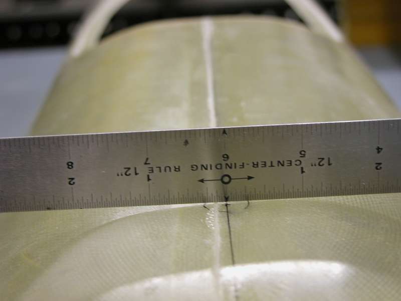

Gunny... Where can I find one of those center finding rulers? That thing was pretty neat... and I could use one right now!

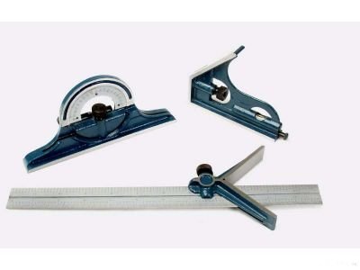

Default RE: 130 Flaps
Billy:
It's a "Machinist's" or "Combination " square. The complete kit has an adjustable protractor, a 45 and 90 degree clamp, and the center finder.
Without the adjustable protractor they are available for realy low prices with equally low quality, but more than sufficient accuracy for anything you will need. Even find them in the 99 cent tool bins now and then.
A complete set, with an engraved scale and so forth runs close to $200 from Lufkin or Brown and Sharpe, a Starrett square would cost even more.
The Japs are making them in reasonable quality for lower prices, but even the Mitutoyo (best Jap preision tool maker) square doesn't have the feel and finish of a good Brown and Sharpe.
Bill.

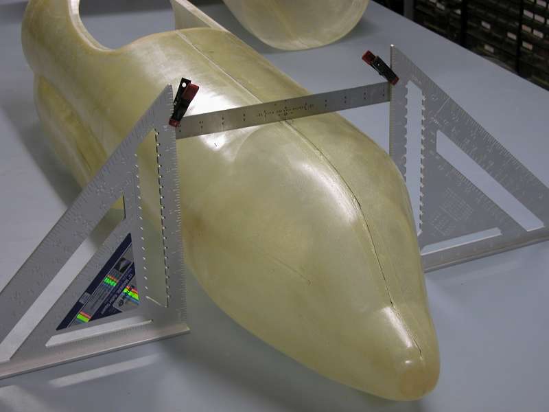

Bill,
I bought just the center finding ruler I think at sears or ace hardware for a couple of bucks.
Gunny

Old 02-09-2005 | 01:08 AM
  #891
Posts: 20,205
Received 20 Likes on 15 Posts
From: Mary Esther, Florida, FL
Gunny:
That's a different animal entirely. Must have missed your post showing it, or old age made me forget it.
I'll have to get one of those for myself.
If I can remember to.
Haw.
Bill.

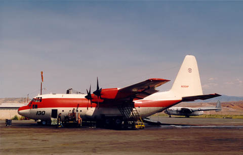

let me try to get the camera charged up. I have ordered a new one. I painted the fuse for the last few days.
here is the link to the picture
[link]http://www.feuerwehrpresse.de/e-wildland.html[/link]
[link]http://www.ruudleeuw.com/greybull.htm[/link]

Here are a few more of the pictures of the paint scheme. This was the T-130 that the wings folded on in 2002 I think. There is a link to the video of it on one of those links in the above message.
