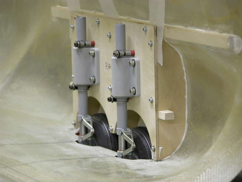

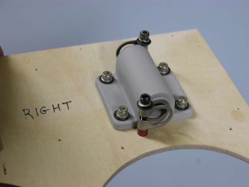

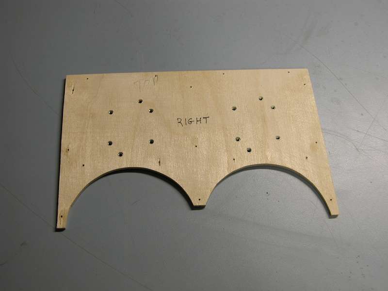

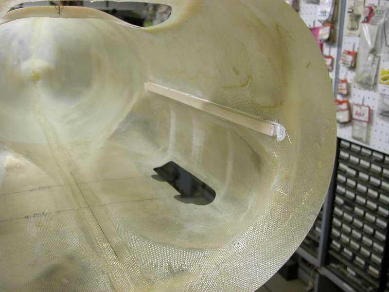

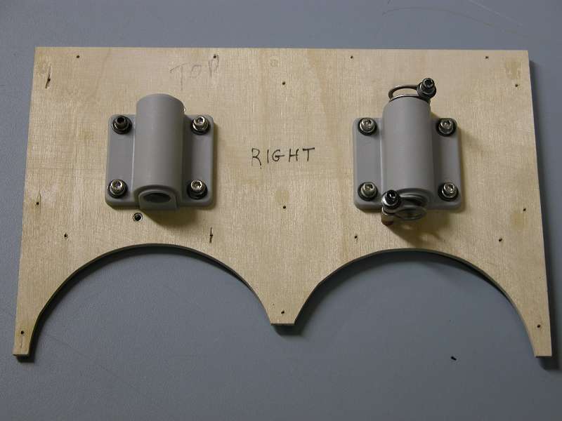

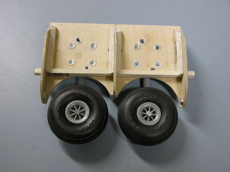

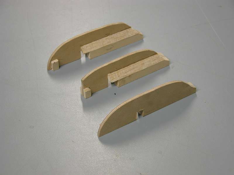

Update: Main landing gears. (My own design)
Pic. - 1. Upper railing (1/4" x 3/8" hard wood) glued to fues. at the top edge of the "hump" in wheel well.
Pic. - 2 & 3. Main landing gear plate. (1/8" birch ply).
Pic. - 4. Three wheel well former assemblies constructed from (1/8" ply, 1/4" x 3/8" hardwood and 1/4" balsa tri. stock.)

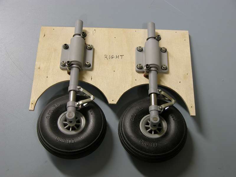

Pic. - 1 & 2 show mounting of the Robart strut mounting blocks and mounting clamp rings.
Pic. - 3 Robo Struts and wheels installed.
Pic. - 4 Former assy's. screwed to landing gear plate with a temporary alignment guide rail.
To be continued:

I bought The following for my c-130 "Robo stuts all around":
(5) #650 straight robostruts 3/8" --4 for the mains and one for the nose---------------------------$44.95 ea. total--$224.75
(5) #654001M mountings blocks----to hold the robo struts to the ply side plate---------------------$11.50 ea. total--$ 57.50
(10) #654003M steering arm yoke-8 clamped to the mains & locked to the side ply plate.
2 for the nose strut not clamped to anything so it may steer--$ 1.65 ea. total--$ 16.50
plus their shipping and handling charges-------$ 8.00
So the total gear strut assy. cost me just over $300

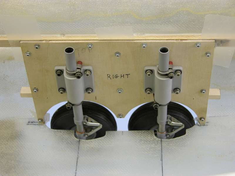

Pictures showing the "truck" wheel assy. being glued to the fues. / wheel well sides. The top row of 4 screws clamp the assy. in (to the top cross rail) while the bottom is tack CA'd to "clamp" the bott. end of the truck. In a nut shell. The 3 former assy's. are being glued to the fiberglass and to the top rail. The plate is removable.
Stay tuned.
Gunny
