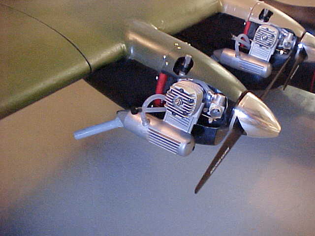

Old 01-11-2004 | 11:53 AM
  #173
rryman's Avatar
Posts: 986
From: Loris, SC
Default RE: Flap Space
Regarding the oil blowing on the fuse, I have installed the Du Bro rubber exhaust deflectors, hoping that it will keep some of it away from the plane, but really can't tell what will happen until it flies. I suspect Jim is right, that the prop wash is going to plaster it all over the place. I have had some cases where putting on the deflector made it worse, I think by the fact that it collects the oil and rather than getting blown out in a spray, just blows off in drops and more of it gets on the fuse, stab, etc.
Randy

Old 01-12-2004 | 02:46 AM
  #174
gunny11's Avatar
Joined: Dec 2003
Posts: 1,001
From: babylon, NY
Nice picture of the engine nacell.
gunny
