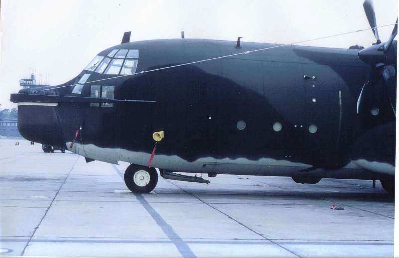

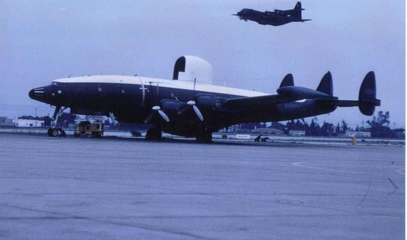

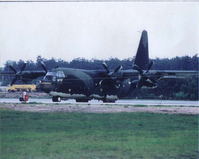

Thanks for the pics- I'm familiar with both those aircraft. The Connies flew out of Udorn Thailand when I was there, and several guys on a vetrans net I'm on were pilots/crewmembers on them.
The Herk with the whiskers has the Fulton Recovery System on it, right? I used to watch them practice pick ups in the 60's at England AFB, La. They used dummys then to test with. They would do a pick up between the active runway and the ramp. Interesting thing to watch. Somewhere out there is a model of that Herk, I've seen it on video, just can't remember on which tape. that should make a great looking model.

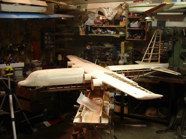

On the left of the pic you will notice a laser level, guys, I must tell you this is the neatest toy I have ever had for building big models, it transmits a bright horiizontal and vertical line, I jig the bird up and you can "shoot" in all your frames stringers, wing incidences, tail planes are a cinch, you can be sure the rudder and elevators are in perfect alignment, I set it up in front of the bird and line up all my motor mounts , the good ones . with the tripod stand sell for less than $100, Mike

Very nice picture of your bird under construction. Gawd it makes me shiver as to how far I have got to go. LoL. But exciting. Thanks for the view.
