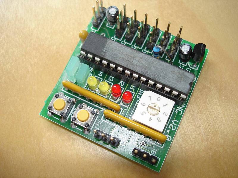

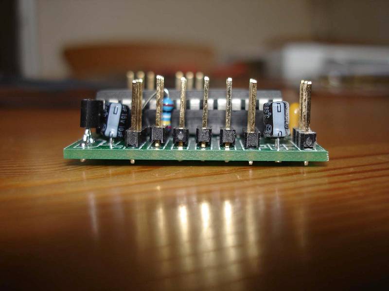

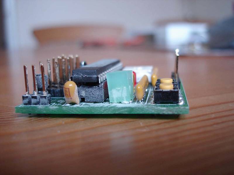

  #380
Sarah's Avatar
Posts: 168
From: Bristol, UNITED KINGDOM
Default RE: Eletronic engine syncronizer **SUPPORT **
Hi Bill,
I've received my Twinsync and I'm concerned about the soldering of the servo/receiver connectors and the LED's.
The connectors were not fully inserted when soldered as shown in one of the photos below. Also there is solder around the LED legs on the topside of the board and a white deposit on some of the components, including the servo/receiver connectors.
I'd be grateful for your help with this problem.
Regards,
Sarah Frazer

Old 07-13-2007 | 05:10 PM
  #381
Joined: Jul 2003
Posts: 551
From: Raleigh, NC
I have had a couple of reports of soldering issues in one batch of units that has been addressed. I will be glad to replace the unit if you would like but it is most likely just cosmetic since all units are tested. As for the white power it is fiberglass dust from when the pannels (of many devices) were cut up. The units are now being alchol washed after cutting in the assembly process.
Let me know if you want your unit replaced. [email protected]
