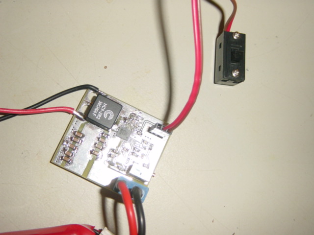

Glow driver circuits are very simple. If you use a single cell NiMh or NiCd then it is a simple on off switch. If you want to use a higher voltage battery like a single cell lipo or 4 cell NiXX the you have to have a regulator to drop the voltage. The other option I have been thinking about is a high speed current limiter but that is too deep for a forum discussion.
So here is the problem with a higher voltage battery at 4amps. A linear regulator is going to burn/convert the voltage drop x amps as heat. So 4 Amps from a 4.0V battery delivering 1.5V is a 2.5V drop at 4 AMPs. That is 2.5 x 4 which is 10 Watts. A TO-220 can only dissapate about 1.5W without sinking. A LM317 I think can only go up to 3A. Most are 1.5A. You should look at the LM338 which can go to 5A but at 5A with a 4.0V input and a 1.5V output you are going to have to convert 2.5V x 4A = 10Watts to heat. That is going to require a massive heat sink and fan. Even worse about 75% of your battery will be used to produce heat rather than light the glow plug.
The right way to do it is with a high frequency switching regulator that can run at >80% efficency.
Proabably too expensive for TwinSync glow drivers (i.e. ~$100 per pair rather than $50 per pair)...I am working with TBM to come out with so low cost high freq switching regulators but most guys don't understand the real value of switching versus linear regulators... this should prob be a seperate thread.

The way glow drivers work that operate off a high voltage (or how I would expect them to work) is that they pulse the glow plug on and off very rapidly. Similar to a switching regulator but a glow plug doesn't need a constant voltage like a piece of electronics. Regulators are more expensive than a simple pulsing circuit. This is similar to how a switching regulator works. It pulse charges a capacitor to the right voltage very fast. For example I am working on a turbine ECU. To drive the turbine glow plug I pulse it from the 3-cell lipo 1% of the time 10,000 times per second. I could change the glow drivers to operate on any voltage. Would probably make them $70-75 per pair rather than $50 per pair.
The advantage of a switching regulator over a linear regulator is that they can be >90% efficient compared with about Vo/Vi % effiecency for a linear regulator. They can be noisy and older designs are slow. New ones are amazing. I attached a picture of a prototype regulator I am building. It is about 1.5" square and can put out 15Amps continous with no heatsink required. Also has a safety switch (fails-on).
