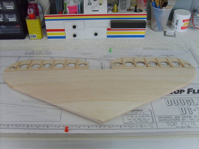

Old 04-30-2009, 04:35 PM
gblas777
My Feedback: (13)
Join Date: Feb 2002
Location: lewisville, TX
Posts: 513
Default RE: Ziroli DC-3/C 47
ok i had a little time before work today to start this project so heres what i got done on the horiz stab

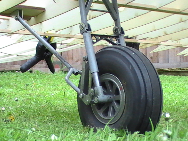

How about a semi scale tail gear. Parts out junk box,Comments?

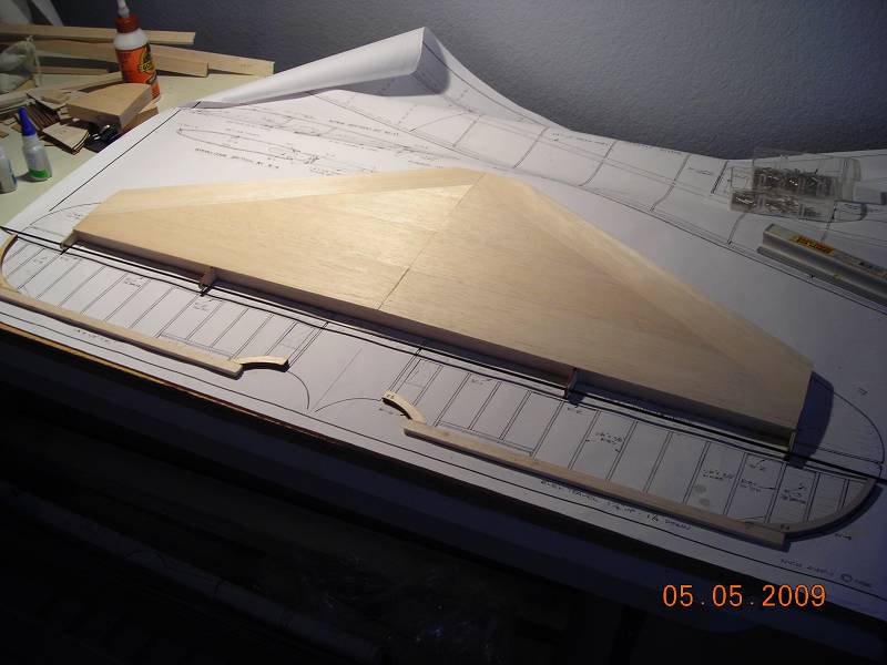

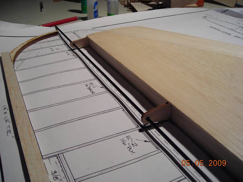

Old 05-05-2009, 04:18 PM
gblas777
My Feedback: (13)
Join Date: Feb 2002
Posts: 513

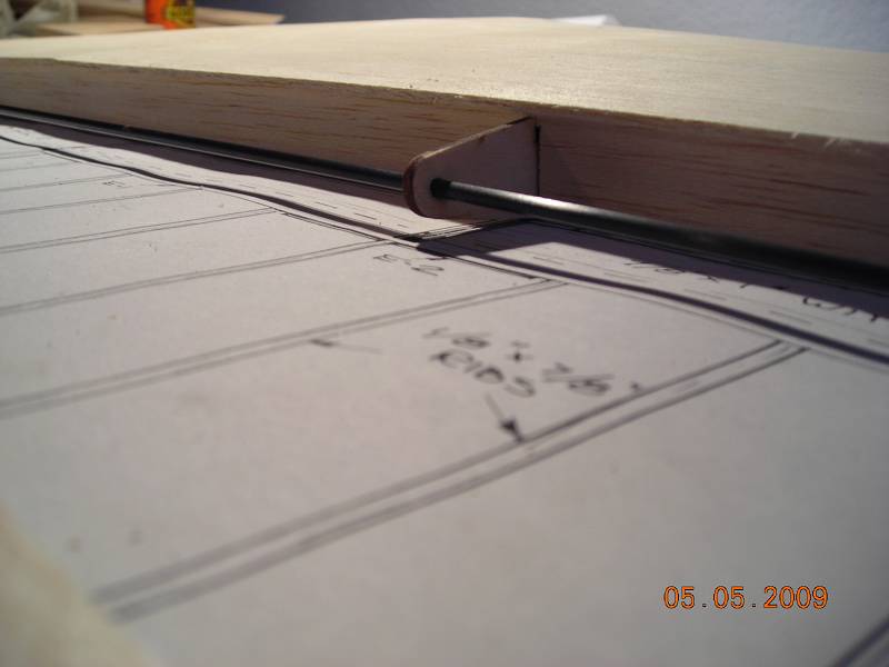

more progress...was slowed down a little due to the quality of the sheeting included with the kit..so far i would give the laser cutting of the parts a B+ but the sheeting and some of the wood sticks get a "D". the 3/32 sheeting for the tail is very rough. had to true all the edges for edge gluing and most of the sheeting is not of uniform thickness..so spent a good amount of time truing all this up...and some of the stock for the horiz trailing edge and elev leading is warped so bad its not useable in those areas.
in the pics got the horiz sheeted and the scale hinges installed.due to keeping the tail as light as possible the hinge pin in the pics is 1/8 carbon fiber rod. so much more lighter than a steel pin.the first major mod is going to be sheeted elevs instead of open structure.
feel free AL or anybody to post pics..the more the merrier
gene

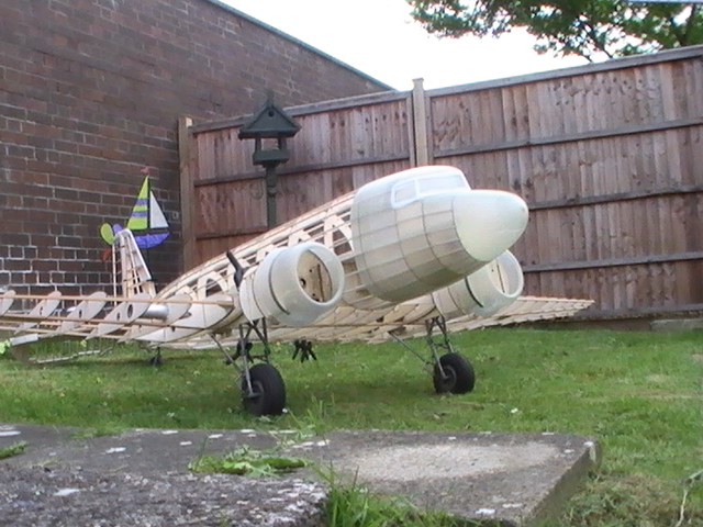

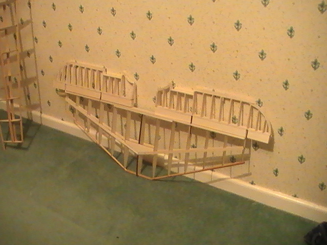

Old 05-09-2009, 04:02 AM
mozart03uk
Join Date: Jul 2006
Location: bris, UNITED KINGDOM
Posts: 11

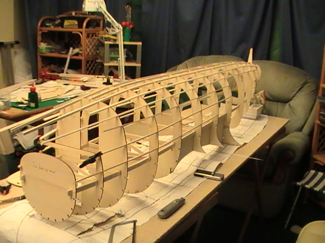

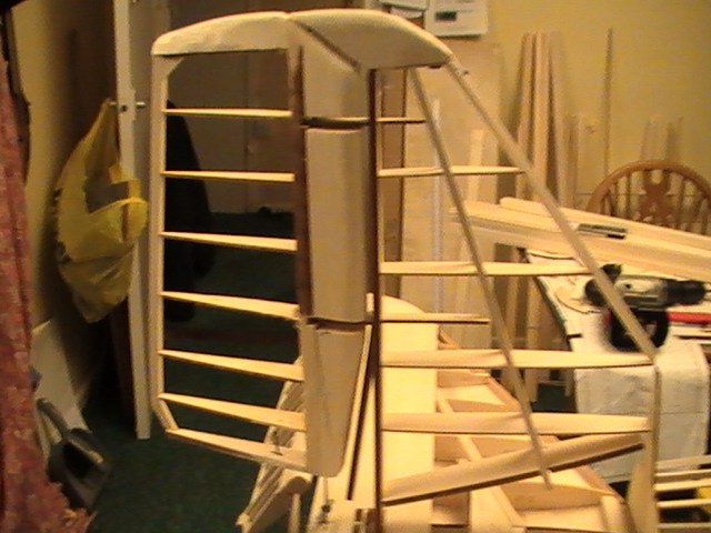

Hi ALL
Started building the ziroli dc3 back in feb this year
here's some pics
can any one give me some info on where to install the elevater sevos
are they in the stab or are they worked from within the fuze??
any help would be appreciated
Paul

Paul , I would mount the Elevator and Rudder servos as far forward as you can , The Ziroli DC3's tend to build heavy in the tail and usualy require a lot of nose weight .
I have mounted my servos just ahead of the trailing edge of the wing in the fuselage , and will have enough room to place the fuel tank on the CG forward of the servo's
I will try to post pics sometime this weekend.
Chris

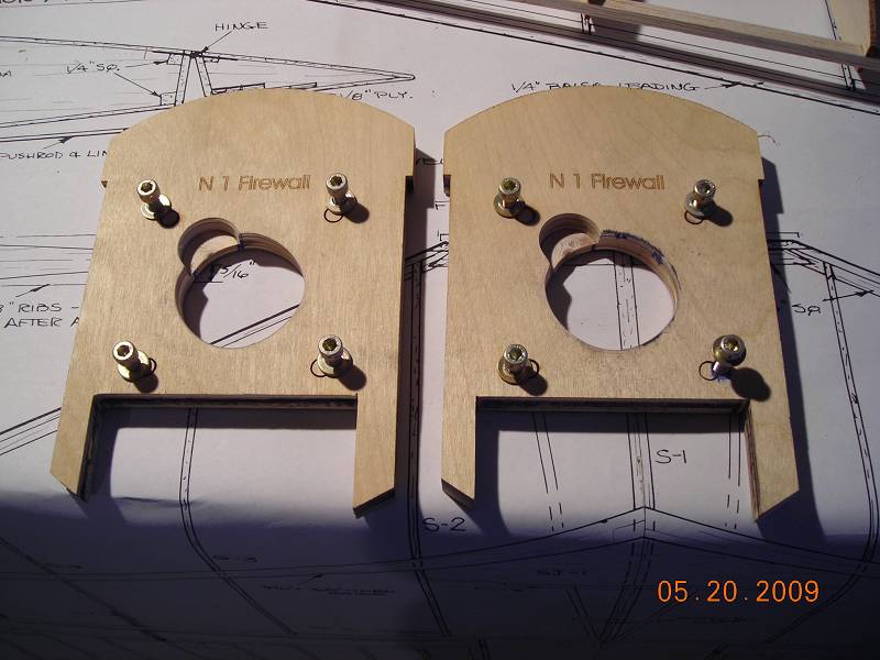

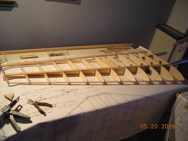

heres a little more progress....the outer wing panels are a pretty much a straight fwd build......extra care was taken when glueing the wing tubes in to get them absolutely straight and parallel......the center section shows where the fuel tanks and retract bottle will be mounted. eveything should fit inside the wing...they are 16oz tanks....one for each engine and a robart large air bottle.....enough room for all to fit inside the ribs and not interfear with anything....and last the 2 firewalls drilled for the g-38s and the relief holes cut for the spring starters..the engine is wide enough for the fuel line and throttle pushrod to run outside the firewall so it doesnt get in the way of the retracts which are mounted right behind the engines..more to come soon
gene

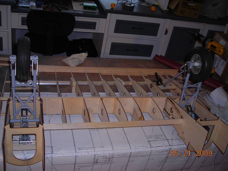

Old 05-26-2009, 08:17 PM
gblas777
My Feedback: (13)
Join Date: Feb 2002
Posts: 513
a few more pics of some progress...first is with the gear mounted...pretty straight fwd and fit well.....next is with the air bottle and the 16oz fuel tanks installed...an easy fit between the wing ribs...the whole idea is to make the wing self sufficent with the only connection to the fuse is four leads for servo connections.
hows yours coming along AL. any more progress
