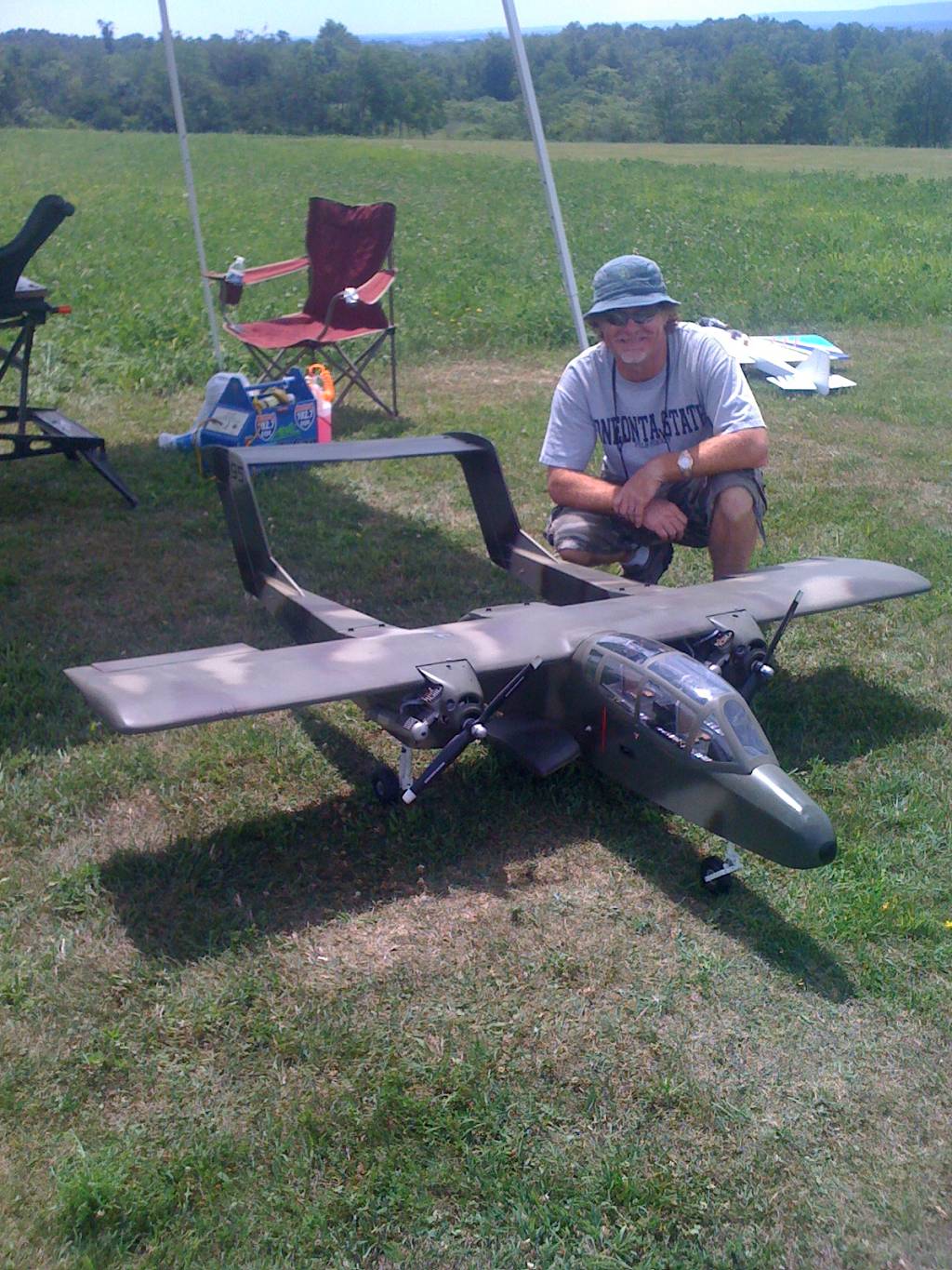

Been flying twins for years and never used one. Keep the engines slightly rich, and as everyone else had suggested, bring the leaner one down (rpm's) with a few clicks. You can hear the engines sync up. I ALWAYS hold the plane verticle for at least ten seconds to check fuel draw before I fly.
