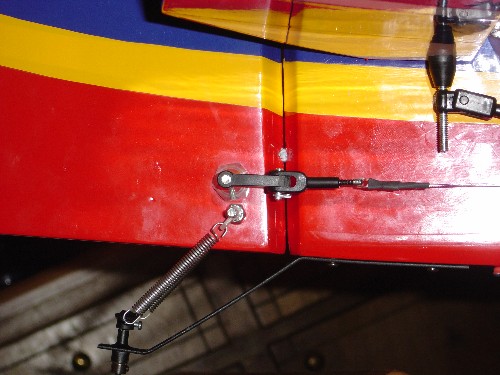

Did any of you buy the Hardware Kit/Pkg for the Wildhare Edge? If so, what did you do about the supplied Dubro HD Control Horns that come in the kit?
The manual says that if you use these supplied horns (which are too LONG), you have to drill new holes to move them back and get the linkage to line up with the hinge point. First of all, if this is the WH supplied hardware kit, why in the heck don't they line up with the holes pre-drilled in the ARF? [:'(]
Second of all, you can't drill new holes further back, since the hardpoint block doesn't go back that far. I'd have to strip the rudder covering and build more wood into the rudder, hoping to make it blend in smooth after recovering! [:@]
It just seems to me if you're going to sell a hardware kit for your own plane, you'd either sell a kit that fit the ARF as is, or build the ARF so that it worked with the Dubro hardware you're supplying. I for one do NOT want to strip covering, add more weight in the rudder and have to recover.
Nor do I feel that it's fair to expect me to go out and buy something different that DOES fit properly, after paying $75 for a kit that was supposed to do the job. Am I missing something here? I apologize to Tom if I'm missing something, but I don't think I am.
The kit also comes with short Nelson horns, but they are too SHORT. I take it those are for the ailerons and elevators, which I haven't even looked at yet... hope THEY line up. [X(]

I used the HD horns, DID NOT MOVE BACK AND REDRILL HOLES IN elevators and ailerons. Place bolt in hole provided, then measure to to hinge line and drill new holes in the horns, grind off excess horn and you got it. No big problem.
I know of no GIANT ARF thet is supplies with bolt-on, no work, no thinking, hardware. I have built three (3)Wild Hare planes using the supplied hardware and have not encountered any problems.

The supplied hardware kit is off the shelf supplies packaged up so you won't have to go looking for all the hardware as you discover what you need.
as for the rudder pull/pull arms being too long, the metal screw is NOT the part you move back. You still put the screw throught the hard point, but you drill holes in the two black control arms in line with the hinge point. then trim away the excess control horn with a dremel or such.
The Nelson arms are for aileron and elevator.
Ditto Wayne. I actually think dubro made them that way on purpose so you can adjust them to fit most anything. Takes about 10 minutes. [PS: WH is not talking about re-drilling the control surface hole. They are talking about drilling a new hole in the plastic arm] As to the Nelson horns on ailerons and elevator - lining up with the hinge line is no issue at all unless you are using some ancient, noncomputer radio. Just adjust your end point travel. Take a deep breath Neo, it will be ok.

See NEO, you have no problems, you just needed clarification and guidance.
