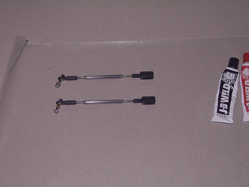

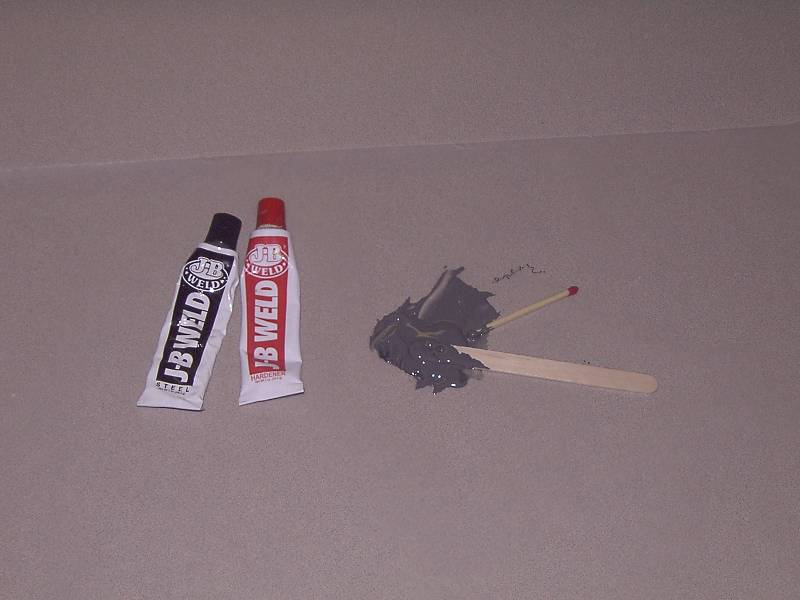

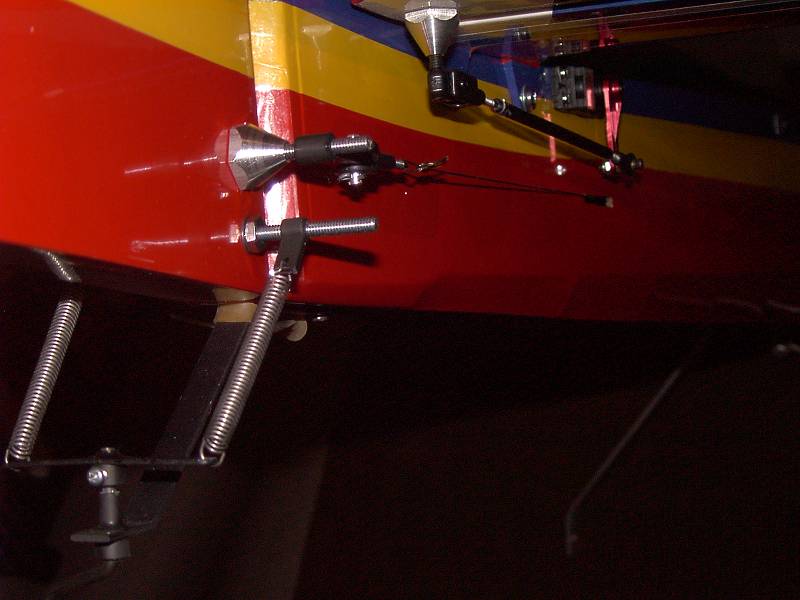

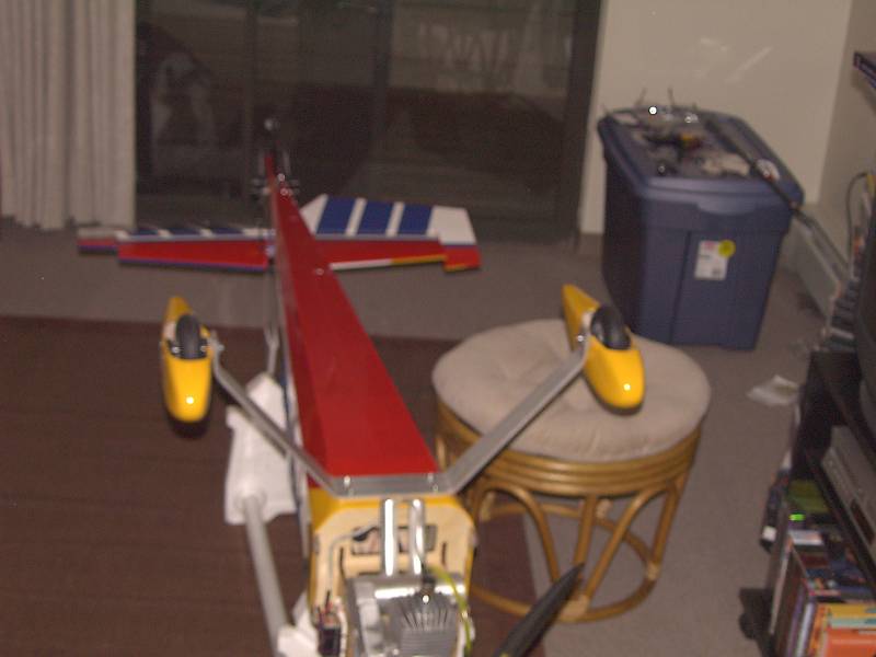

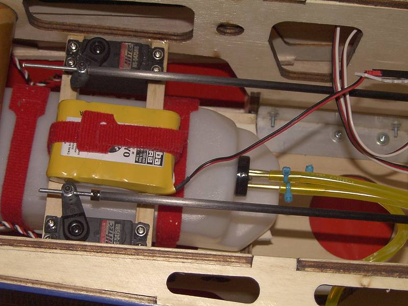

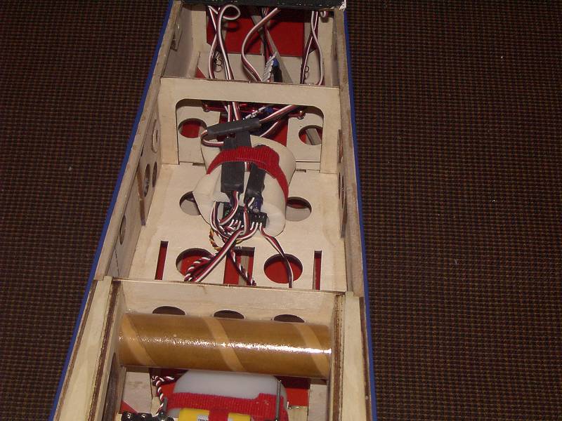

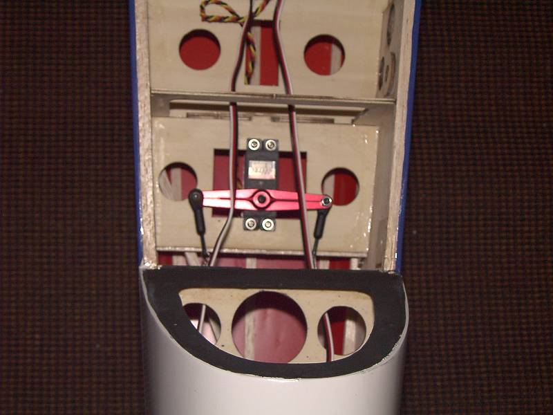

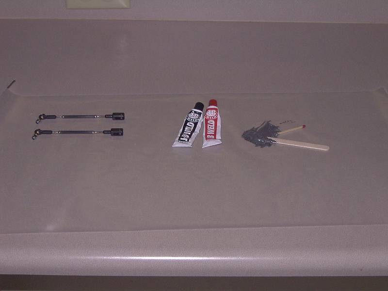

The glue had cured on the elevator pushrods so I got those put on. I tried setting up the pull-pull cable, but the cable broke. I think I may have put a bend in it trying to get a small loop. Are my loops too small? Oh, and I was talking about the DuBro connectors that go on the control horns and have a set screw.

Our very first hardware kits used those Dubro kwik links, but I learned of two problems very quickly.
The little slide locker is so thin it will straighten out the first time you push on it. Worse, the little pin is just pressed into one side. When you push it out to clear the servo arm it almost always falls out on the floor or in the grass. It's so tiny that it gets lost and there are no spares available.
That's why we use the Sullivan parts.

Ben,
Wrap a piece of fuel tubing (split down the side) around the pick up wire for better protection and then secure with a few cable ties.
The insulation could vibrate against the engine mount and be worn through.
Everything else is looking real good.

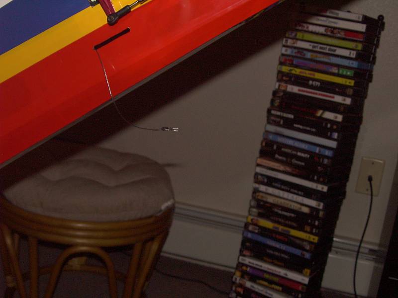

Thanks for the tip flier, I'll be sure to do that. I may just do a few inches since most of the wire is not near anything. Now, I just have to figure out what to do with the wire going to the spark plug. The Edge is almost done, I'm basically just waiting on the new wing panels so I can balance it. I have the plywood plates glued to the wheel pants. I need to add axles and wheels on the landing gear. Got the pull-pull going now that I got some more crimps. Radio for the elevators and throttle/choke is good to go. I have batteries and switches installed now to. Probably get the glue going on the canopy tomorrow.

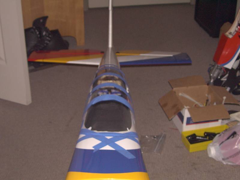

Ok, so I got a sudden burst of energy and did the canopy tonight. The tape stays on for as long as possible. The canopy glue takes a while to dry. If I get to test run the engine Sat., I'll leave the hatch at home. I usually give it a week before I subject it to any prop blast.

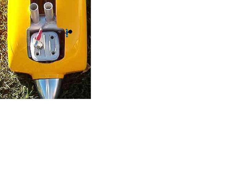

Ben your going to want to keep it from chafing on the edge of the cowl as well. I drilled a hole in the cowl for a rubber grommet to run the spark plug wire through. I streched the grommet over the plug boot. made a slit over to the hole and inserted the grommet. I dont have a picture of the finished install but this shoude give you an idea what i did. I put a small piece of lite ply, held in by 2 servo screws, on the inside where I cut over to the hole.
