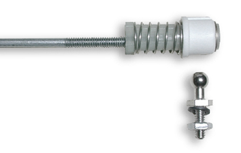

Just got my first Bunny - Extra 300 special with DA50R and was wondering what most of you are doing re the Choke connection to a servo. What do you do about the small arm on the choke? Wondering why DA did not put the same arm on the choke as they did on the throttle?

I just screwed a sullivan ball link to the stock arm. The link that comes with a plastic rod end that locks over a ball. Only drawback to this is the servo endpoint has to be turned way down. It works fine anyway. The other option is to grind off the end of the choke shaft. and remove the stock arm. Replace with a nose wheel stearing arm.

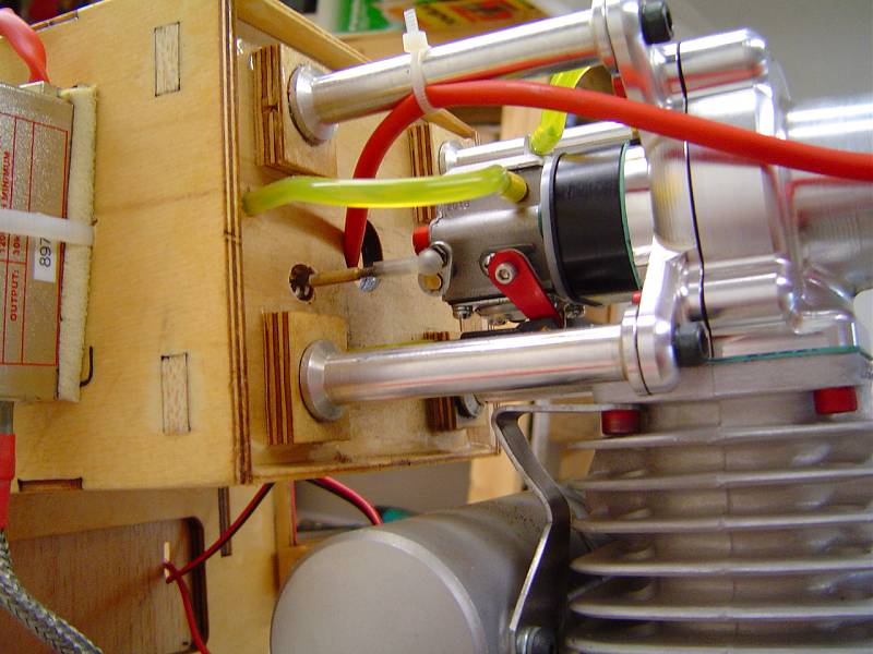

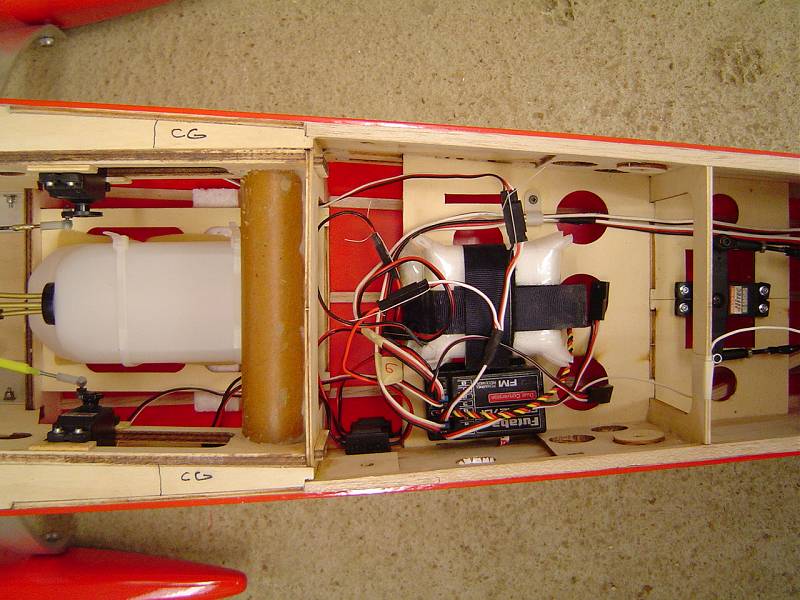

Here's a couple of pics to give you some ideas. Standard arm on the choke is no problem even with a std. servo. Plenty of power, just turn your ATV's down. My DA 50 is one of the older ones, so the carb is rotated 180 degrees from the new ones. I think the linkage is easier to install with the carb turned this way.

Thanks.. picture is worth a thousand words. I was thinking that the choke leaver was a little on the short side. Yes... the DA50 I have has the levers on the other side, but this will not make any difference.
