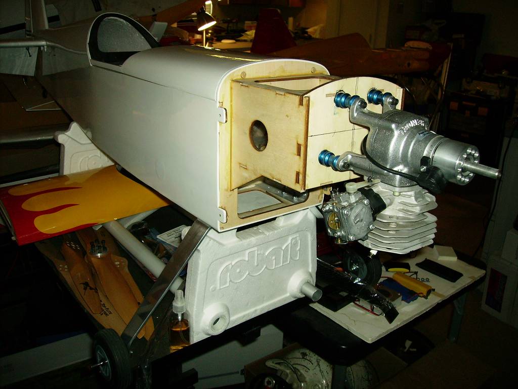

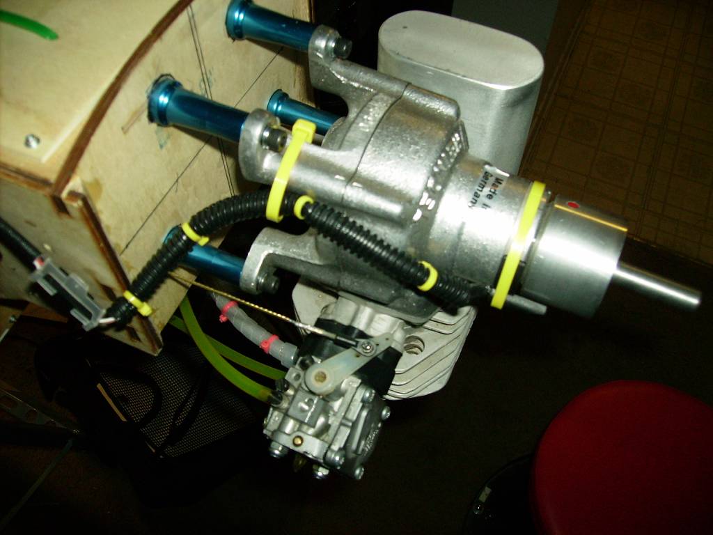

Can you give me all the details of your thrust, cg and other equipment placement like throttle and choke servo, batts etc.
I recently bought a used 85" Cap with a DA-50 and promptly gutted it as the build was sub par IMHO. When I got it, the throttle and choke servos were mounted forward of the first former(in the bottom of the motor box) and it has a good bit of lead stuffed behind the firewall. It also has a C/F spinner which I'd like to keep if possible for the bling factor of course.
It also had a bunch of washers to give right and up thrust, but I don't remember how many.

I'm sure this thread is dead but I just recently acquired an 85" Cap 232 and I too encountered the above triming issues. I purposely installed a known heavy powerful motor to A - test this motor and B- to have a good throw down plane for weekend hacking around.
I think Tom is correct you do need to plan and work a little harder to get the plane trimed like you want. I see no problems to get the plane to do what I need to do.
