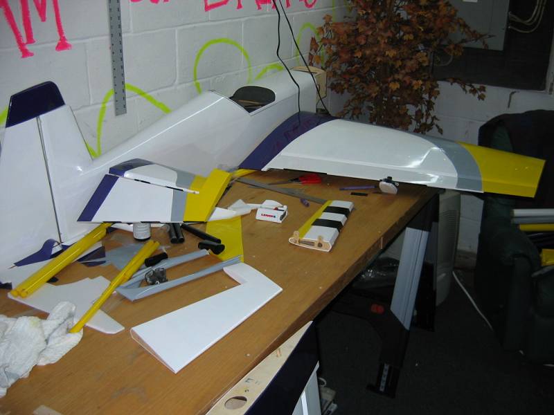

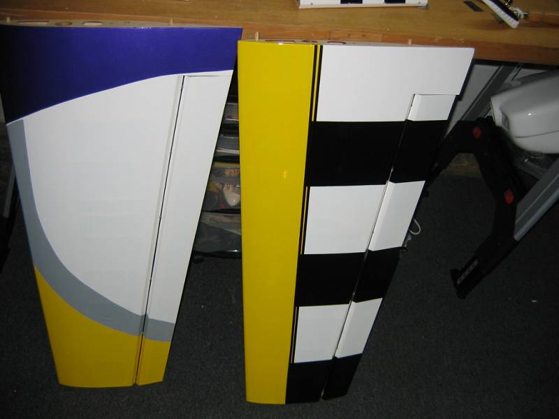

Well I thought I would share an update of the Cap..
I have mostly been working on the covering so far and havent started to glue anything yet. I am hoping to maiden her at our freeze fly on Jan 1st. Time is tickin away so I am hoping I have the free time to get her done.
Will be completed with the following:
Brillelli 54cc (prototype for the 366GT 60cc)
4 x Hitec 5645s
1 x Hitec 5955
NoBS battery setup
CF wing tube and spinner
Well here is some pics of what she looks like so far...

Old 12-22-2006 | 04:09 PM
Greg Cothern's Avatar
My Feedback: (8)
Posts: 611
From: Combine, TX
Default RE: 85" Cap
Looks great!! Like the scheme so far, are you doing anymore color on the fuse??? Just curious!!

Old 12-24-2006 | 10:30 AM
Jake Ruddy's Avatar
My Feedback: (40)
Joined: May 2005
Posts: 4,105
From: Bear, DE
Default RE: 85" Cap
Well might as well show you yesterdays work....
Plus everything except rudder is now hinged.
