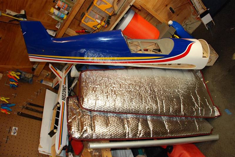

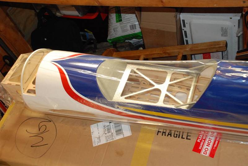

Well here we go, Another bunny ready for the skies. Didn't have the time to post along the way so I decided to ad the building pics in the video. But I thought I'd post a few anyway.

Tried that new trim method using Press and Seal. Really easy to do and looks killer.
Try this link to see full shots.
[link]http://picasaweb.google.com/salley2k/WildhareSukhoi[/link]

Wow! Nice, clean, install!
Haven't heard of the press and seal method. Could you set up a link to it?
Andy

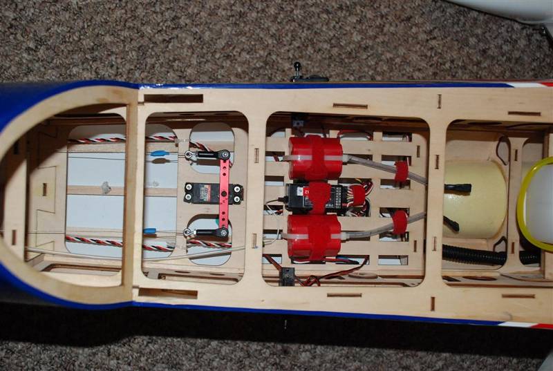

I had mine out playing with it today, still breaking the Brillelli 366GT in though. I'm just learning 3D, but this does a great Blinder, Flat spin, Inverted flat spin, Waterfall, and Elevator. The Elevator is rock soild with no wing rock, my Yak 54 rocks the wing 20*, the Sukhoi spins much better also, maybe video tomorrow. Flying in 28* is murder on the finger![:@]
I used neoprem vacuum tubing to hold the zip ties for the can works well, cost $3.47 for 7 feet, the silcone was $9 for a foot a the LHS.
Should have checked with me. I could have sold you the silicone and shipped it to you for less than $9.
