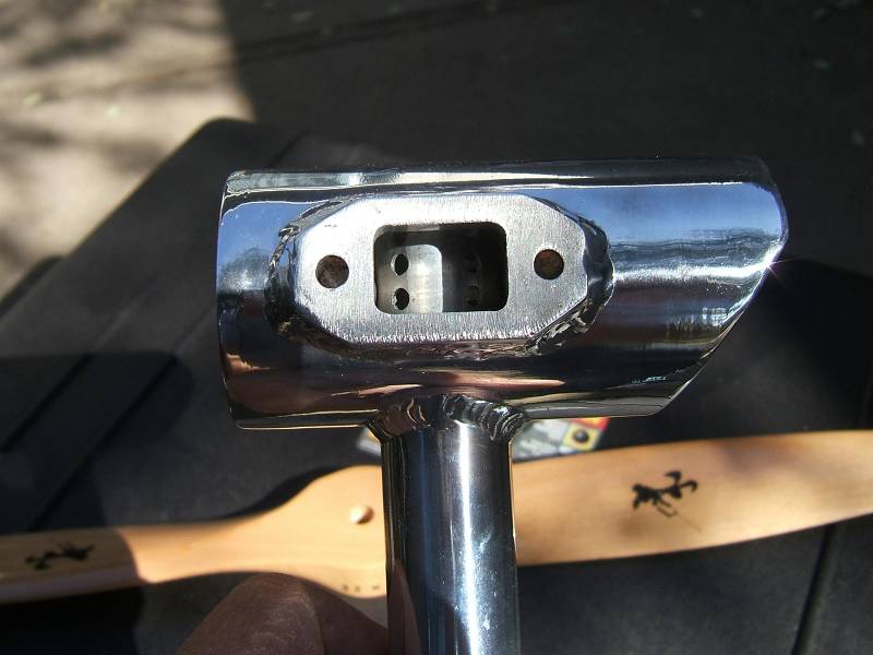

Too bad the muffler is always inside the cowl. This one is well polished and would look good outside the cowl. Oh well. Note the baffle inside the muffler. This is a step up from most mufflers which are usually nothing more than a means to divert the exhaust out and away form the engine, and have no form of baffle at all. The baffle will help considerably in reducing exhaust noise, and may well reduce it to a level where noise sensitive fields may not require a cannister. That saves money!!

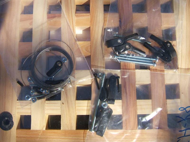

Since I know the question will come up at least twice before this build thread is concluded I'm going to list the full contents of the optional hardware pack. As follows:
(1) Dubro 24 ounce fuel tank
(1) Dubro Gas Conversion Stopper, use this one not the one that comes with the tank. The one with the tank is for glow fuel and will melt with gas.
3 feet Dubro 1/8"i.d. tygon fuel tubing. !/8 will easily feed a 150cc engine so there's no need for anything larger.
(2) Dubro 2"x3/16" Steel Axle Shafts.
(4) Dubro 3/16" wheel collars
Approximately 10 feet of pull/pull rudder cable and associated hardware.
(4) Wild Hare ball link assemblies for 4-40 rod with 8-32 screws for elevator and aileron horns. No "A" nuts. You don't need them.
(7) Servo extension "keepers". They've come to be known as "squiggles" and work well.
(2) 1/16" hairpin cotters. A very nice safety when used in the anti rotation wing dowels.
(4) Sullivan clevises. The good kind.
(1) Fuel line "Tee".
(1) Fuel dot. Glue or silicone in type that works very well.
(2) 4-40x1" nylon screws.
(2) 1 foot lengths of 3/16" fiberglass tubing for control rods.
(2) 4-40x 12" threaded rods with nylon clevises. I haven't figurerd out what these are for yet. Probably choke and throttle.
(1) 4/40x12" all thread rod for the inside of the fiberglass tubes. Includes instructions for making the pushrods. Too easy.
Miscelleneous nuts, bolts, screws, and washers.
(2) 3-1/2" Dubro treaded wheels.
(2) Wild Hare rudder horns and (1) 8-32 screw. Very similar to the Dubro long tab type.
Typically the tail wheel assembly and hinges come in the box with the plane. As a rule there will also be an additional package of factory supplied hardware. Some of it you'll use, and some you won't. The factory supplied metric axles are pretty soft and the metric wheel collars often don't fit. I guarantee that you won't find a wrench or socket that fits them of any type other than Crescent. That's why Wild Hare provides the option of a stronger Dubro set in the optional harware pack. An aluminum wing tube will be standard.

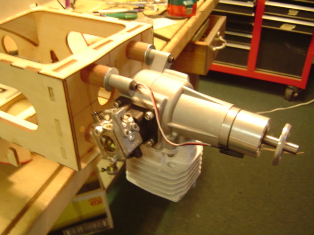

This particular carb came fully equipped with usable throttle and choke levers. What a welcome change. I've become so fed up with engine suppliers sending out aircraft engines with a throttle tab designed for a weed eater and not usable on a plane so I'm extremely relieved to see an engine I don't have to modify. Thanks Tom, hope that's being done with all of them. Heck, even the fuel inlet is pointing the right way for a change. Most of the new engines I usually see have the inlet pointed to the side or down for some reason. In some cases even forward!
That's one of my contributions. Nothing drives me nuts quite as quickly as an engine that cannot be used without modification.
Of course the engine comes with the ignition and CM-6 spark plug. All you'll need to complete the engine installation is a switch and battery for the ignition. You'll have to add a plug to the ignition switc lead that matches that on the switch you intend to use.
If you use all standard switches and battery packs no soldering is required.
Also Pat did not mention that the ignition comes with some nice plastic "wrap" that can and should be wound around the plug wire and other wires to prevent abrasion which can be done easily by rubbing on the fiberglass cowl.
Since the spinner is secured to the backplate at the side with four 3mm button head allen screws you don't need a prop adapter or long spinner screw.
A short follow up. I mounted the 3mm 53 on mine yesterday, The installation is very easy, requires 1" standoffs which I made from oak dowels in about 5 minutes, and 4 x 2.5" screws. This puts the prop about 1/4" ahead of the cowl face. The muffler fits nicely inside the cowl with no butchering, and without a spark plug in the engine the cowl will fit over the engine without any cutting. So it looks like the only cutting will be a small hole to clear the spark plug/cap (may not be needed) and perhaps a V cut at the rear to allow more cooling air to vent.
This is the easiest engine mounting operation I have ever done with a gas engine.

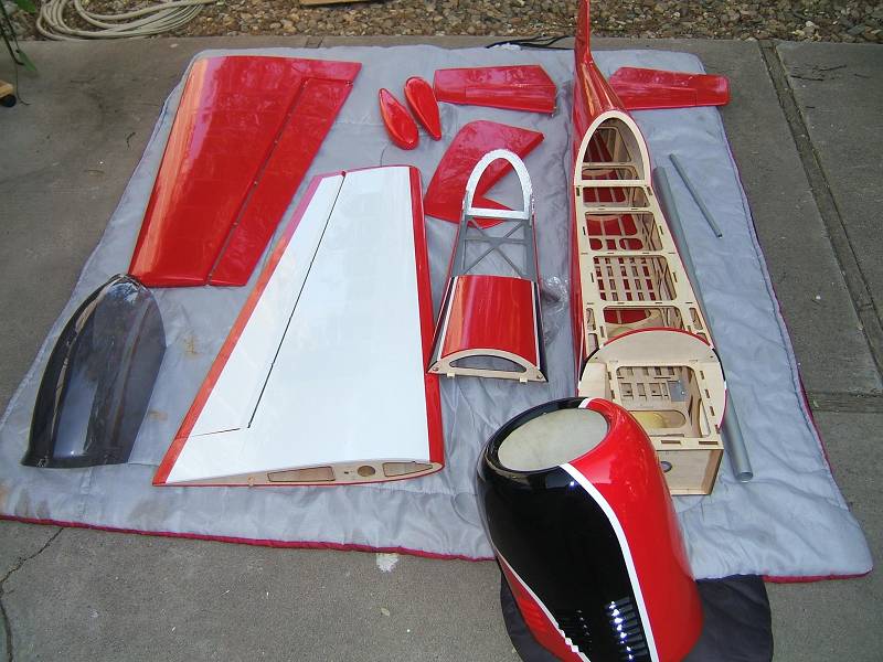

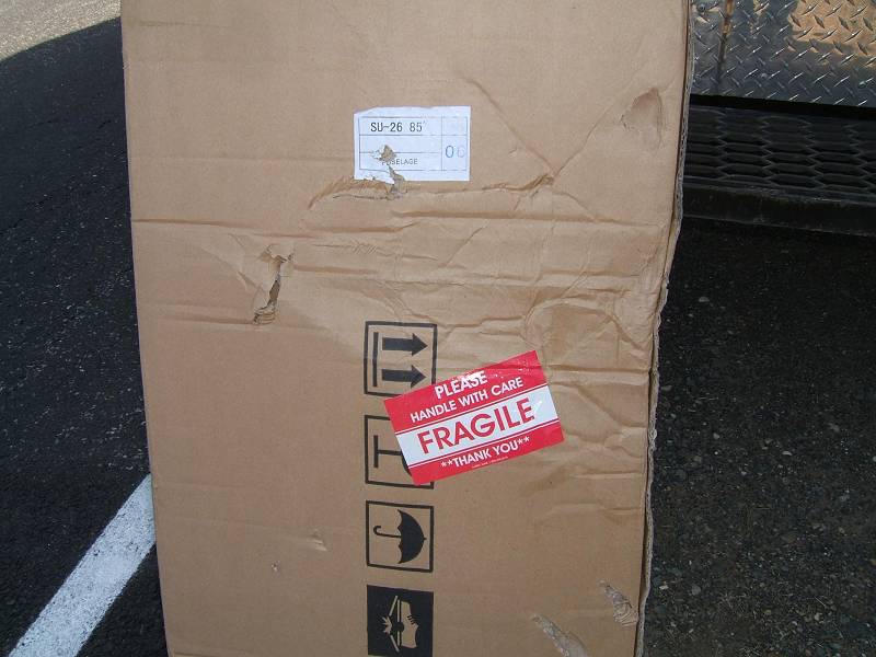

Darth-UPS-Vader dropped of a couple of boxes today that were beat to death. After making Vader wait while the boxes were opened I was surprised to find an undamaged plane inside.
Man, this baby is RED!! For anyone into graphics this is the one to start with! Lots of artist easle here. As the pics get posted you'll note that it's very similar in construction to it's big brother. Two piece gear legs, a very nice cannister pipe ring/opening in the cowl. A new item with the fiberglass tunnel cover/recess. A nicely tinted canopy, and all the various nuts and bolts that normally arrive from the factory in the kit. Yes, the tailwheel is there
The light was getting a little less than optimal for pics but I hurried and shot as many as I could. A few were with a flash to give a better view of the inside. I'm gonna post a bunch of pics, starting with the box condition and then go out and get to work. Tom came up with some easy to use dimensions for an engine mounting template using the 3mm-53 so that should cut down some of the thinking part of the assembly
Overall she's looking pretty good right out of the box. Very few wrinkles in the covering and the parts fit is great with nice looking glue joints. This should be an easy assembly and flying should be a treat!

Glad the plane arrived alive....I hvae done some service work in the local ups sort facility and my conclusion is UPS = United Plane Smashers.
Been in a UPS hub or two some years back when riding front seat with a major air freight carrier. Made my hair stand on end when I saw the way they "handle" packages. Meaning as few hands as they could lay on a package an still get from one point to another.
On closer examination mine did not make it as unscathed as I had thought. Found a place on the right side aft fuselage where something had managed to poke through the box into the side sheeting. It's in a non critical area and small enough where a 1/2" "dot" of covering will hide it with no notice.

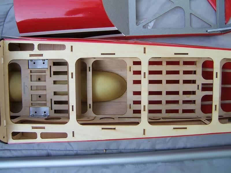

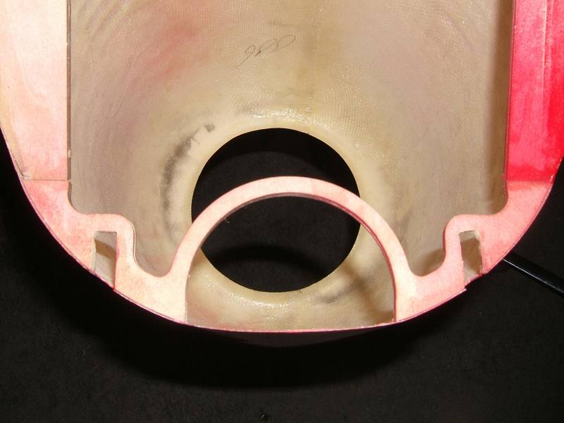

Cowl Attachment, of note:
Finally sitting down with the plane for a good look-see and I noticed there has been a change in the way the cowl attaches between the 35% and 28% birds. The construction between the two is so similar it's scary! That's a good thing, BTW. The 50cc plane has a couple of wood "hooks" at the bottom of the cowl to set the cowl down into. This is addition to the upper cowl attach screws. This is very nice and should prevent a cowl from dropping down into the prop if the upper screws were to fall out. With this feature the cowl CANNOT drop lower than when it installed prior to flight. It just can't! You have to line the cowl up a little more accurately when you slide it in place but it's not at all difficult. If I can do it anyone can do it, and it only took me twice to figure it out
Reduces the fastener count in the cowl attachment as well.
In the pics you can see where the cowl fits into the fuselage hooks. This one was a little snug and left the cowl sitting just a touch high in relation to the top of the fuselage. The correction is very simple. I used a small, 1/4" wide rasp to adjust the fuselage hook depth a little bit. Took about 2 minutes. BTW, snug is good. That's one of the things that keeps the caowl from dropping down should the screws ever loosen up. You want snug.
At the moment I'm still making up my mind on the cannister cut out and fiberglass insert. For those that will be using cannisters it's a very nice feature but I'm one of those that still only needs a muffler at the places I fly. More on this later as I ponder it more thoroughly.

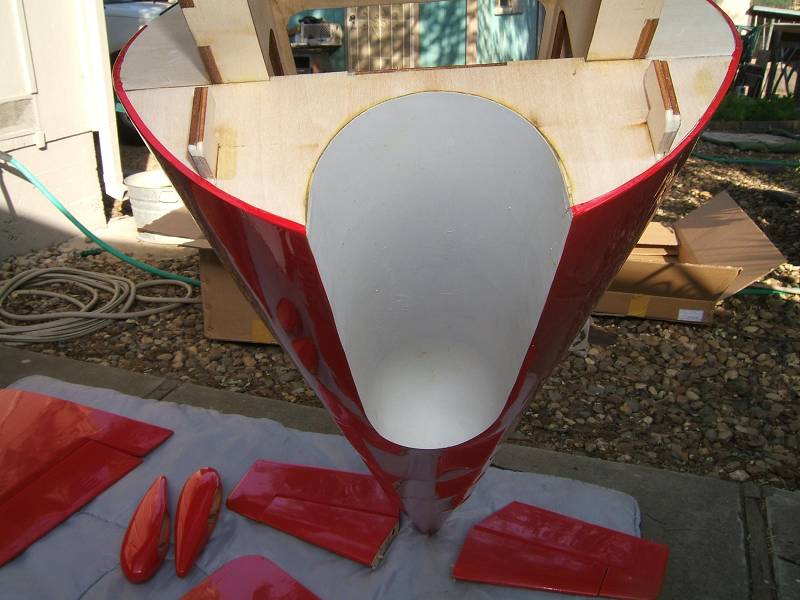

The answer is absolutely not, and brings me back to the fiberglass cannister tunnel. An explanation is in order. Tom does not like to send me planes with instructions, or, and this is more likely, they have not been developed yet as was the case with the 35% Sukhoi. When I started looking at this 50cc version and noted the tunnel, the next thing I did was to look at the landing gear mounts. Since they appeared essentially the same as the 35% version I was thinking that you would access the gear through the pipe tunnel. Not this time buddy. The 'glass tunnel blocks all that off.
So now I'm thinking "how the hell are you supposed to install the gear if you can't get through the tunnel?" The light finally came on when I took the gear legs out of the bags and noticed that not only are they quite a bit thicker than those on the larger version, they are TAPPED to accept the retention screws! Oh man, this is gonna be easy!!!! Drop the screws into the gear from inside the fuselage, where you have tons of room and Locktite them in. Those that may have wanted to bend their gear into an arc can forget it. These legs are stout!
Another note. I have not been able to locate a third servo cut out in the back of the fuselage in order to tail mount a rudder servo. You have one opening on each side for the elevator servos so a pull-pull installation is mandatory. Probably better that way so people like me will stop pushing and pulling the rudder from only one side
