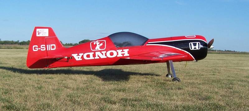

Finally got around to maidening my SU-26, with the 3MM 53cc in it. All I can say is, watch out how much elevator throw you have, they are very effective in the pitch change arena. Other then that the plane flew awesome. The 53cc engine looks like it's going to be a perfect combination with this plane. I now have the only 2 Wildhares in Japan. All of the other club members like the Sukhoi.

I've noted the same thing with the tail surfaces. They work very well. 10 or 12 degrees of elevator is all one needs for normal or IMAC flying. You may still want to soften the reaction a little with expo. I started out with 20 degrees for low rate and detuned to 15 for my basic flying. It's still a little quick but I prefer that.
Have you tried any low speed snaps yet? Even with the plane almost stopped they wil stop right where you tell it to.

I haven't done much aerobatics other then some rolls and loops and a few high speed snap rolls. I was just basically flying around to break in the engine. Will get more time on the plane this coming weekend, and will tune the engine for better throttle response. Then will start throwing it around. As for expo, I never could get used to it. I too like things to start happening as soon as the stick is moved off center. I think I might need to move the CG back a little as it doesn't hold the 45 degree inverted line, and takes quite a bit of down elevator to hold it level inverted. It's balanced right now at the aft edge of the leading edge sheeting at the wing tip.

I started the CG on mine in the back 1/2 of the wing tube and had about 3 ounces of lead behind the engine box for adjustment purposes. I pulled half of that yesterday and it was not as nose heavy but still required a little more down elevator to hold level when inverted than I think it should require. I'll be removing the rest of that lead next time out. That should put the CG either at the aft side of the tube or slightly behind the tube.

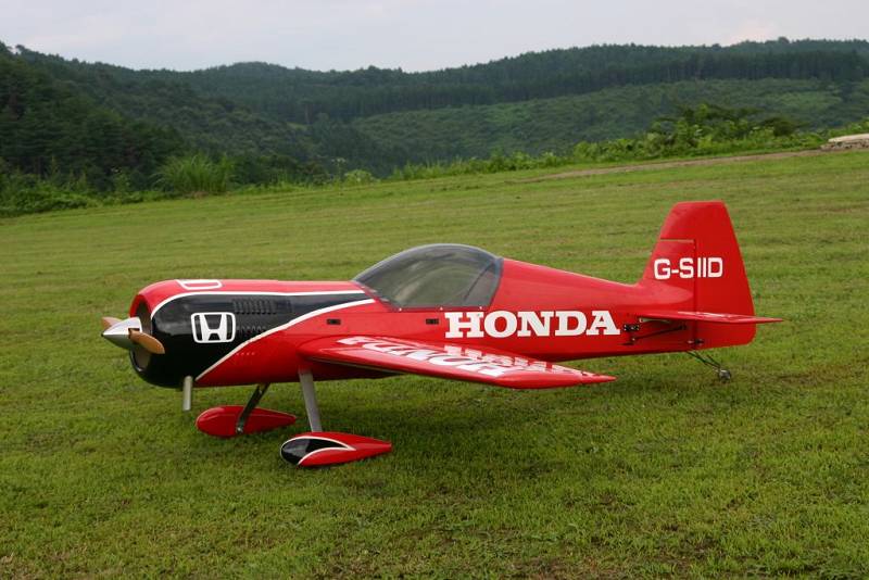

I was refering to my troubles with a Evolution 58 as much as i love the awsome power of that one and i do love the way it runs when it runs right but the mysterious way the thing decides to run lean still troubles me. Ive enjoyed many uneventful flights with that motor A real power house but trusting it will never happen. Its very hard to regain trust in a motor. Im going to repait the Cap that it flew in last and the Ultimate it flew in last. The cap will get this engine and ill redo all the fuel sytem and run it as ritch as I can stand to and if by some act of god it survives It mat get a new plane but till then its going in a crash victom and flown till submission. The repaired Ultimate will get a new motor possably A DL? My Marzo rebuilt Ultimate will continue to enjoy the DA still the most trusted engine I own But the clock is ticking on this new 53 and she sure has won a few points with me.
as a mechanic by trade I know full well there are no 2 engines that will run exactly the same. however close they are they all have there own way of running and that changes over time. My Da was a 4 flip with choke on and 4 flips with choke of every time I run it unless she is still hot this year its been 5 and 5 almost willing to turn the low end screw out a smidge and with the hotter weather we are having that might be a plan. But she runs smooth and it hasnt busted a plane that wasnt my fault. over 200 hours on an edge and 86 on an ultimate says a bit to me about trust. I look forward to the 100 hour mark on the SU-26 maybe by then ill know how to knife edge spin that thing on demand.
