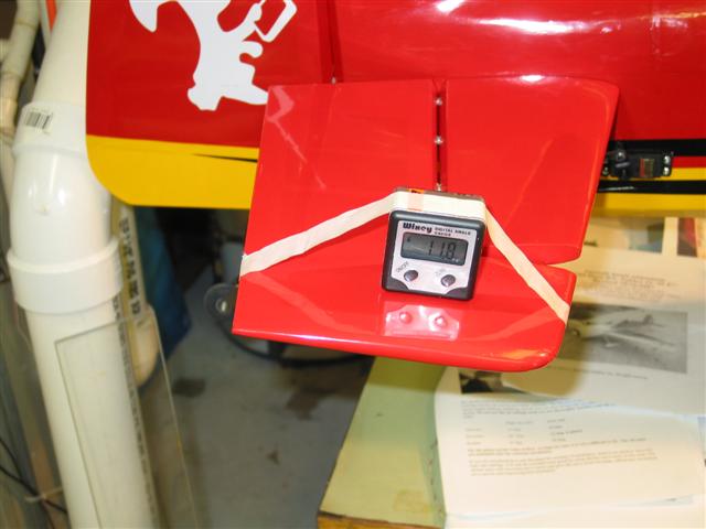

Has anybody got any niffty ideas for measureing the control throws, or could somebody help me with a good start off set up measured in mm's, I have one of those GreatPlanes Accu throw things.
Are there any small settings that would help me set this up better???. Iam taking my plane to Darwin next weekend to have it inspected so I would like to have it set up first.
Lee
Old 02-29-2008 | 07:47 PM
  #807
Joined: Jun 2005
Posts: 15
From: Dubuque, IA
Default RE: 50cc Sukhette Build Thread, now in progress!!
I got a Wixey digital angle gage that is found in woodworking supply places. It is intended for accurately set blade angles on a saw, but I found that it worked really slick to measure deflection angles. It can be zeroed in any position and is accurate to 0.1 degree. See the attached photo.

Thanks for that Bari1
Rang my local supplier and had to spell digital angle to him.[:-] But then me thinks that Hangar9 make one. This will not help in the for the near future unfortunatley. but I will chase one up mate

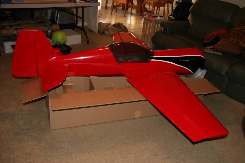

I have a new baby my freind picked her up yesterday going with the TOC 3MM motor cannot wait to get her up and throw her around can't let everyone else have all the fun!!
I see you went with the forward stab position.
Old 03-01-2008 | 09:32 AM
  #811
roboto65's Avatar
My Feedback: (30)
Joined: Oct 2004
Posts: 277
From: Conroe, TX
Hmmmm sure looks that way my friend has it at his house as I live in Conroe and he is in Dallas so he must have put it there. Question then when you move from one to the other does the move cover the other hole !!!!
I have not seen it in person yet and I am chomping at the bit to get to his house and see her.
Old 03-01-2008 | 01:02 PM
  #812
SAL98's Avatar
Posts: 594
From: RIDGENew York
No I dont beleive it does but a quick patch of ultracote would take care of that.

As for degree measurements, obtaining a couple of plastic protractors at a stationary, art, or school supply store is a simple and cheap way to obtain a workable tool. There are many types of angle finding tools that can be purchase for $10.00 or less at any home improvement supply store. That's cheapr than any of the "specialty" items obtained from hobby supply stores.

Pat Roy
Thanks for your input, I basically did this with the protractors, I made a couple of pieces of thin ply cut to specific angles and moved the control surface up and down till I got them to match the cut angle,
This seems to be successful, Iam going to the big smoke of Darwin on the weekend and will try and find a Digital set up there.
