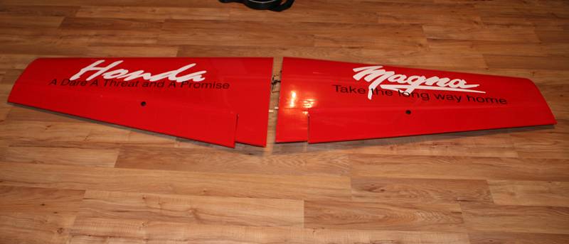

Here are the wings of mine went with a different Honda scheme since this is what I ride and it was on the same line not as many wheels. I will give credit to my friend as he is the one doing the install of the graphics and he built the bird for me we have flown it a couple times and he did an AWESOME job putting her together ... Anyway the fuse is next going to look great !!!!!

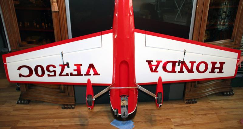

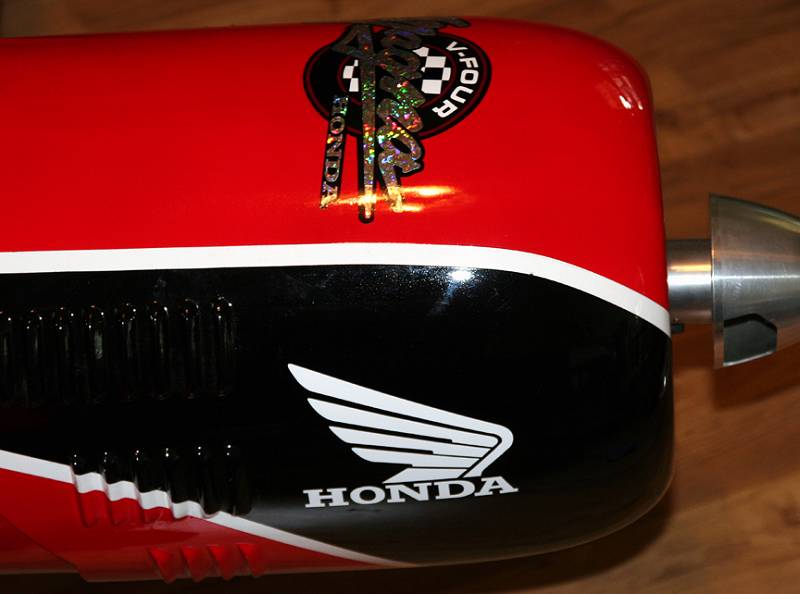

Thought I would post a couple PICs of ROBOTO65's bird and new graphics. I have a couple more to do yet before I can take PICs of the finished product.
The first PIC, that graphic came in 4 layers, a bit of a pain, but it came out GREAT!

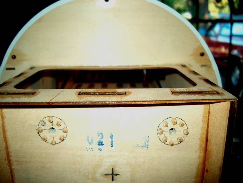

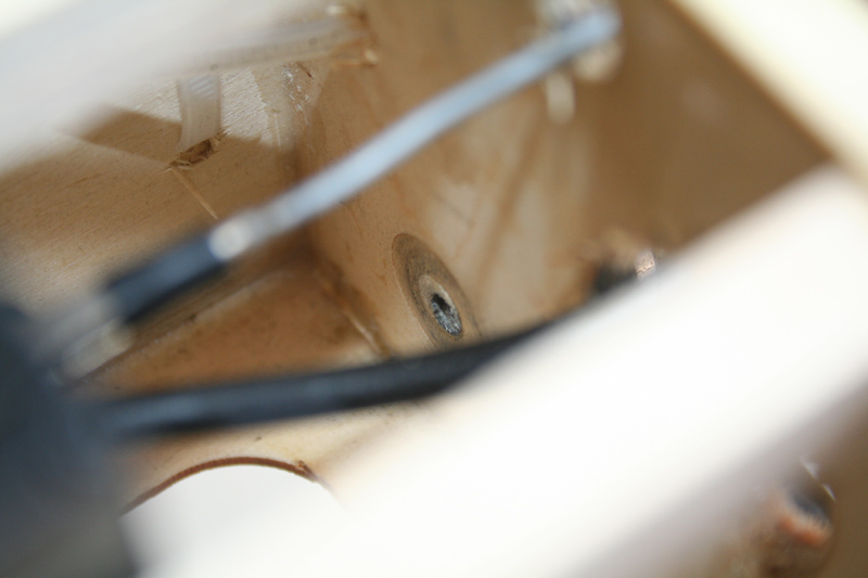

I had a rough day yesterday, dead sticked the plane and then on the next flight I had a bad landing in a heavy cross wind, breaking the prop and bending the left landing gear slightly. The big issue however on inspecting the plane, two of the four bolts holding the DL50 were missing and a one was loose. I had one bolt come out early on with the plane, and replaced all the mounting bolts with hex head bolts and lots of blue Loctite. The plane has been flown about five weeks with no issues with the bolts, until yesterday. I do check the to make sure the engine is tight to the firewall once when getting to the field. I suspect the wood in the firewall is compressing allowing the bolts to come loose. The prop was well balanced and the plane didn't have any unusual vibration. The wood standoff spacers are hardwood and there is a depression on both sides of the firewall from torquing the mounting bolts.
Any comments and suggestions would be greatly appreciated. I've dodged the bullet twice and I don't want the engine coming loose again.

I always drill a few 1/8" holes around each bolt hole and put pieces of hardwood dowell in them and soak the whole area with thin CA.
Now the bolts are tightening against end grain.
Jim

Fishdeth: Excellent suggestion. We used to use aircraft ply but that was unnecessarily heavy, with lite ply use lock washers and soak the area with thin CA to harden the wood. Using fender washers will also help.
TF

Fender Washers work very well.

I always use a nylon aircraft safety nut. THEY NEVER come out or get loose. I never use blind nuts anymore.

Very good Idea fishdeth, I also use fender washers and even tried Prop washers from a old glow motors. There slightly smaller in diameter than fender washers but they do not compress at all.
