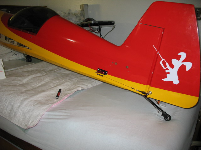

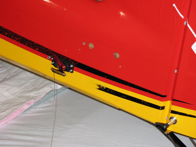

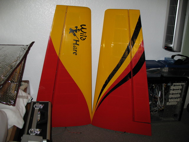

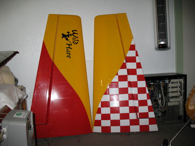

Updated Pictures...

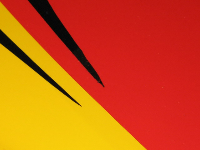

OK, the yellow red and black scheme really appealed to me ( everyone likes the Honda scheme ) so I this instead with the intention of changing some of the graphics to personalize the plane. Right from the time I opened the boxes and saw those black stripes I hated them. Then when I saw that almost all of them were peeled up a bit a the points I knew I was going to remove them.
Here are the pictures of the progress so far, stripes being removed, and new scheme going on. the big red area on the wings once the stripes were gone just screamed for checkers. The look really good from about 3 feet or more but my inexperience in laying down monocote and working with an iron shows. BUT... I am really happy with it and will start on the second wing tomorrow. I also plan to run a blue 1/4" blue stripe on the delineation line on the wings between the yellow and the checked area. Tail and elevators will get a bit of checkering too I think. Still a work in progress and will have to see how the plane looks with the wings on. don''t want to overdue it on the checkers
here are the pictures...

Artist little bugger aren''t you
Hey ive got the same colour and I like it, by the way its the colour of our indigenous fellow Australians flag?????
Mind you axiss your''s does look really good, love the checkers!!!

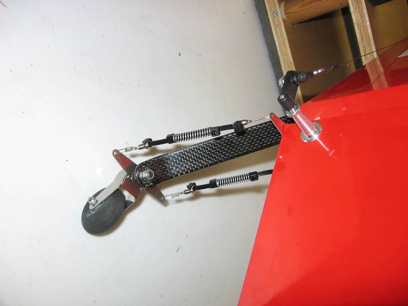

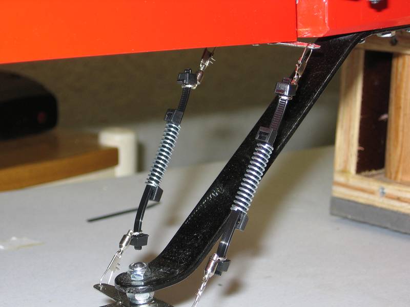

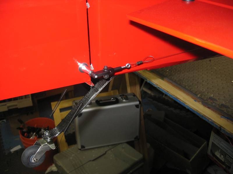

Hello all,
I took my WH Suk to the field on Sunday for radio testing and got rained out. While there a friend suggested I find stronger springs for the tail wheel assembly and suggested that ground handling would be better with stronger springs. I searched and found some different sysems of varying complexity and cost $$. This is what I came up with. The zip ties are placed to compress the springs and are adjustable for tension and wheel / tail alignment. with the zip tie heads at either end. The swivels at the ends provide a clean connection and I soldered the key ring style ring to prevent it from stretching out.
I probably spent $5
I suppose this has been done before but I thought I''d post here for the group.
I probably spent $5

Yeah your right about that.
fishing tackle shops are good for niffty fittings like this sort of thing and they are usually rated for strength.

Very nice Obee!, I made some compression springs for my Suk using cotter pins but I really like the zip ties, may have to rework mine.

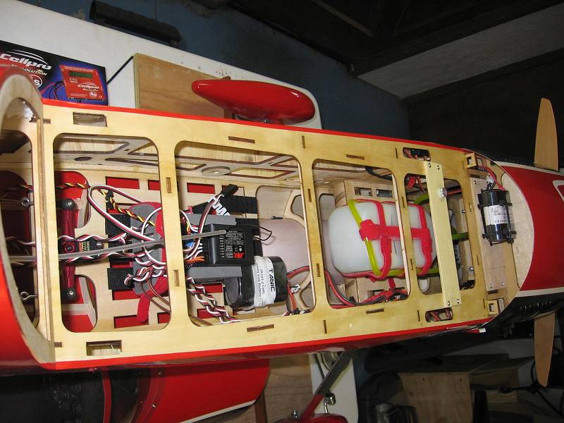

Obee...
Got a couple questions for ya, where did you end up placing your batteries? I am going to be taking my plane over to a friends house early this week to balance it and just looking for a starting point as you seen to have a very similar set-up to mine. I am running a header with a td75k can. I hear people talking about the 26 being tail heavy and having to move batteries to the nose or add weight in the nose.
some pictures would be nice also if ya could....

Yeah now I know it is not only me heck I even busted a prop bouncing but great video looks greats love that tail !!! My batterys are one on the nose and one on the reciever tray.

Obee:
I don't see any mention of what engine you are using, this is important when discussing balance.

I have a DL50 with a stock muffler in mine and it was tail heavy - even used heavy batteries - 2500 4.8 v ign by the firewall, and 4500 6 volt front of fuse. Mine does have a virtual cockpit with a pilot that weighs almost 6 oz ( i know ...too heavy) so I used 4" stand offs to keep me from adding any more weight and the prop distance from the cowl is fine. The plane weighs 18 lbs 2 oz and flies great

Regarding balance, my cg is about 1/8" forward of the center line of the wing tube. It has a DL50, Jtek wrap around muffler, 1200mahr Nicad for the ignition, and an A123 for the receiver. The ignition battery is on the side of the engine box and the A123 is right behind the firewall.

Tom, to answer yours: 3MM 53 with a cannister , A 123 batts I do have a Aces of Iron pilot in the cockpit but they're very light, but it's still an addition.

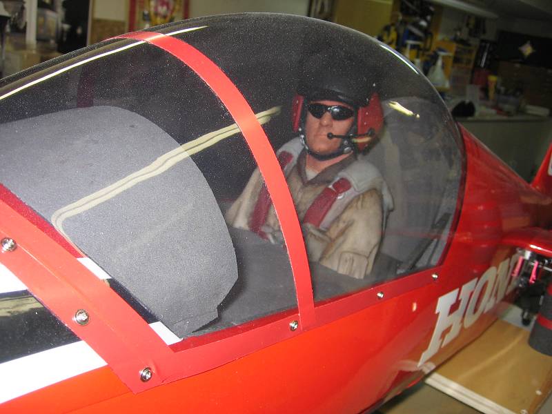

Hello,

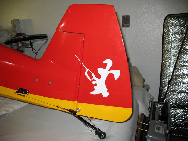

Some general shots of my Suk: Cockpit/ pilot, venting/exhaust, tail wheel and interior.
the Pilot is a Aces of Iron 25% and the cockpit is built of some light foam re-sawed from blocks I had left over from building kayak seats. the instrument panel was found on this thread I believe. I'll attach the file here.
I have some lead mounted to the engine box to achieve balance at this point. Some of it may be removed to change balance after a few flights. I have yet to fly this thing as I'm waiting for a break in the weather and my schedule.
I would like to take this opportunity to thank all of the forum participants for posting and making this an enjoyable process. Without all the information found here a noob as myself would have struggled much more. Another deserving recognition here is Tom @ Wild Hare. The customer service and professionalism is top notch. With the combination of a great product and product/ customer support I'll be back for more. When I took the plane out for radio testing at my club field I saw some people looking at this plane like they were starving wolves. We may see some more WH planes there.
Thanks TOM
Obee
