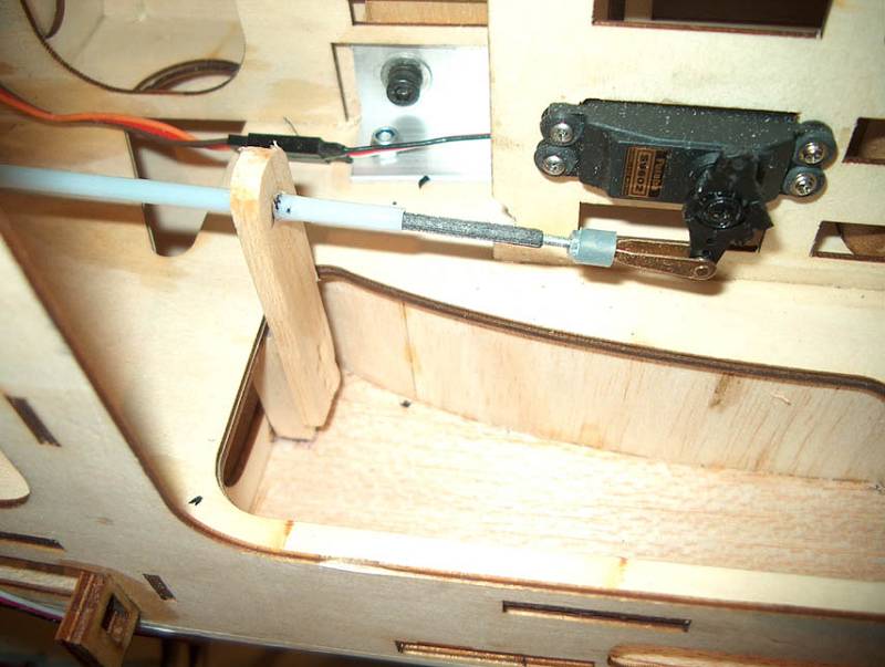

Tom, ah gasp my cowling will only fit 4 of the 5 screws, this is anoying but will have to put up with it, just tell em to fix it???. Its better to leave it than try to repair it,it misses by a complete hole width.
does any one have a picture of the mounting of your throttle and choke servo for ideas????
Have just mounted the motor and so far so good, used the mounting template supplied and it worked spot on (nice)
Hey I really like these big ones!!!!
Have just reread the whole thread and there are some really good ideas thanks to all so far for input it certainly helps people like me

That cowl screw problem seems to be there on some and not on others, I don't understand it at all.
I mount the throtle and choke servos in the pocket in the side of the fuse that's formed above where the wings mount. There are other pockets that will accept a servo also.
TF

ORIGINAL: jaihunt
Lee
Jim
ID:	873350   Click image for larger version
ID:	873351   Click image for larger version
ID:	873352   Click image for larger version

Hey, Jim thanks,cool
