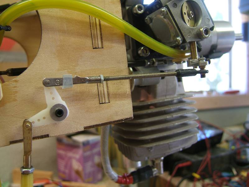

Manual Choke Linkage--3mm-53
Here's what I came up with for a manual choke using around the shop materials:
One servo arm, any type will do, even round. A couple of threaded rods, one small ball link to avoid binding, two flat washers, one brass servo eyelet to fit the center of the servo arm after opening up the hole for the servo screw a little, a couple of 4-40 clevises, a 4-40 screw, and a 4-40 nylock nut. All you're doing is making a bellcrank to change the direction of the linkage 90 degrees. Works great.

So if I had used a choke servo AND a spinner I would have needed tail weight[8D] Bending over to work on the plane once in awhile is good for you. Especially for us guys in our prime (Tom). Helps keep you limber

So you just screw the bellcrank straight into the firewall right ?
