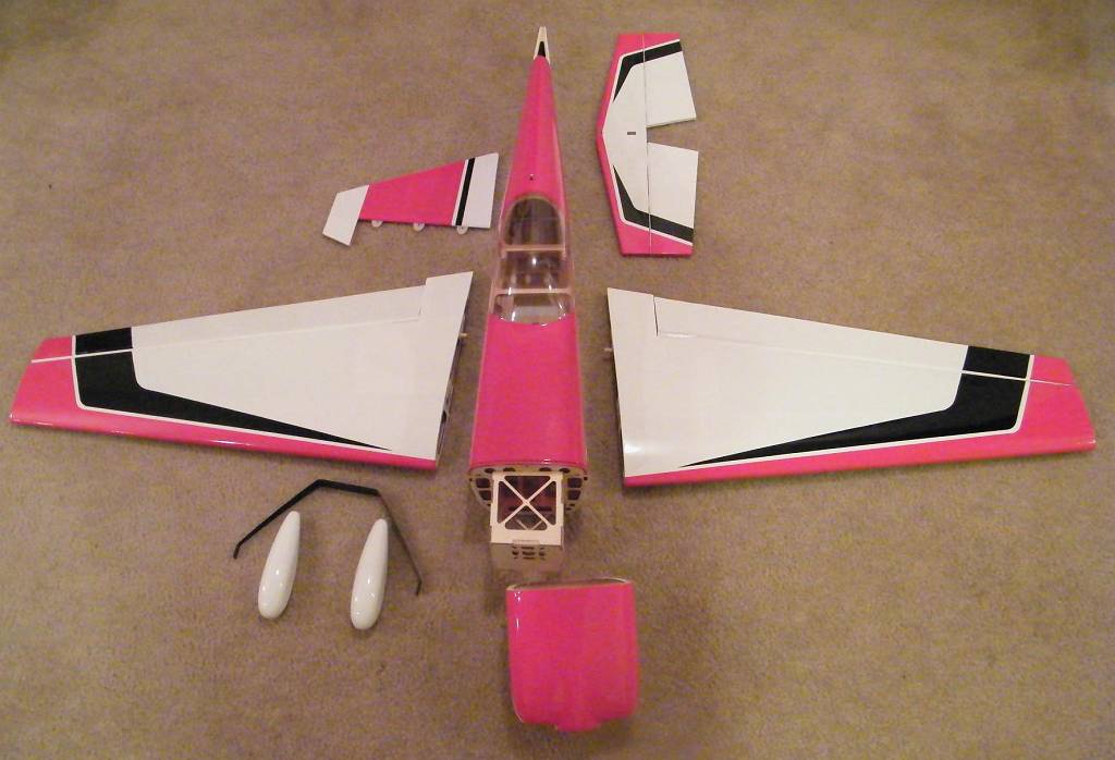

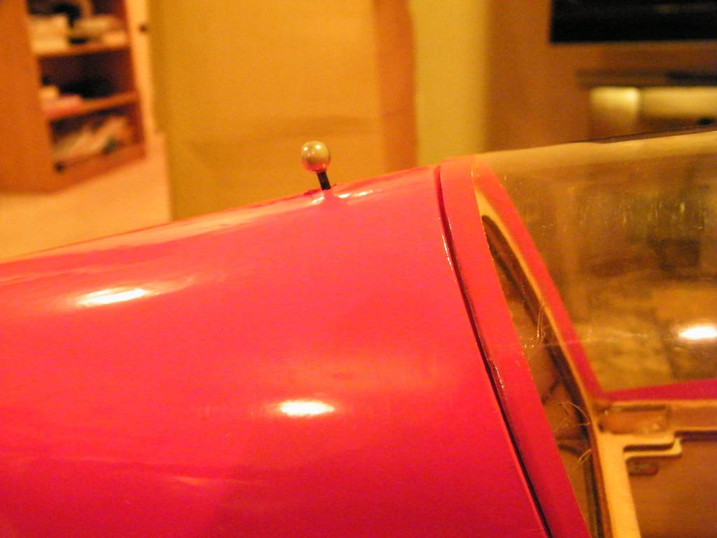

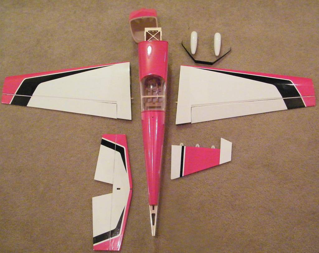

Got in some quick pictures this evening. I was in a bit of a rush so I missed a couple of parts but there's enough for a start. Not up to my usual standards but they will do until I can take them again in the daylight.

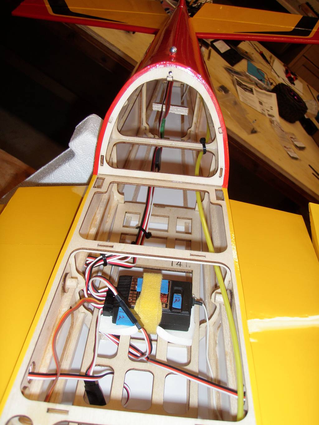

The Power HD sevos are a pefect fit for the servo wells. One might have a need to slightly shave the ply servo mounts with an Exacto blade due to minor changes in sizing due to ambient humidity conditions. The fit is real close but easily works. Any servo larger than the Power HD will require modification of the servo opening. Centering of the motor in the cowl is pretty near automatic. The way the airframe is laid out at the engine mount area it's almost impossible to be off center. The engine sets itself more or less. Balance on this plane will be very easy to accomplish. There is nothing but room inside the fuselage to move things around. How you like your planes to fly will determine where you put the battery and receiver. No problems installing either item anywhere inside the fuselage. A little velcro and you're good to go.

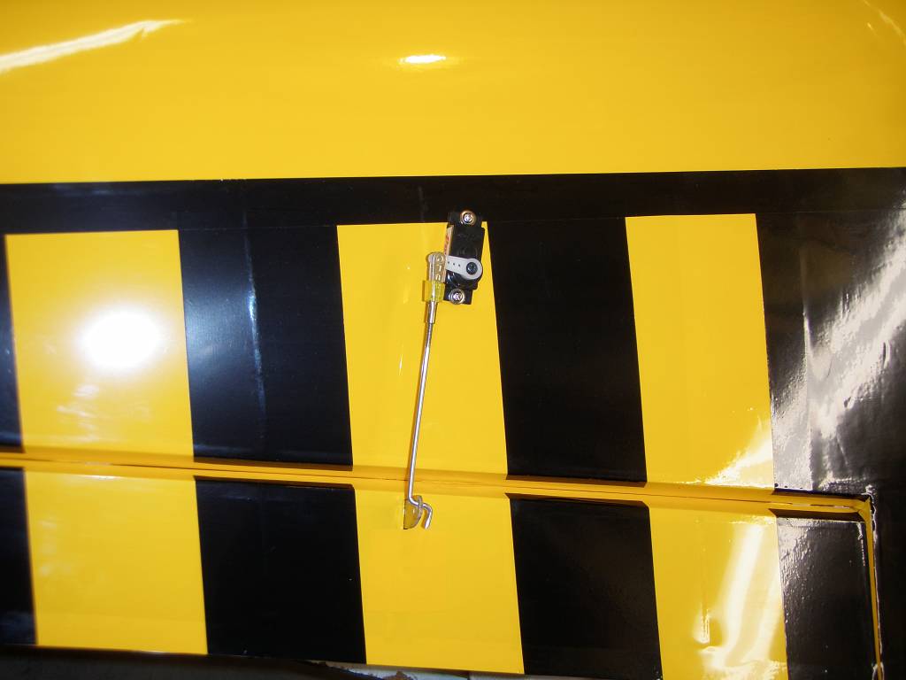

I just finished my E540 Slick. I had the plane that was damaged with the boot print on the box. The fuselage was trashed. Wild Hare was so fast to respond. They had a new fuse to me in 4 days.
The kit was very nice to build. It took me 2 1/2 days over the weekend to assemble the kit with Tom's power pack.

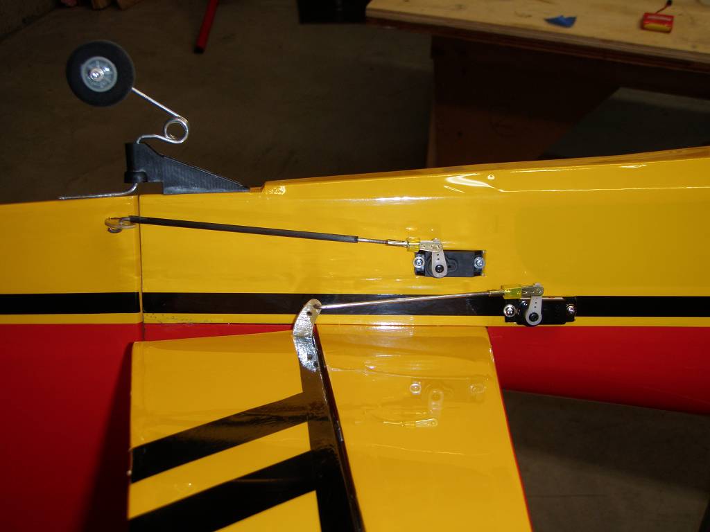

I plan on using 2 3C 2300 Thunder Tiger 45C lipo packs. Here are some photos of the plane.
More to come after I fly it!!!

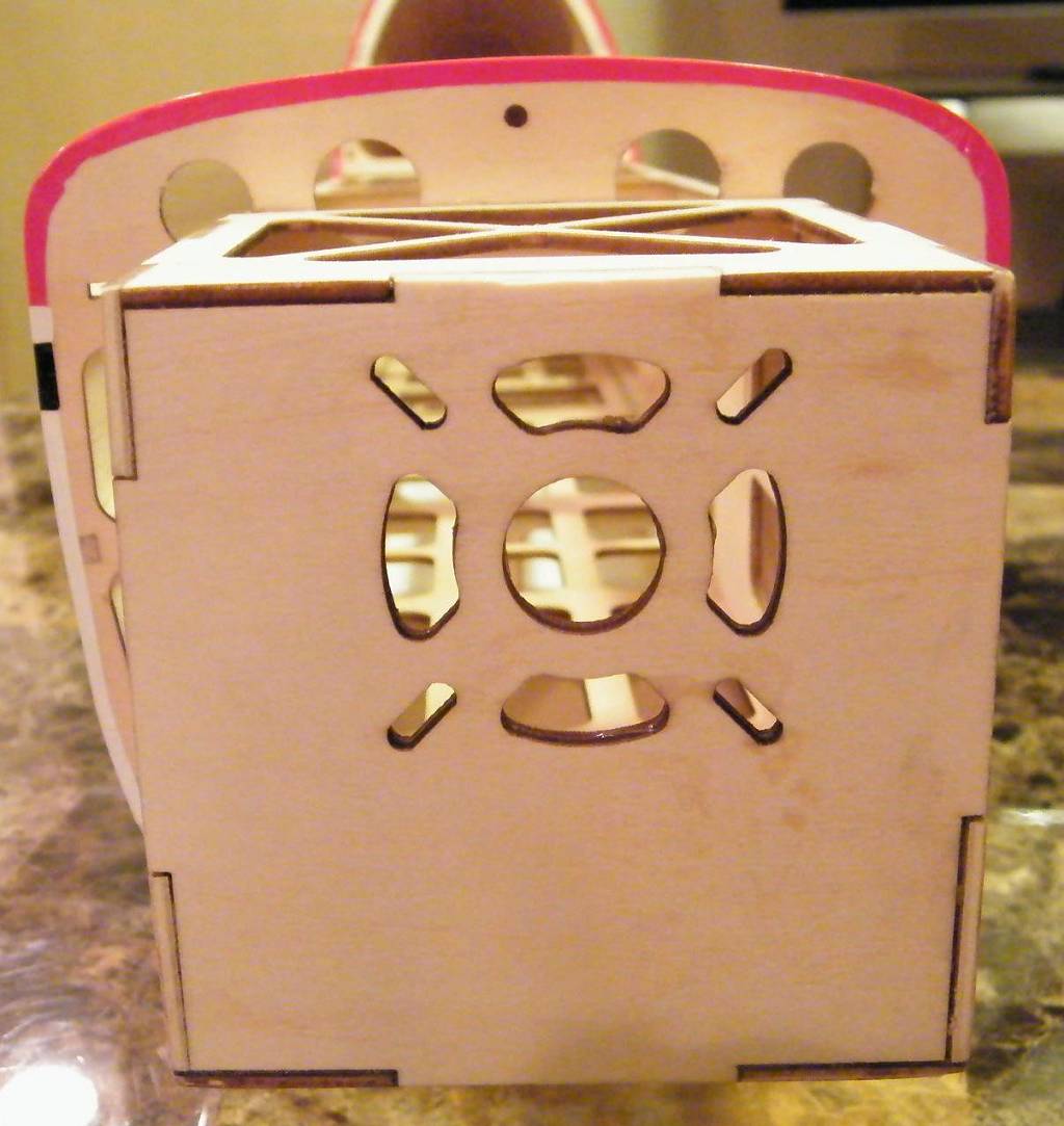

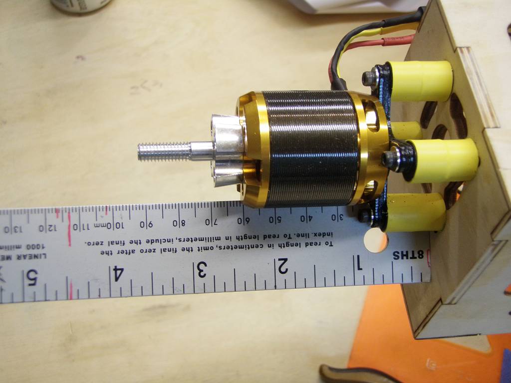

I'm curious to see if there is any variance in the engine mount box lengths. The spacers needed for my motor worked out to be 11/16" in length to provide for about a 1/16" gap between the back of the spinner and the cowl. How long are yours?

TOM my spacers ended up to be 20mm that gave me a 1.5 gap to the cowl. The spacers Tom sent never made this far they must have gotton out of the box along the way to PA.

Just so you won't get lonely, mine didn't have any spacers either. Off to the shop today to make some. Easy enough to do, as you've already discovered.

I just received the motor spacers in the mail. Looks like stacking up 3 of them is just about a perfect fit.

Here are two more photos.
