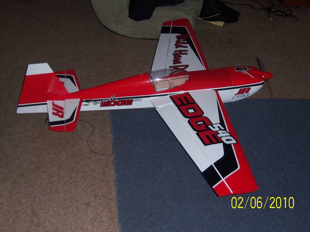

I am working on compiling pictures and thoughts from my build, but wanted to say I took the opportunity to fly mine on Monday.
I set my timer for 6 minutes, then flew around trimming the plane until it hit the low voltage cutoff when I was up high. I thought 'No problem', turned around, made an approach, went a bit too long but didn't want to risk losing power on an aborted landing so I forced it down and rolled into the tall weeds. No problems. Not bad, 8min 30 sec flight. That is a bit shorter than I thought (using 3700 mAh cells), but not bad.
Second flight I hit the LVC at about 4 min 30 sec when I was at about 70' going into a
hammerhead, and at the downwind edge of the field (which is a steep 40' high hill). I leveled out, milked it upwind as far as I could muster, flew a left-hand teardrop to final, missed the mud puddle and the road, set up for final. Uh oh, the wind is picking up (maybe ~7-8 knot tailwind, gusting to 12 kt), set it down on the dirt, and ran the right wheel right into a grass clump. The plane flipped over onto the top of it rudder very fast. I thought it would be badly damaged.
Luckily the only damage was to my ego. I took a very close look at the plane. Besides the dirt on the cowl, wheel pants, wing, and rudder, it was surprisingly clean. Even more impressive was the fact that the paint on the cowl and wheel pants didn't chip! No damage was sustained by the rudder or fin. Also I fully expected to at least crack the landing gear. Nope, not even a chip or stress fracture anywhere. The landing gear attachment block is still solid without any cracking of glue joints.
Needless to say this is a very stout airframe! I have destroyed planes on softer landings that this one, especially the harrier landings which can be very hard on the fuse.
Rule #1 of electric flight: If I can't remember the last time I charged my batteries, there is a good chance they are not charged!
As it turns out my batteries were last charged with a "Storage Charge" setting on my FMA Cellpro, which takes it to about 50% charge state. That was a few weeks ago. When I fly again (using fully-charged batteries of course) I will set my timer at 11 minutes, and work up from there. I expect 12 minutes will give me enough power to go around a few times before it dies on me (again using the 3700 mAh batteries).
So how did it fly? Very nicely. The power using the stock power system gives it a slingshot effect launching out of a hover, and it climbs at a very constant rate to much higher than I can see without any detectable deceleration. Rolling all the way.
IMAC-type patterns are solid. Loops track very well, and snaps are pretty quick but stop immediately upon control release and are easy to keep on a line. Spins break cleanly too.
Knife edge flight was nice, but I think I will go with a stronger servo as it won't quite push up into a vertical with the stock servo.
Slow flight is solid at a fast walking speed. Harriers were not yet very good as I don't have enough elevator throw to push it past flying and into the deep-stall condition. The wing would simply keep trying to fly. I currently have about 25* on high rates and with more throw it will push into that regime.
The manual-recommended 12* of elevator throw is very good for IMAC-type and general flying. There seemed to be a bit of yaw coupling but I was also fighting an out-of-position elevator half (bad tx programming on my part) so I think that contributed to the problem. For mixes I will likely start at 7% top aileron to rudder, and 5% up elevator to rudder, and work from there.
Still working on the best CG, and that will have an effect on the yaw-pitch coupling. The CG on my last flight was right about the middle of the wing tube and it seemed to float a bit better although that also caused it to "hunt" in yaw tracking just a bit.
I really need a few more trim flights and some more setup tweaks before I feel comfortable filming a flight. I will do it as soon as I can however.
In the end this is a very nice plane to fly, it looks great, and really flies like a much larger plane. This sounds cliche but I honestly mean it. Although everything happens faster than the larger planes, it reacts in flight very much like my old reliable 33% Extra but with a huge relative increase in power AND a slower stall speed.

I played with my Astroflight Whattmeter a bit last night. At full power I see just under 50A and 650 - 700W, depending on which battery I use. Ironically my 3700 mAh batteries put out more power than my 4000 mAh pack, with the added benefit of weighing an ounce or two less.
At my actual, straight-and-level, cruising-around throttle setting the system pulls 17.5A.
If I take my 4000 mAh battery, I figure I can safely pull 3500 mAh out of it. This is 3.5 Amp-hours, or 210 Amp-minutes. Divide this by my full-throttle setting of 50A and I find I have (210 Amp*min)/(50 Amps) = 4.2 minutes.
For the cruise setting (roughly half throttle stick) I have (210 Amp*min)/(17.5 Amps) = 12 minutes.
Again these numbers are STATIC, and the current draw will drop as the prop loading drops off with an increase in forward speed. Turning a prop at a specific setting requires less power (and is more efficient) when the plane is moving forward.
For 3D flight I typically fly at a lower power setting, and pulse the stick to rev the motor, which provides an extra blast over the control surfaces in some specific attitudes to keep the nose up. IMAC-type flight typically requires more power.
Stang Killa I bought the plane from Tom with the power system/servo combination. It includes some Power-HD servos, but I can't recall exactly which servos they are. They are great for the elevators and ailerons and passable for the rudder, although I think I will switch to the Power HD 2213 like you are using as I find I am fighting a bit of blowback.
As for the CG, I would recommend going with Tom's suggestion as a starting point. Further you should be sure your elevator halves are tracking one another as precisely as possible. Beyond that is is simply a matter of finding the proper amount of elevator travel to force the wing to stall all at once. If the elevator doesn't have enough travel, or if they don't match each other, any plane will fall off to one side or another when entering a harrier. The elevators are very large and will have a large effect if they don't match up.
That being said I would also stick with the recommended 12* elevator travel setting for regular flying based on the size of the elevators. This was just about the right amount of travel for me.
Question: Tom, is your CG recommendation based on the Edge wing or the Slick wing (or both/either)?
Note: My plane, RTF but minus the battery, weighs 42.5 oz. Considering the size of the plane I find this airframe is very light.

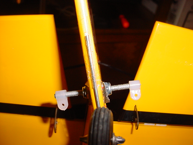

Ok i recieved my plane today in great shape i might add. after bugging wild hair today for 1 not reading over the directions all the way 2 for being blind and unable to find the servo holes. i have 2 questions 1on the aileron control horns i assume you insert them so the end is flush with the top of the wing . 2 how in the world do u setup duel elevetors!!!
ive never seen that before i have a jr7202 pcm radio for control. it has programable mixes so i hope i can do it with this im not real familuar with computer radios when i was flying as a kid none of it existed heck not even dual rates. so if anyone can help out a newbie id apprecite it.

1: Yes, glue them in flush with the upper surface of the aileron.

great info to know.well i guess with my 4000mah 4s it will be a bullet. plane is finally built and will post picks. need to work on getting the cg right. also i have noticed that it seems like i can not get the recomended high rate settings right i have to max out servo travel to 125% which is maxed out for my jr 7202 so i have some tinkering yet to do. must be nice to go flying in feb. waiting on another 7in of snow on top of the 4 from sat.

Thanks, i figured i would try to look like the bigboys.the graphics are from B&E Graphix. which i must say they were very helpful they didnt have a pkg listed for this size plane but they scaled down the ones for the bigboys for me. sent me a preview and let me make any changes i wanted. Great service would highly recommend.

It's pretty simple to convert the rudder to pull-pull, that would likely give you more rudder authority. It's a big rudder and the little servos are really being pushed to their limit.
You can drill a hole through the area where the control horns is mounted and install a 2"-2.5" long piece of 4-40 or 6-32 threaded rod with nuts and washers on either side. You'll need to cut slots in the fuse side for the cables, the servo tray is already installed to allow this.
I had a local customer report that this made a big difference for his style of flying.
