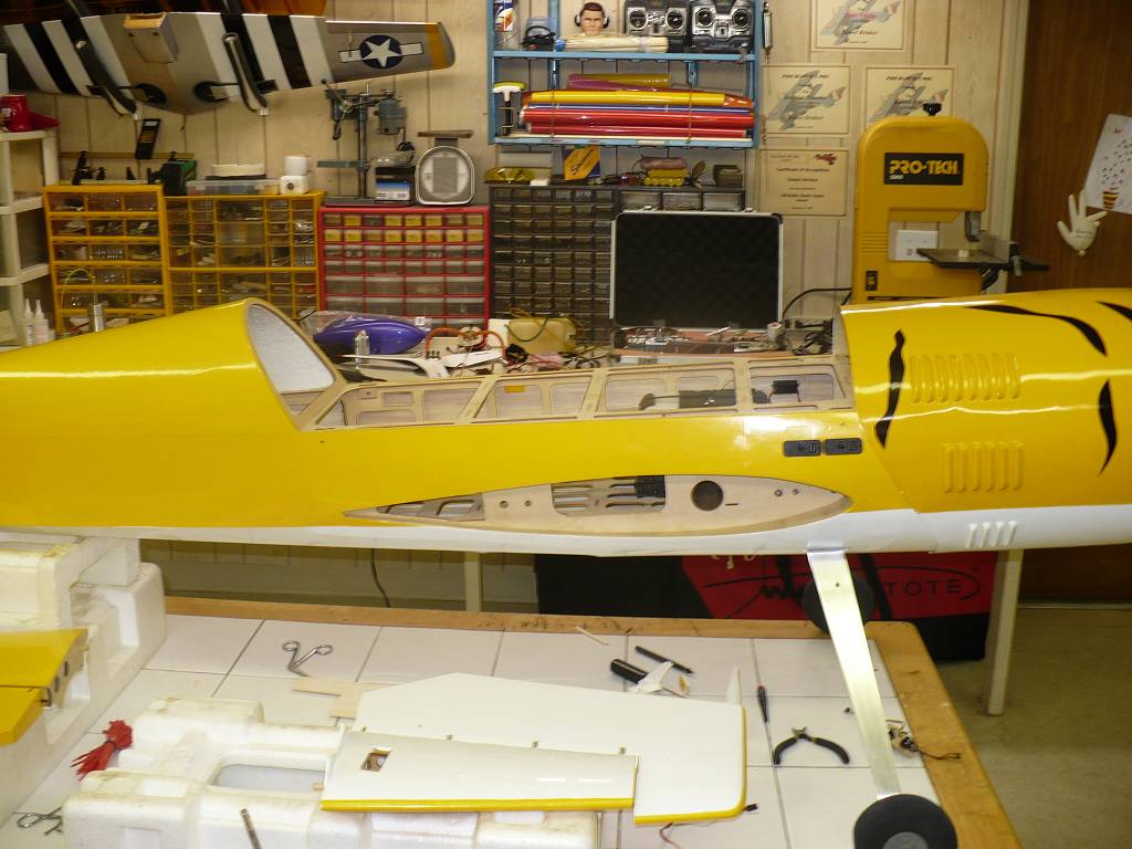

After a month of assembling and modifying she will fly today.
Canopy was a nightmare, wings wouldn't go on the wingtube, repainting, etc. This was the tiger striped version and the previous owner had started to assemble it. He had removed all the stripes except for the painted ones on the cowl.
I had to mount a sanding pad on a steel shaft and run it up and down the wing tubes for quite a while but now the wings slide on and off pretty good. They wouldn't go all the way in without considerable force before that.
In the chance someone else picks up one of these for assembly, 1.5" prolinks are perfect for the elevator halves and 3" are perfect for the ailerons. If you mount the rudder servo in the tail a 4.5" prolink is a good fit. I used Dubro 866 control arms with Dubro HD ball links.
I'll have the all up weight and some pics later. DA100 on the nose, Mejzlik 27X10, JR8611 X 2on the elevators, Futaba S9154 X 4 on the ailerons, Hitec 5955 on rudder mounted in the tail. Futaba R6008S Fasst receiver, 2 X 6V 2500 Ma NiMh on the receiver and 4.8v 1700Ma NiMh on the ignition.
It seems light enough. I have the CG about 3/4" forward of the center of the wingtube. About 3.75"at the wingtips. Max throws on everything with some expo to smooth it out.

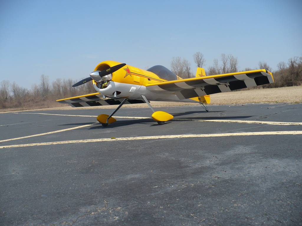

Maiden flight was successful if not a little scary. Just got it up and started trimming (1 click up / 1 click r-aileron)and the ignition battery failed. Geez. What's the chances.Made it on the field and landed with no problems. Changed that out and made a couple more flights and I'm starting to get comfortable with it.

Thanks. Not sure of the weight. I'm guessing somewhere in the high 26lb range. I'm taking the scale to the field today so I can get an all-up weight.
I'm thinking I'm going to have to move the engine back a little to get rid of the nose heavy condition. I stuck it out there a good ways to get maximum prop efficiency with the big round cowl. There isn't much I can move back inside the fuse. The two receiver packs don't weigh much and they are already behind the CG point. I have the throttle servo out on the end of the engine box but I hate to have to run ny-rod all the way from the back of the fuse.
Sometime this week I will get around to framaing and painting the canopy. I have been dreading that chore since I first saw the canopy. Everyone has that one something they really hate about setting up a planeand that is mine.But it's just not a Sukhoi without the band across the front.
Also you'll notice I marked it as a SU31 even though it was marketed as a Su26. The only cosmetic difference between the two was the curved vs. straight landing gear. The big difference of course was internal. The SU31 used composite material rather than an aluminumtubular structure.

Thanks! The scheme presents very well in the air and the "piano key" bottom is very visible.
I moved the engine back an inch and moved the receiver batteries back to the rear of the platform and now the CG is spot on perfect. Flies an inverted 45 deg. perfect now.

Others with more experience might not agree, but so far I have about two dozen flights on mine and it seems to excel at both disciplines. I have my CGset at about the nuetral point.
