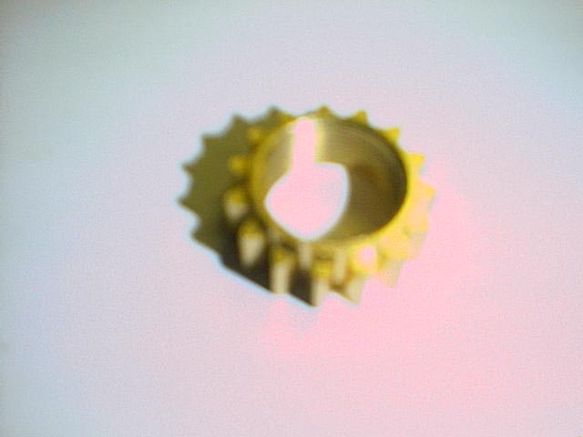

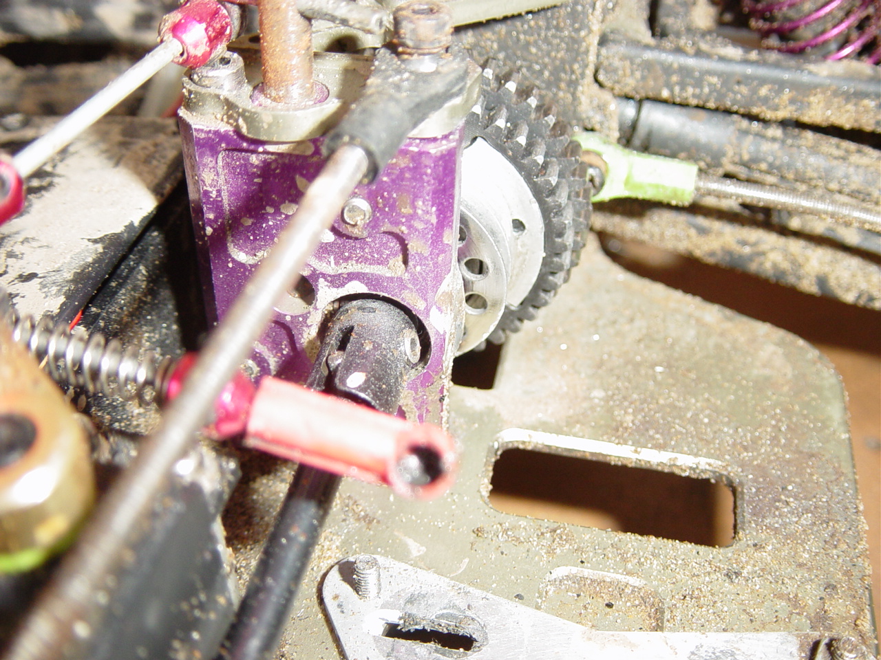

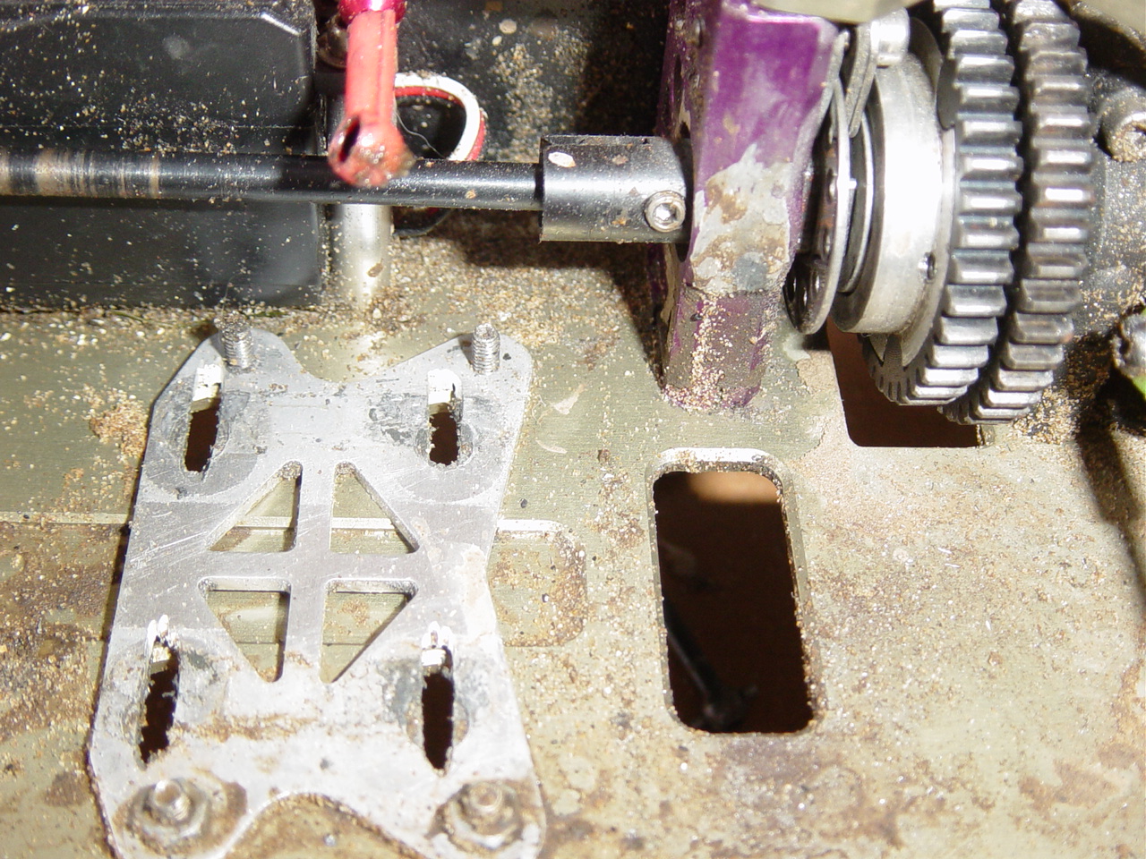

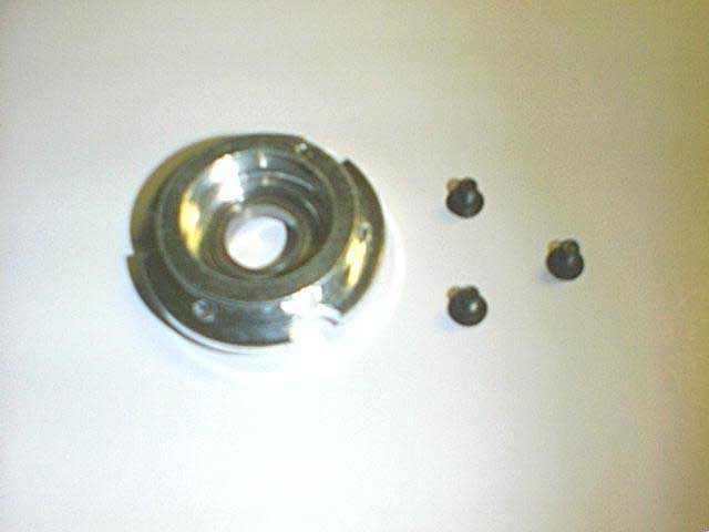

RE: new os cvr .18
the 11t has to be used with the 15t as they suit the difference in size between the 39 and 43t steel spurs - ie a difference of 4 teeth between 1st and 2nd gear, on both the spurs and pinions.
important bit: nearly forgot - due to the spurs being smaller, the engine needs to be moved closer to get a good mesh. this results in the flywheel hitting the brake seat, so a fair chunk needs to be ground off the seat. also the engine mount adjuster slots need to be extended on the engine base plate.
i have this setup in my truck, but 2nd is proving a prob as i am struggling to get the 15t gear. the truck has lost a little acceleration, and 2nd gear isnt really needed, but its just what i needed for the beach here - very long and flat...
some pics - hope that clears it all up for u

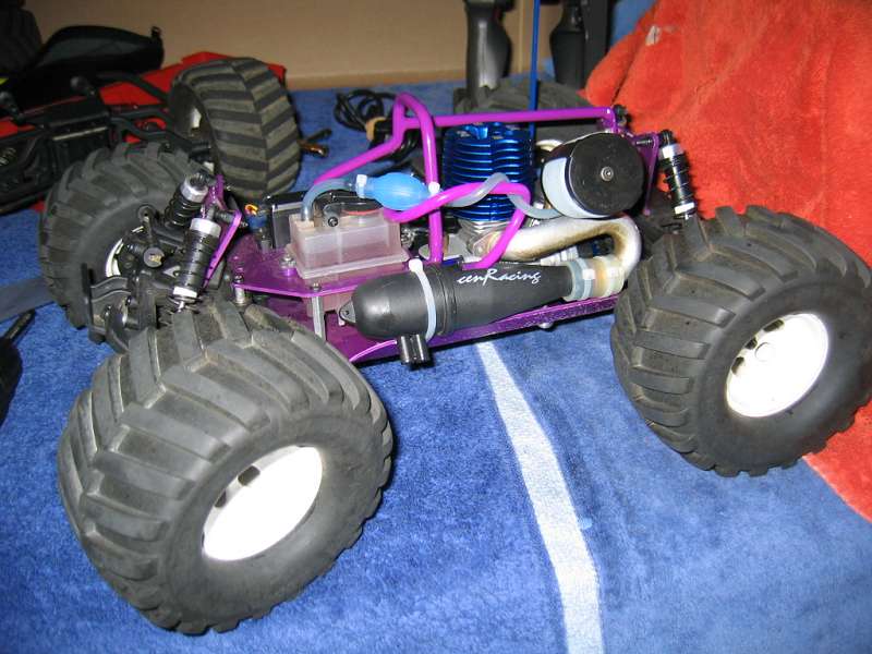

RE: new os cvr .18
what are you running the truck in... it looks like sand.... How much does that contribute to wear on the gears and other parts.. I have some sandy areas here that i can run in,but I avoid them usually... Seriously, I hope the motor fits and works in the cen chassis, but can it be driven????? its a beast with the .18....
#49
Join Date: Apr 2004
Location: Cleethorpes, UNITED KINGDOM
Posts: 2,077
RE: new os cvr .18
i run it on the beach mainly. the sand there is coarse, and doesnt do as much damage as i would have expected. true sometimes a plastic spur gear will go when its in the soft stuff, same as it would with pebbles or gravel...
