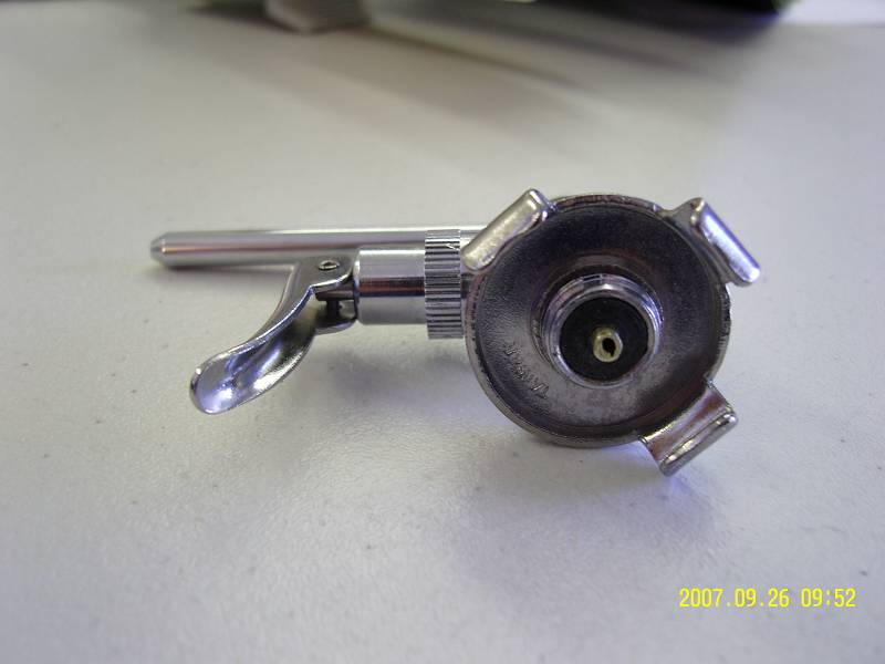

The TV-101-A is a Type I valve that has been verified as the one that does not work.
I called Peca today and they do not make a Type II valve and never have, and are in the process of discontinuing the TV-101-A.
The metal trigger valve is just to expensive compared to the plastic ones.
The TV-101-A is designed to screw on to the stem of the can and puncture it. You do not want to puncture the Colman can and the Colman can has no threads.

hi
can any one post photos of the one usher has modified showing what was done to make it worke on the powermax cans
thanks
Arden
thanks
Arden

The Peca TV-101-A can possibly be sourced at an minimum order of 1,000 valves at an approximate cost of $8.00 to $10.00 each, and the modifications would still need to be done to make them work. That is a hefty chunk of change for a limited sales market.

Countryboy,
Thanks for the comprehensive photos, I now understand why the stock valve will not work.
As they say " a picture is worth a thousand words".
jef
jef

Countryboy
THANKYOU
I have one of those valves coming and i will try to modify it i have a lathe and mill. is there a seal around the tube to keep it from leaking ? what is the size of the tube that goes into the tank,
Arden
THANKYOU
Arden

IT WORKS
I got the 101 valve today and was able to modify it and make it work it was not that bad the hardest part was removing the pucture pin which was a roll pin i broke several bits and finally got a 1/4 hole milled 3/8 in deep made a 1/4 plug with a 1/8 hole and 1/8 tube added a bit of hysoll and pressed it all together cut the brass tube to correct depth and install on can viola it squrits fuel
Arden
