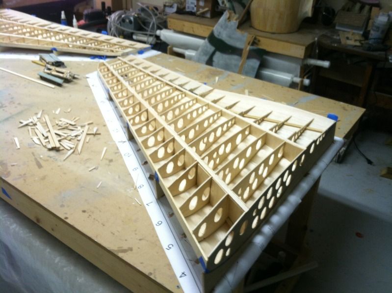

RE: 150% enlarged WingontheWeb HO-229
I got to sneak out for a little less than 2 hours after putting the little guy to bed..
So.

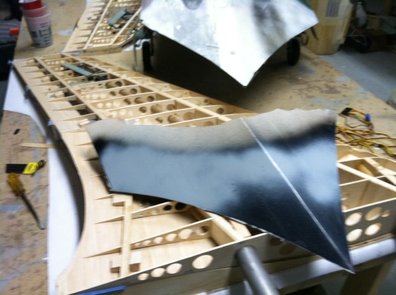

The upper drag rudder holes were cut in the top wing skins. Then the wings were placed upside down in the sheeting jigs. Then I installed the front and rear bottom wing spars. The old drag rudders were then cut free from the remnants of the old wing panels, but where left attached to the wing spars. Tomorrow I will cut them free from the wing spars and prep the pieces for installation to the new wing panels (and possibly install them). The drag rudder and elevon servo's and mounting plates were also removed from the old wing panels.
All shear webbing has been installed. The Inboard flap LE and wing TE pieces installed. The wing tube socket holes enlarged and prepped for wing tube installation. The TE wing building tabs removed and sanded to the airfoil shape.
Overall, it was a very productive night. things left to do.. Install LOTS of hinge blocks. Install servo mounts. Install and hook-up drag rudders. Make up the wing tube socket ply doublers and install the wing tube sockets. Make up and install the servo conduit tubes. Sheet the wings, Install and shape the LE and wingtip block. Cut the flaps and elevons free and Cap their LE's. Install the hinge extensions.. Glass everything, and then off to paint and detailing! That's not much at all. haha
Drag rudders were cut free from the old wing spars, cleaned up and installed into the new wing panels. They are tack glued for now. Once the lil one goes to bed, ill epoxy the drag rudders in permanently and get to work on the rest of the stuff left.

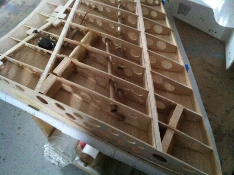

Tonights progress..
Drag rudder mechanism permanently installed. (see pictures in previous post, its just epoxied in place now).

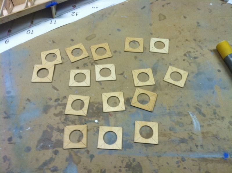

ALL of the Hinge blocking is done! I think this process alone took about 4 days the first time i did them. Its amazing how quickly it goes once you know what your doing. lol
All of the wing tube socket ply doublers have been cut out and the holes for the sockets to fit, as the holes are only 1 1/2" right now, which is a perfect fit for the wing tube.
At this pace, I can have the wings completed and ready to glass by monday. The problem is, I am still waiting on my wing tube sockets and wood order to ship (hopefully they ship tomorrow), but i don't expect my luck to be that good.
So tomorrow, the plan is to install the servo mounts, servo extension conduits, sand the hinge blocks down to the correct shape and height with all the wing ribs. If there is time left, i'll start cutting the wing tip parts out. I'm also going to use the old wingtips to pull some clear wingtip lenses for the nav lights.

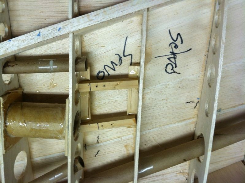

Day 6's progress..

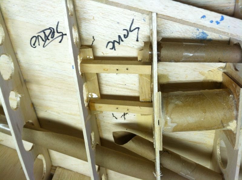

Elevon and drag rudder servo mount plate is installed in both wing panels. The drag rudders are getting an upgraded linkage using ball-links instead of my music wire Z-bend setup in the previous wings. The previous setup had a good bit of slop in its linkages which made for some less than accurate drag rudder extension, the ball link setup should fix that problem and make it easier to maintain as well.
All servo extension conduits are installed.
inboard flap servo's and mounts installed
All hinge and control arm blocking has been cut down and sanded to the correct height and shape as the surrounding wing structure.
The trailing edge has been sanded down to follow the taper of the bottom of the wing ribs. Right now I am debating on adding a piece of 1/64" ply along the TE between the wing sheetings to help prevent hangar rash. I really prefer to, but at the same time, any additional weight behind the CG has a very significant effect.

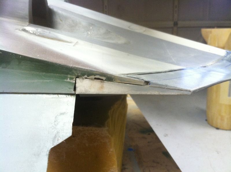

I'm to exhausted today to do much, so i spent 20-30 minutes doing this...
Popped the new bat tail out of the mold:
Then cut off the damaged portion of the original bat tail and trimmed the new one to fit with about a 1" overlap all around.. I'll mark the overlaping area tomorrow and sand off the paint. Since this isn't really a structural part, to attach it will involve some medium or thin CA along the overlapped portion, and then the root rib sections will be epoxied in place with some thickened epoxy. So by Wed. i should be able to flight metal the exhaust area and paint the repaired area.

The new piece overlaps on top of the old piece. The ends are cutcto key together due to how the damage was on the bottom skin (ill get a picture later). The new skin is roughly .010" thick, so it will be sanded to a slight taper to make it paper thin on its LE, and the original will ne sanded to a taper as well in the opposite direction. If done correctly, body fillershould be minimal and any added weiggt from the repair should be very low.
A little bit of work done today.. i'm getting annoyed with my wood order still not being shipped since its been over a week since I placed the order.
Anyways,
The new bat tail is installed by sanding off the paint from the center section where the new molding overlaps the old. Then the overlapping edge of the new molding is sanded down to a paper thin taper, so as little body filler as possible is needed.
Then thin CA is placed along the joint and allowed to wick between the two parts, securing the new bat tail molding to the center section. The following photo's show the overlapping joint. The center section is now ready for body work and the root rib to be epoxied in place.

Then applied some glazing putty to blend in the mew bat tail to the center section:
Then the bottom of the sings were sheeted:
Then they were removed from the sheetig jigs.
The right wing panel then had the sheeting sanded flush with the root and tip ribs. Then the 1/4" leading edge stock was installed and rough shaped. The wingtip was then installed and sanded to shape. And then the trailing edge was cut and sanded to the correct shape. Hatch locations for the servos were drawn on place as well. This wing is ready to have its leading edge shaped, elevons and flaps cut off and capped and the elevon hinge extensions installed. Hopefully this will all get done tomorrow as well as glassing the bottom surfaces.
The left wing panel is ready for everything that has been done to the right wing to be accomplished.
